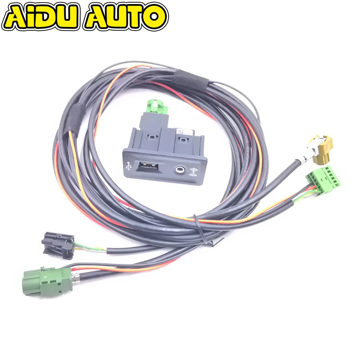

Now my car doesn’t have a USB port! For me to get the full link CarPlay system working, I need to retrofit a USB port in.
Any guidance on how to do this? I can’t find anything anywhere! I know I need to buy part number 5G0035222E, including the wiring loom. Well I assume so

Excellent work, well done. you were very lucky with the cost of the screen and MIB2 unit! I know the USB ports are wired into the back of the MIB but can't remember where offhand. There is a wiring diagram in the workshop manuals.
