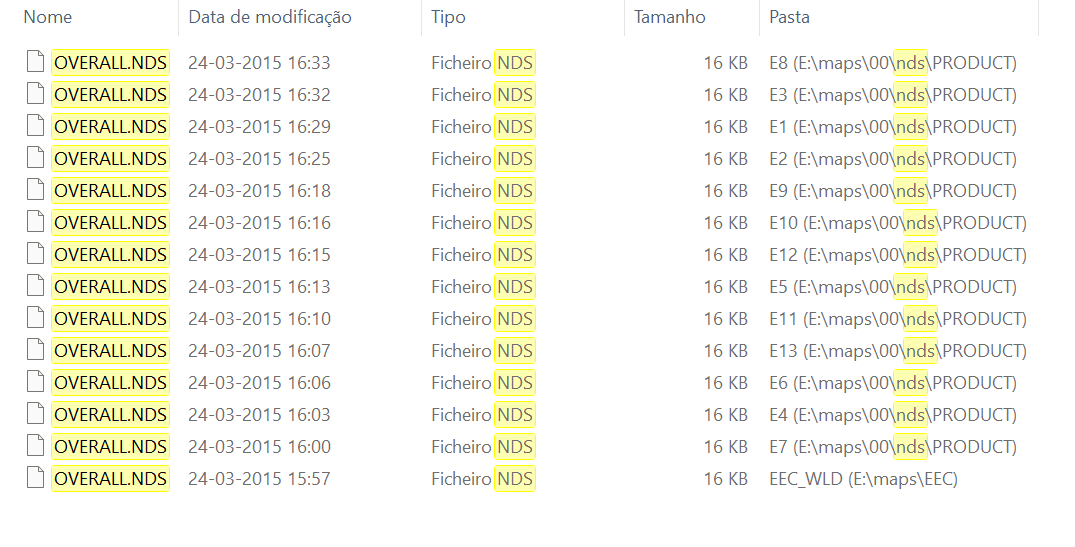

Hi.
First, let me thank you for sharing your experience.
I was searching for the OVERALL.NDS file in the the original SDCARD and found many OVERALL.NDS files in different folders.
Should I replace all the OVERALL.NDS files or a specific one?
Thanks for the help in advance.

No it's here:
Steps:
  1. Download the latest standard MIB2 maps
  2. on the infotainment go to settings, safely remove, sd1 card
  3. remove sd1 card from glove box slot
  4. long press on the on / off to reboot it a couple of times
  5. insert sd card in to computer
  6. copy and paste all contents to a directory on your computer
  7. Format the SD card keep it as fat32 and leave format settings as default in file explorer (don't forget to push the card lock mechanism to off) (ditto in a MAC or delete all from the SD card)
  8. Copy the new downloaded map version to the SD card (after unzipping it)
  9. Replace /maps/EEC/EEC_WLD/OVERALL.NDS on the SD CARD with the one from the original SD card
  10. eject the sd card (on a MAC run CleanMyDrive on the SD card - then eject)
  11. Inserted the card into the card 1 slot in glove box whilst infotainment is off
  12. power on and go to navigation
Number 9.
If you have lost your original overall.nds file this one will do
It's the year dot of the file. Use a feature of mapcare this means it will fix all release of the map card thar the infotainment unit is married up to.
Basically the car is carried to the map release that is put into the unit. Moving that file it still thinks it's married to the original file. That file doesn't need to be original even if you use the year dot release. That is used to fix updates where people get carried away and don't take a copy of the file for the workaround.
You do need to use a VAG card thou, it's reads the CID. It's how they keep a revenue stream going.

Hi Tell.
Thanks for the very fast reply.
I just replaced the "/maps/EEC/EEC_WLD/OVERALL.NDS on the SD CARD with the one from the original SD card" as mentioned.
Thank you very much.

@Tell has just beaten me to it. Just this one needed!
"maps/EEC/EEC_WLD/OVERALL.NDS"
