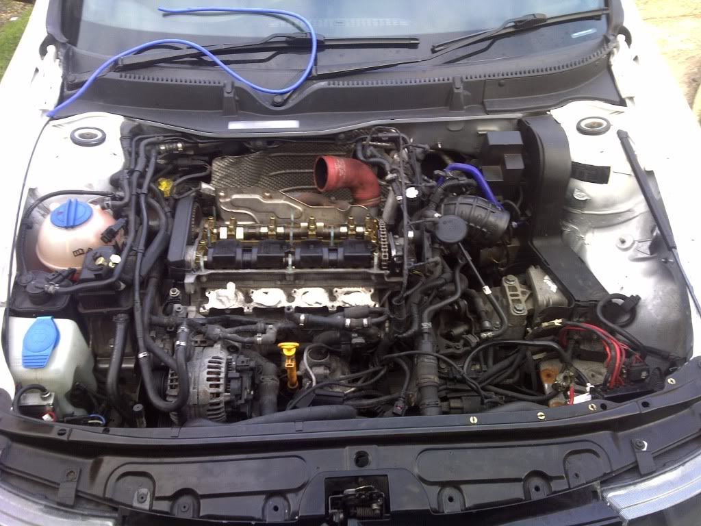

Another couple of hours on the car today...
Inlet off, fuel rail, injectors etc etc... will be tidying everythin up and running it under so its neater..
And these will be sent to get some powder coated treatment :D
