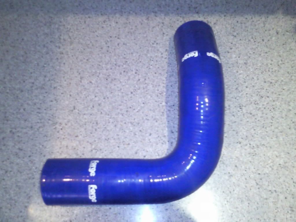

I had a look this morning and the little pipe that comes off the charge pipe is split, is there a uprated kit you can by for this or do i just order genuine pipe to replace it?
Thats the kiddie they won't sell it on it's own tho , it's the one that goes to the n75 that controls boost that's why you have none lol
Just buy a metre length of 8mm silicone in any colour you want :)
Little bit of an update, first of all as youve seen i has a boost leak so ive ordered the forge kit and waiting for that to come, in the mean time ive cable tied the pipe together and still gettin 11psi so not to bad :rolleyes: . . ive also got this to fit too. . the tires for my new wheels have been put on hold for now, but will be on shortly!

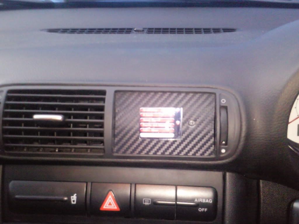

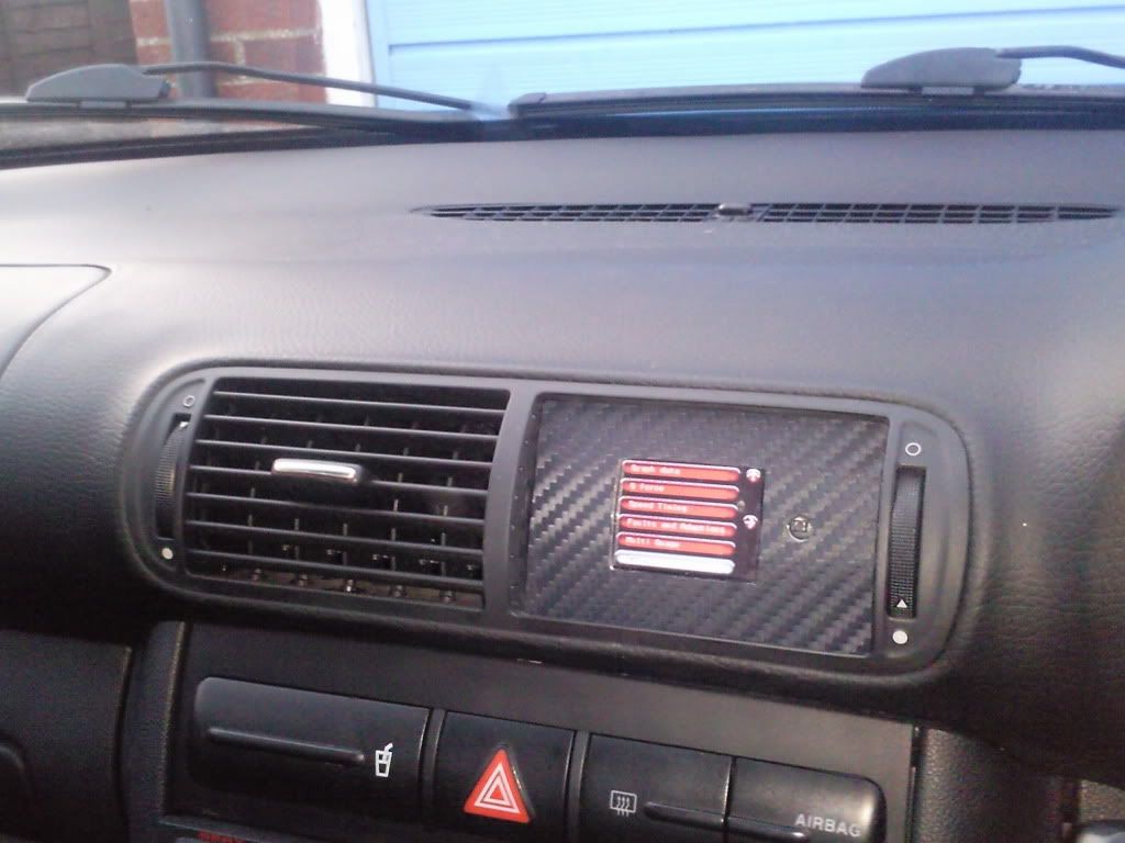

Then the fun started, sunday morning i picked up the liquid gauge, ive mounted it in the centre vent, its been custom fitted on a bit of perspex and then i wrapped it in carbon fibre film, The pictures dont do it justice but it looks way better in person, great bit of kit, HIGHLY recommended, i just cant stop playing with it :D

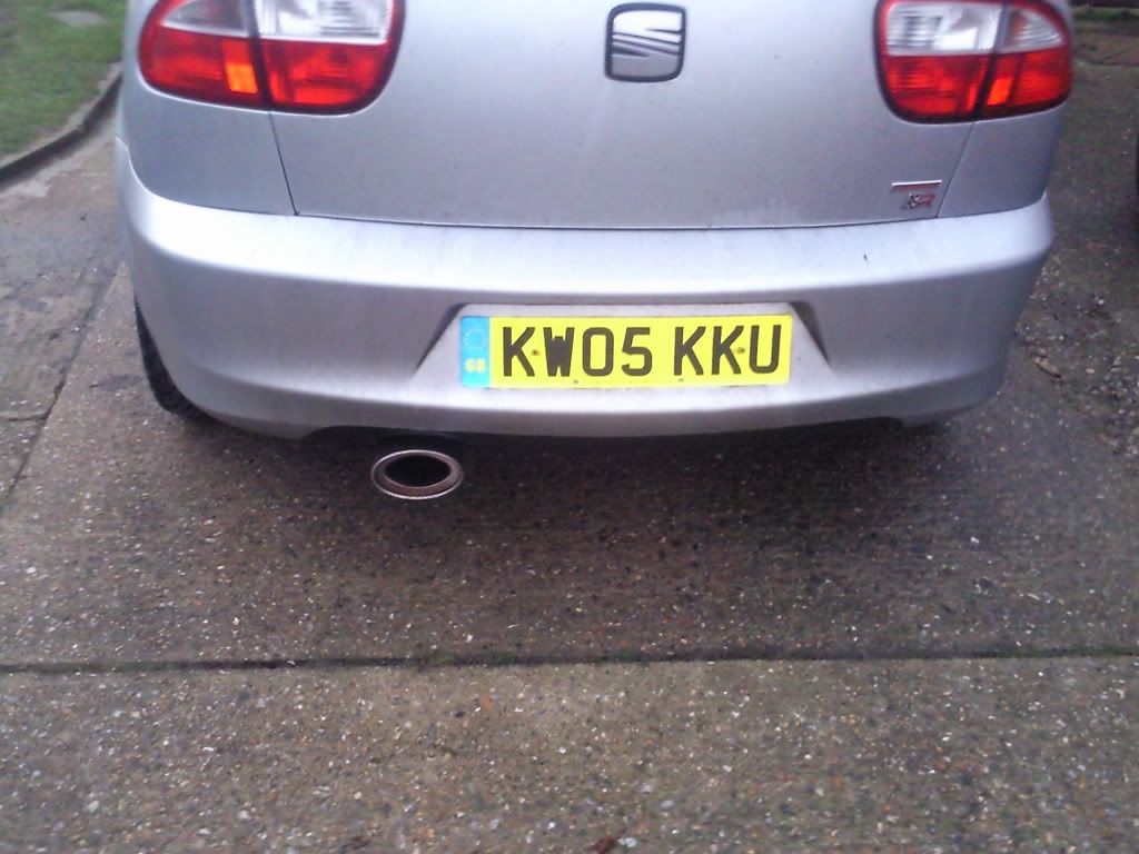

I also got a blueflame cat back system with scorpian de-cat and fitted that sunday afternoon with a mate, i just need to get my old cat off which is bein a complete bitch [:@] . . then i can whack the de-cat on :D
