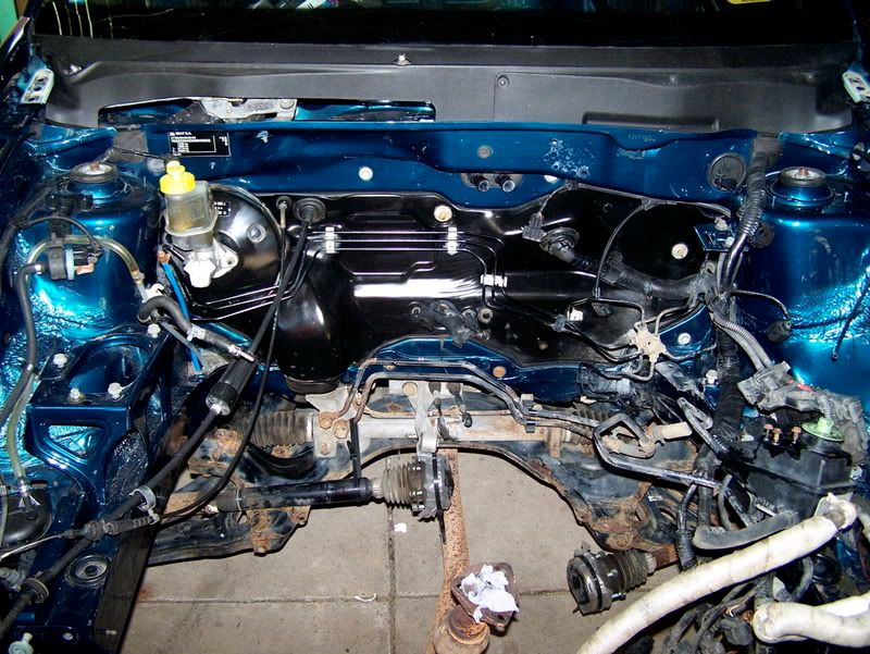

have degreased and jet washed engine bay and found badly corroded power steering pipes:( and of course according to the law of sod the perfect pipes on the donor car are a totally different pattern grrrrrrrr. and to make things worse i broke the screen on me macbook :cry:
http://i9.photobucket.com/albums/a98/grotmeister/pipes.jpg
heres a nice clean engine bay:
http://i9.photobucket.com/albums/a98/grotmeister/cleanenginebay.jpg

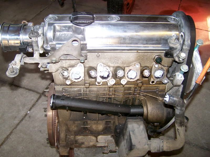

and done some cleaning on the engine:
http://i9.photobucket.com/albums/a98/grotmeister/engine.jpg

Ok decided front suspension needs to come off due to the state of the sub frame. Sub frame, steering rack and, wishbones and front suspension struts are now all off and in process of cleaning up and painting where necessary>>>> see a couple of pics
spent ages with a wire brush on an angle grinder then gave all parts 2 heavy coats of hammerite smooth. Have decided to use the steering rack and pipes off the donor car as they are in near perfect condition.
tidy up the egine bay looms should be a nice small car when done

Ah thanks Bernie, good opportunity to decarb everything while the heads off; wasn't sure what type of cam follower was in there. Have just about finished overhauling the front suspension and subframe, it all looks like new! Just got to get the sterring rack off the donor car and clean it up then I can start putting things back together. Have bought 25kg of shot blast grit for the engine block and gearbox casing, thats the next job.
