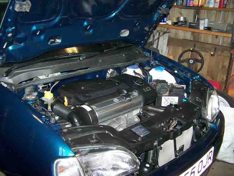

Front end of the car totally finished now (apart from front grille, haven't cleaned it up yet)
http://i9.photobucket.com/albums/a98/grotmeister/underbonnet.jpg

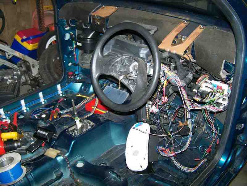

Fitted steering column from donor car yesterday. Advice on fitting a steering column on an Arosa: Don't! nightmare job.Spent a week sorting out the electrics as I wanted to fit the central locking system and electric windows off the donor car. This meant painstakingly undoing the wiring loom off the donor car as I don't have a circuit diagram at all and there's no less than 33 wires going into the central locking box. Then I had the problem of mating it to an alarm system I got off ebay. But I think I'm there now and going to start fitting the interior this weekend. Inside is bare at the moment:

Didnt make meself clear: steering column wiring was no problem, fitting the steering column itself was difficult lol. I did this because the donor car came with 2 identical keys whereas my arosa only had one key for the ignition and another for the rest fo the locks. I wanted one key to do everything and a spare to do the same. Found a very low tech way to get round the immobiliser problem lol. Anyway I took friday off work and had a very productive weekend in the garage. All electrics finished and working, alarm operates the deadlocks & electric windows work fine, interior is in and doors off the donor car are fitted. I took my baby for a drive round the field as well! All is well except that it pulls violently to the right if you let go of the wheel; tracking need setting up as I replaced the steering rack earlier. Still got some interior bits to fit. The headlinig need cleaning so I haven't put that back yet and a few trim panels. Really pleased with the interior-its like new. went to halfords today and bought a set of 5 spoke alloys and got a a new stereo off ebay. Next job then is to respray the doors. Unfortunately I've not ever done any paint spraying so looking for a book or something to get started lol. Here's me latest pics:
