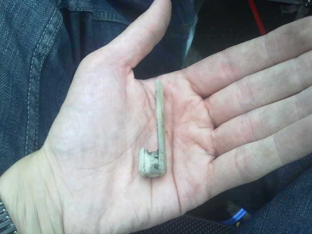

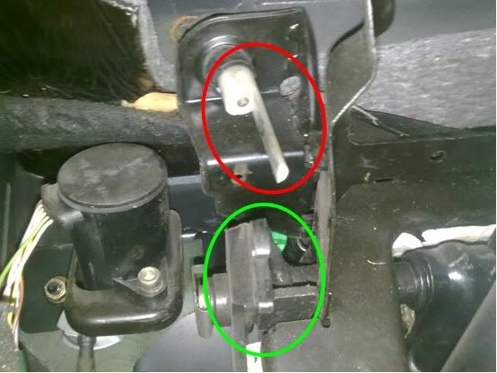

I'm no mechanic but I had a look under the steering wheel today and I think I know whats up...
This bit fell out when I took the cover off:
I think it should be part of the plastic bit (red) below, which in turn should attach to (green) which is the top of the clutch pedal...
What do you more experienced car types think??
Looks about right to me.
Is there a seat version of realoem.com for bmw's? (its E30's for me, not the modern junk) It'll show where this piece lives and the part number.
I've found Seat dealerships to be the most friendly accessable in the trade so if one is close to you they could confirm and hopefully only charge a few quid for a new part.
As we said tj. Clutch pedals gone. Looks like it may have taken the cable with it too :| new cable + weld up the pedal. Job done. Check the link in my last post :)
See you at the weekend
Ahh, true. Sorry, was looking from my phone. I see it now. Unfortunately I think it may well be a new clutch cable. Not too bad though, got a new one from WJ King for £20 IIRC. And had it fitted in 30 mins :D
Yup clutch cable it was, got it back from the mechanics today :) Wiper linkage done, passenger window done and clutch done :) And I now have an empty bank account :( and it feels weird to drive but I'm sure I'll get used to that...
