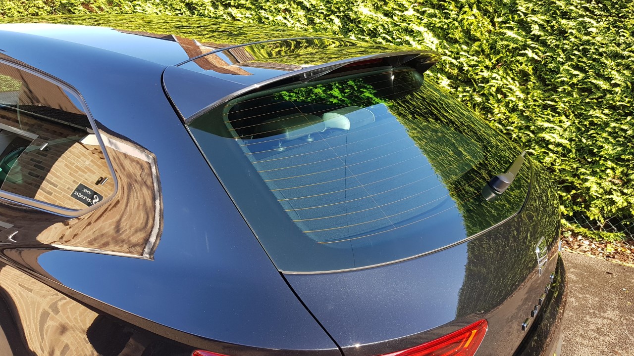

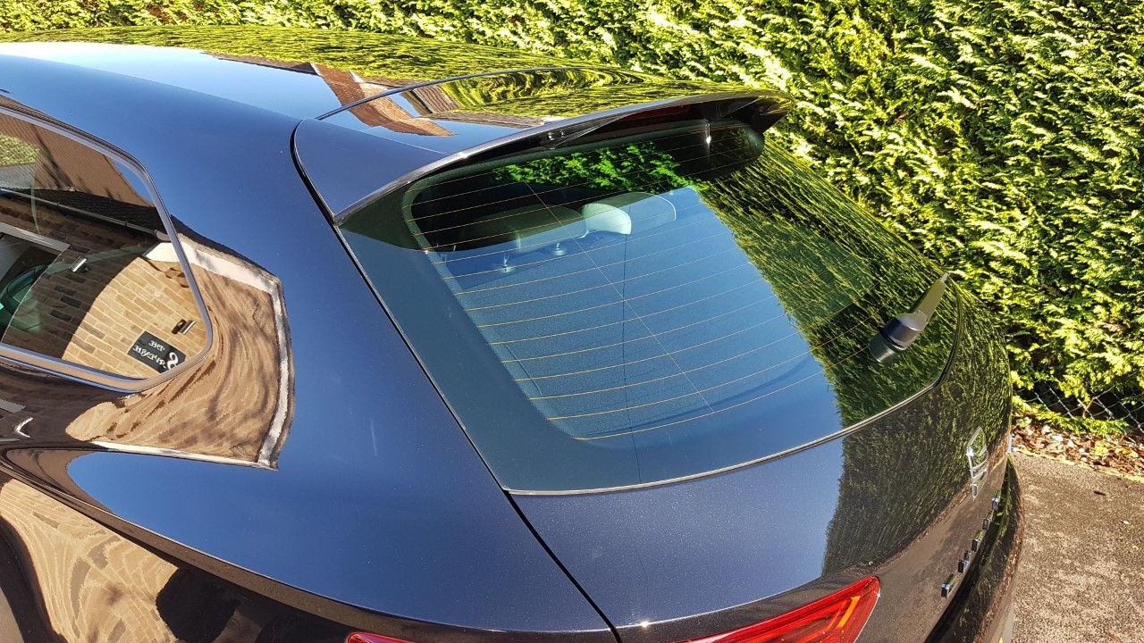

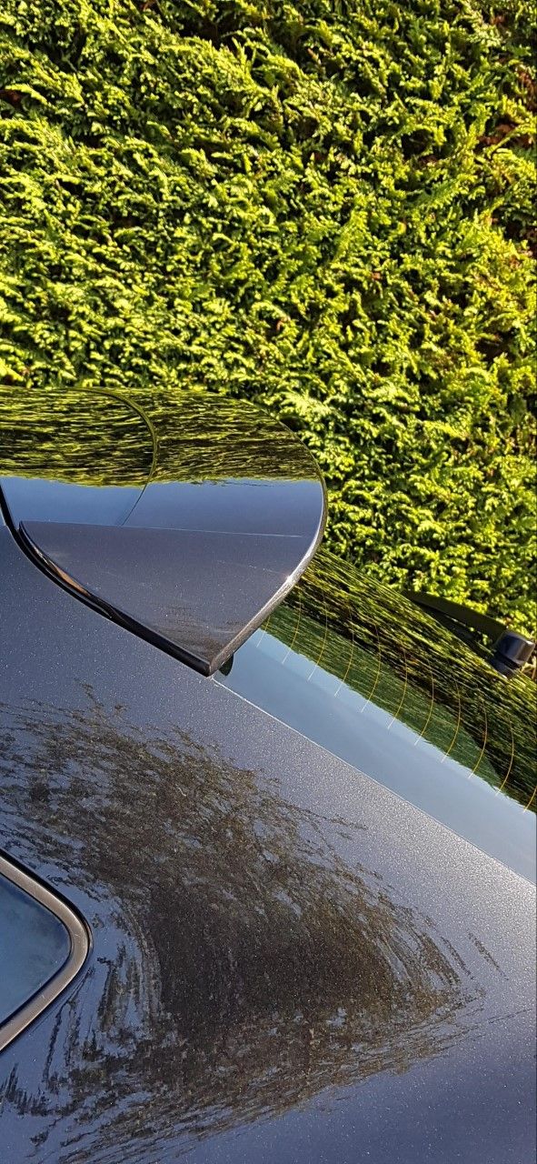

So I got my spoiler and it does fit.65 quid genuine seat and free postage.Next question is does anyone know how much I should be paying for spraying and fitting?
Anyone???
I don’t know, but probably worth getting quotes from a few body shops. If the quotes are all around the same amount, you’ll know what the going rate is. Check out any on line reviews of places that you get quotes from too.
If there’s a wide range of prices, don’t necessarily go for the cheapest as it might be cheap for a reason.

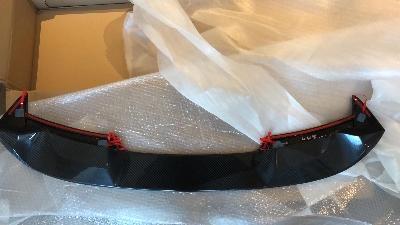

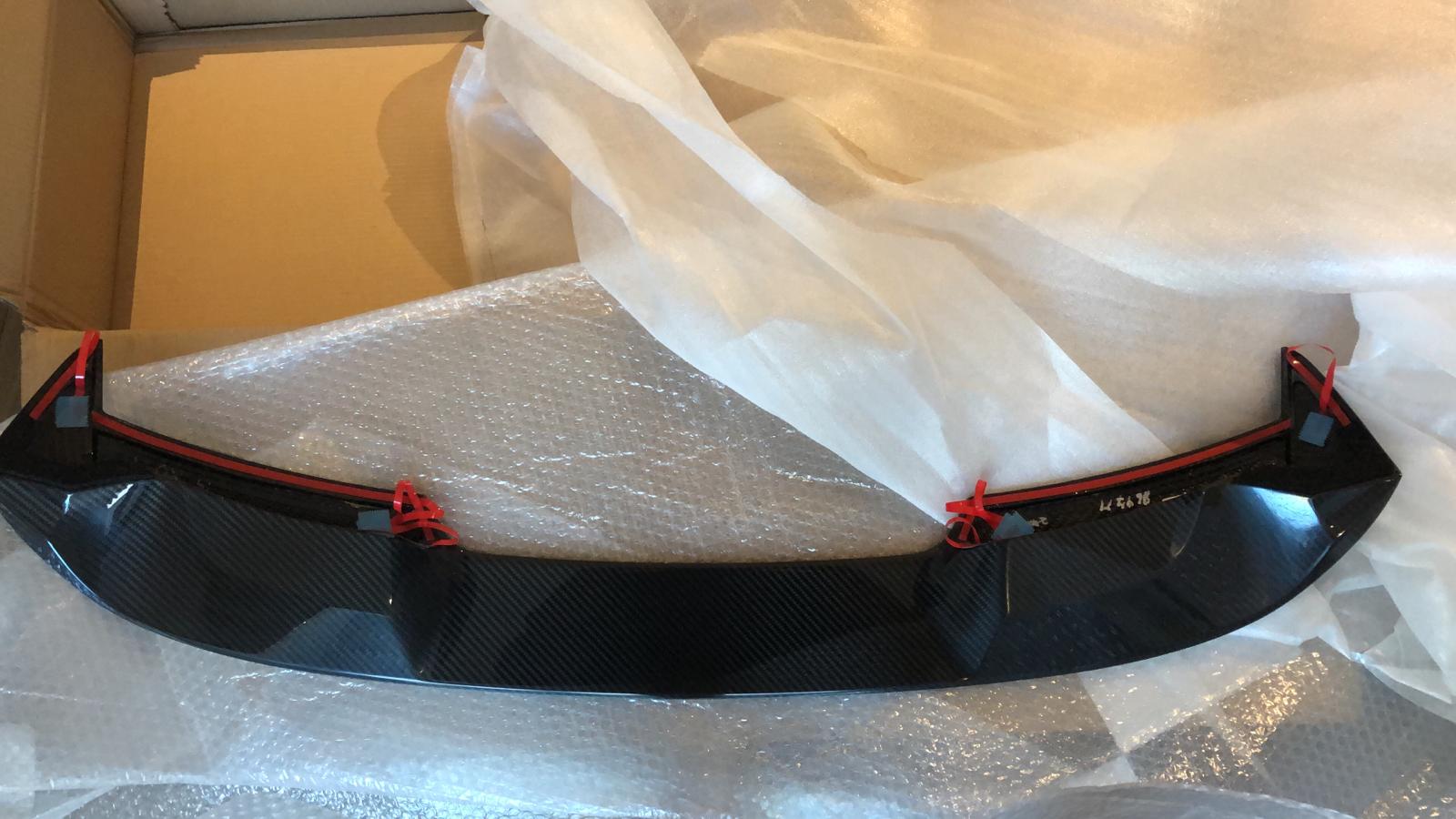

Hi all, i've got an oe carbon fiber spoiler for my cupra st 300 and i should remove the existing one from de factory to fit this one. The question is: could i remove it by myself without damaging the paint?
Not yet. Should I?
Yes the brake light is different on the Cupra as it’s built into the spoiler itself.
The Cupra R has the same brake light as the cars that don’t have spoilers or the aero spoiler.
EDIT: The brake light also has the rear washer fluid hose on as well.
Is the spoiler you have the ST R one?
Yes, the spoiler is for ST R - 5F4071641
And for the brake light i think i found the part no: 5F0945097D
I still have doughts if the paint will be damaged or not when removing the standard cupra spoiler.
If your happy to destroy the old spoiler just give it the old heat gun treatment should soften the glue enough to pull off.
OR
How I would do it and SEAT recommends is to cut through the glue with cheese wire. Then remove excess.
I got the spoiler and the tail brakelight.
Before starting the swap, i am not sure if the conectors for the brake light are the same. In etka it seems a bit different. Is it plug&play or should i buy more parts?
