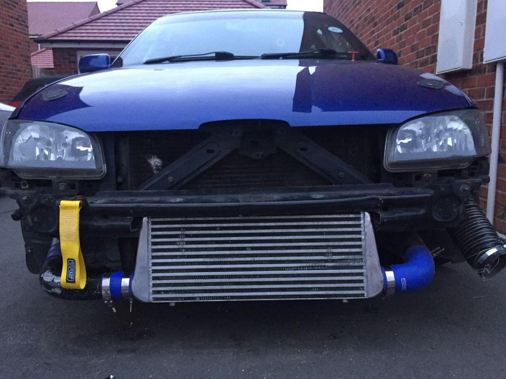

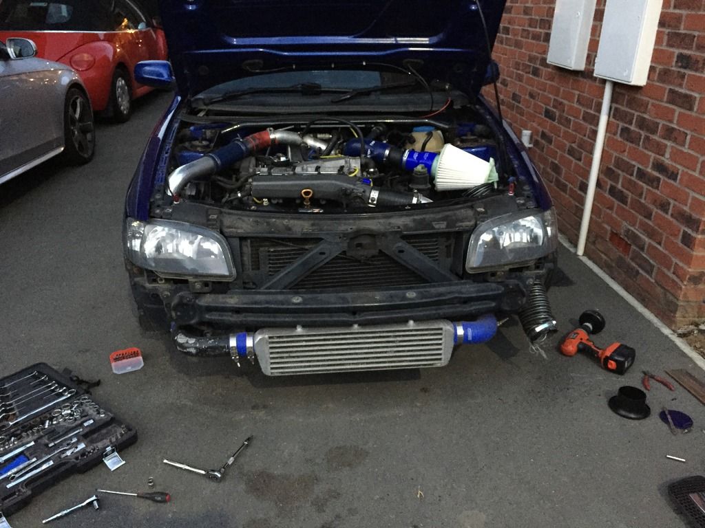

I was annoyed with how my older FMIC was installed and it was also pretty small.

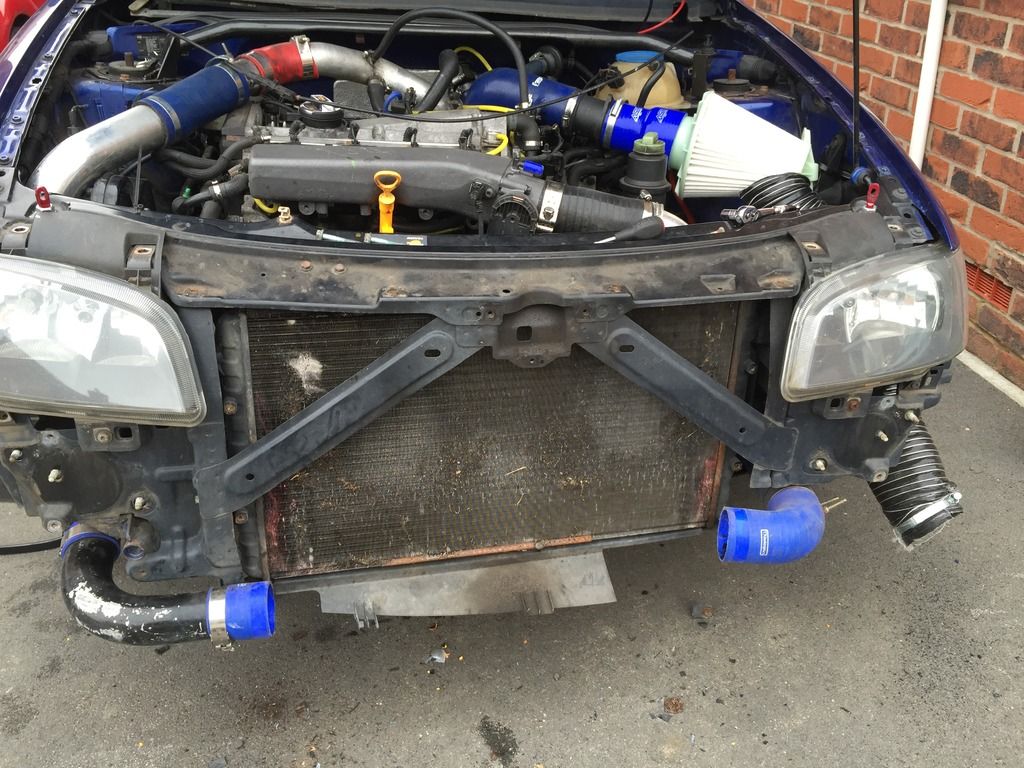

So I set about removing the old one

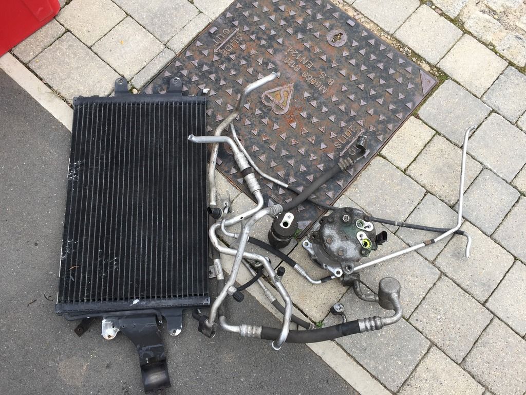

While I was there I thought I'd better remove the rest of the AC parts I'd not go round to doing yet...

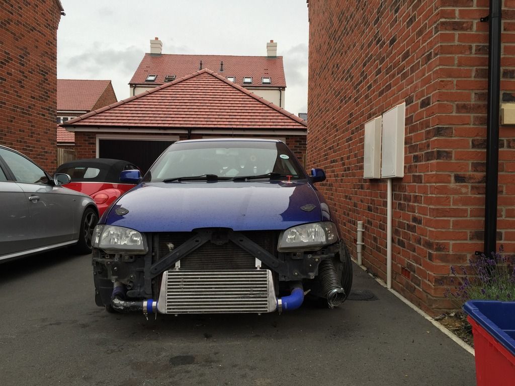

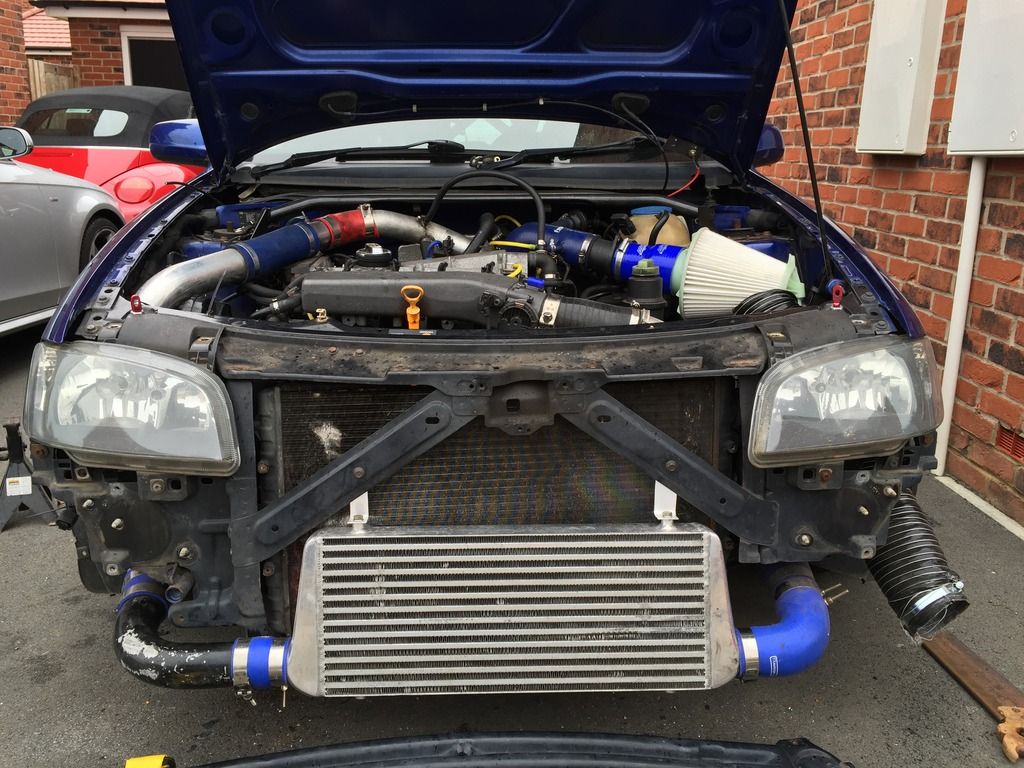

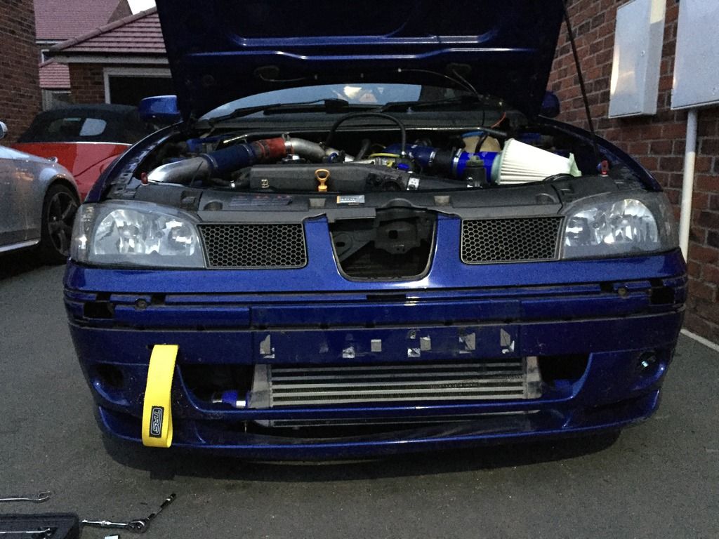

new intercooler fitted
Crash bar modified to fit & MSA tow strap fitted
Bumper back on

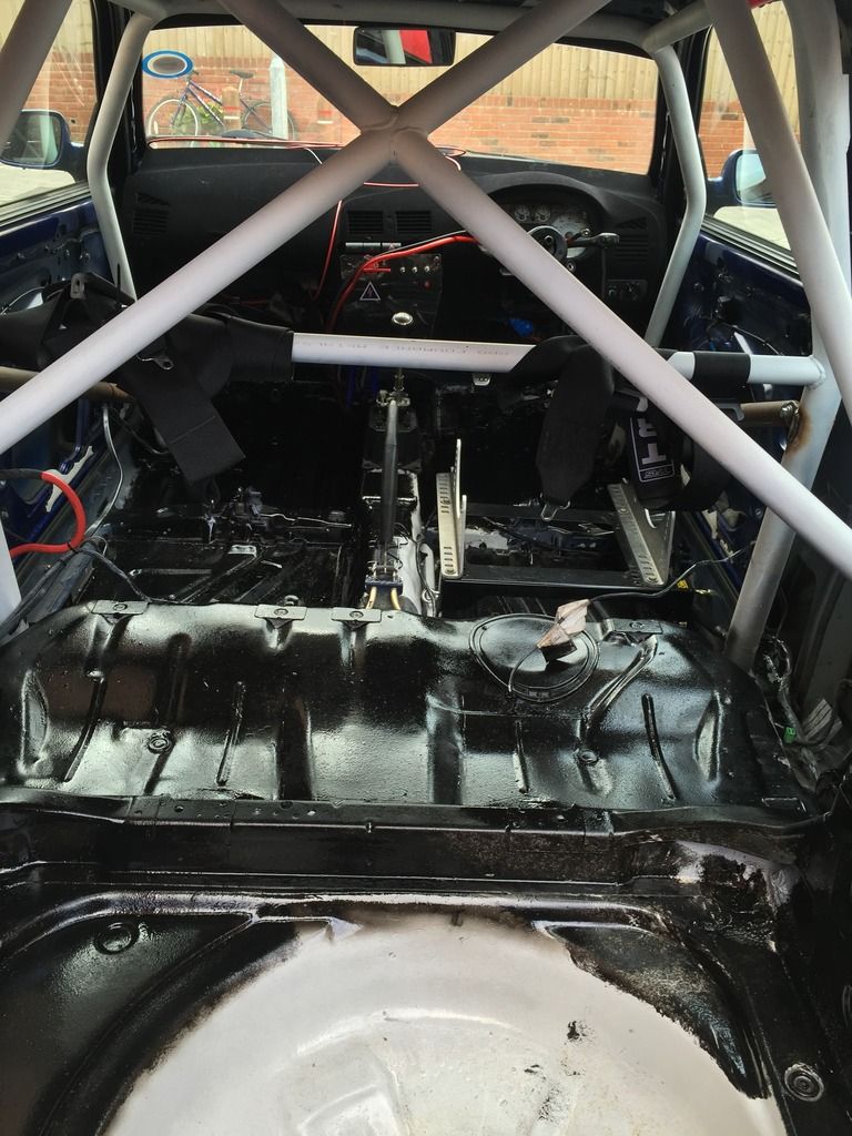

Next I decided I didn't like the white interior any more as it was always look dirty..
Easy fix.. Paint it black!

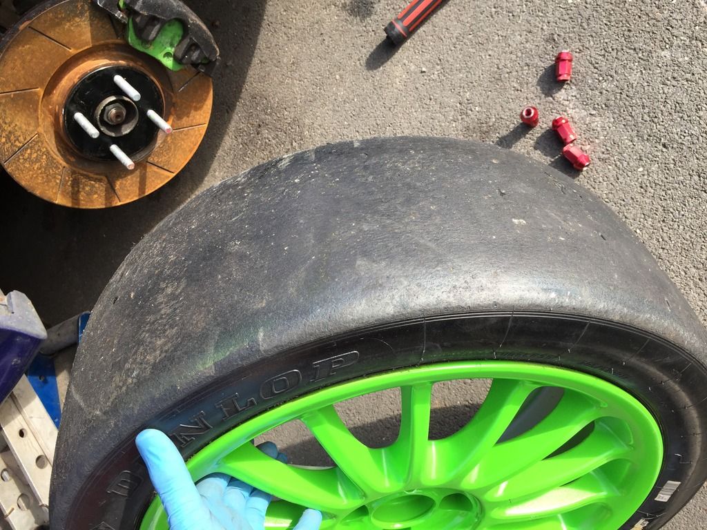

Then I picked up a set of wheels & slicks..
Test fit after modifying the wheel centre bore
Fit nicely so happy with that!

Is that crash bar strong enough to take the load of towing? I've only ever seen them mounted on the towing eye thread.
What sprint rates are you changing to for using slicks?
Should be. I've moved it from where it is in the picture.. Now right next to the tow eye thread.. Couldn't think of a way to use the original thread.
Will be running the car in the CBT VW Classics dude. New championship for this year, looks really good and some good cars / drivers in it.
I got a left hand thread bolt for mine, maybe one to watch for.
Nice one! Just had a quick squint at the regs, you must be pretty close to the bhp/ton limit?
Ah cool. Do you know what size it was?? I'll get one.. I thought of doing that but was told they're a custom thread.
Yeah, pretty much bang on the reg limit HP so should be competitive ;)
I'm not sure, I can't remember where i even got/found the bolt. I guess you could make one out of an old tow hook and weld a big hex head onto it, might work.
Perfect, will have to run ballast if you up the power?
Yeah that's what I was thinking about doing before.. Will have a dig around in the garage for the old tow eye..
Shouldn't have to run ballast. I'll know once I've had it power tested and weighed
