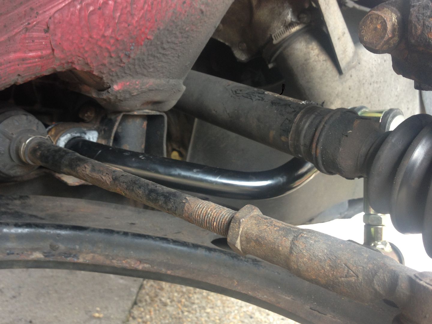

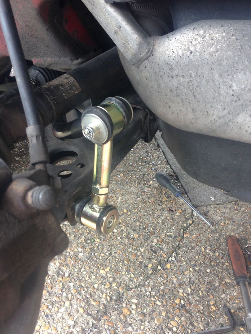

I fitted a golf R32 front anti roll bar with adjustable drop links today. Runs under the driveshaft instead of over so no more driveshaft/anti rollbar issues for me. Used the adjustable drop links to attach it to the wishbones like so
