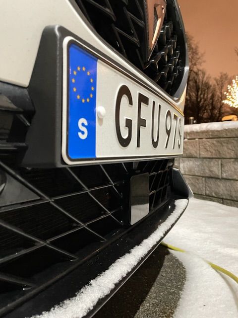

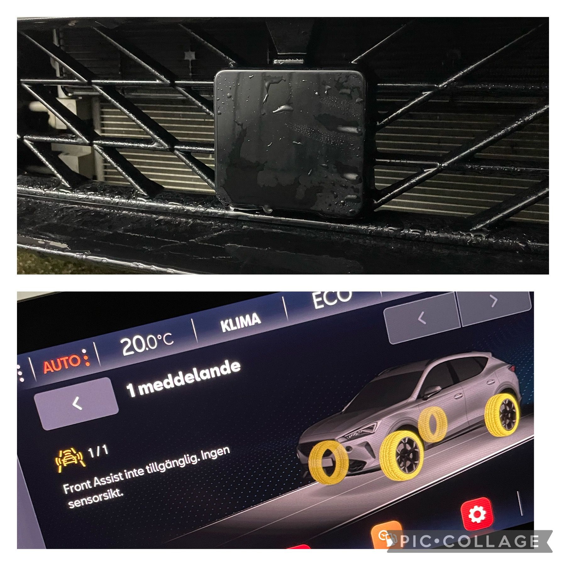

3. The front sensor stops working as soon as it rains or gets a little dirt on it. Then the cruise control or anything else to do with the front does not work.

3: Mine did this a lot, but mostly it's gone now, after I had the thick license plate holder removed since it interferes. Might even be related to item 7?

3: In Sweden we have a little smaler license plate then in UK. So I dont think that is the issue here.

3: We have the same in Denmark compared to Sweden, I think. And mine was an issue. Can't quite tell from your picture but if the license plate is mounted in an extra smaller frame it could be an issue.

3. Oh I think so too. And as far I can see is that the license plate cannot interfere with the sensor.
it is mounted on the original plate holder that are one with the bumper?

Ah yes, that's good! Nothing to improve there. Mine was in a bracket screwed into the original plate holder.

I cleaned my front sensor; the area with the camera on the windscreen and the front bumper sensors with a couple of glass cleaning wipes and I’ve had no random alerts or issues since.
