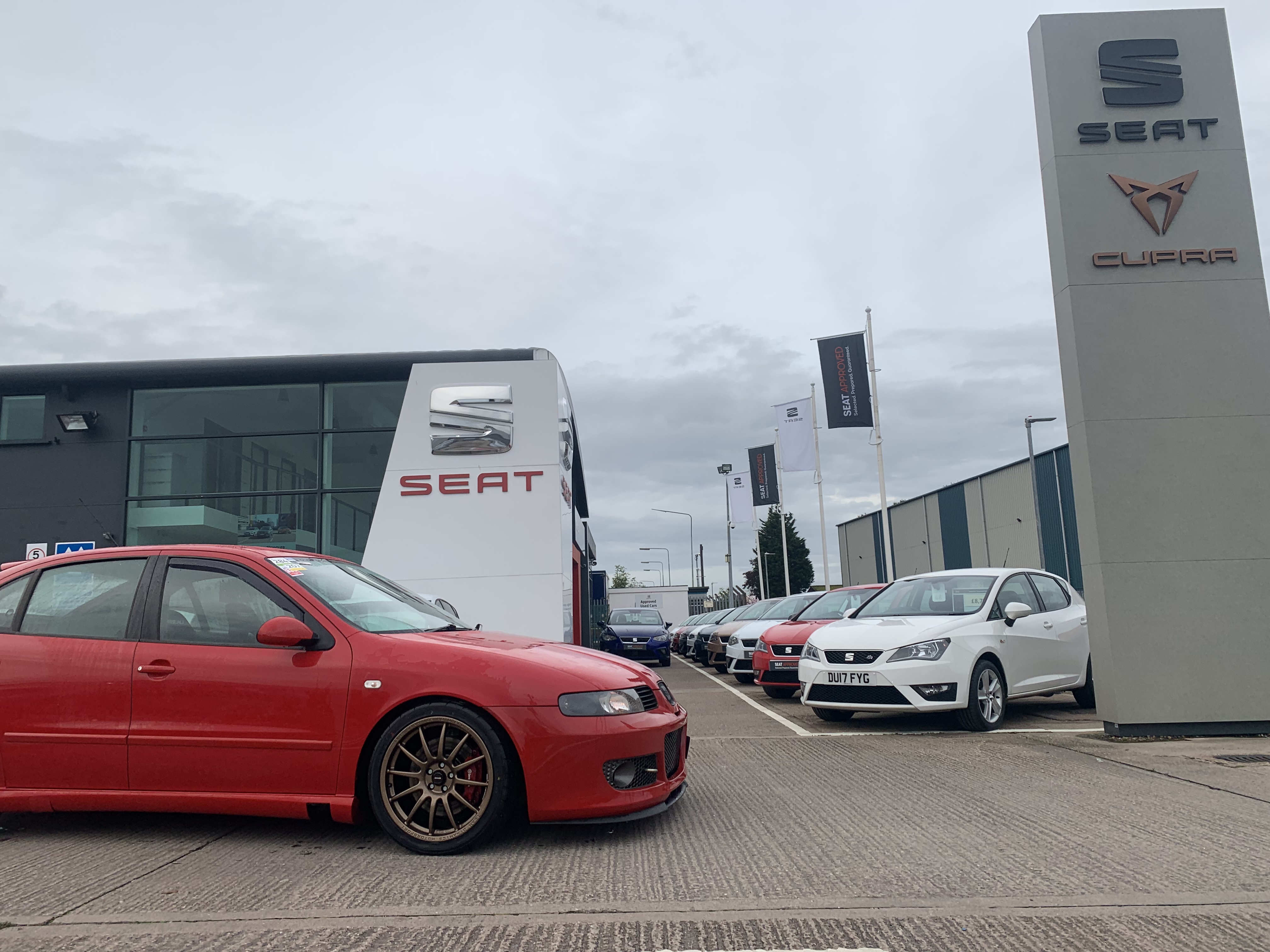

Hello all,
oh and its my first post :)
No. I've not spent £270K on a mk1 leon lol........
Thought i would share that my MK1 FR PD150 that's done a few miles:happy: 272038 and counting. since 2009 just popped over to the moon and on the way home now;)
as per forum rules this is not an advert just a reminder and how good these cars are and what you may go through if owning one and some guidance if it helps but a few then great. Otherwise maybe search the forums :)
just done a lot of mileage touring the country this is what driving does from a maintenance perspective :-D

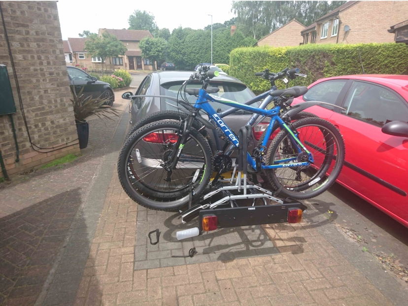

oh i have a towbar which comes in handy
