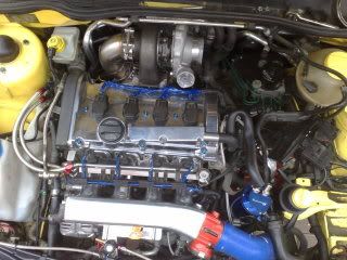

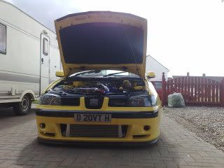

started life as a realy looked after clean standard cupra then i got my fingers on it to try and make it 1 off! first thing i done was a brand new k03s and a map which took it to around 235hp then got tired of that quite quick so i got a k04 -01 turbo same internals as lcr and tt 225hp then mapped it again to achieve and extra 50hp bit pointless but it was a trial and error for me so then i bit the bullet and got a gt28rs got that up and running and acheived 348hp also takin it to a 1.9 then started to do a bit more modifyin on the out side then winter arrived last year and funds where high so i decided to take it another step further my m8 blew his turbo so i sold him my gt28rs and purchased at gt3071r as i wanted to get over the 400+ bhp mark just something ive always wanted to do dont ask i should of done it in the first place but u learn by mistakes well i do lol heres a little list of the spec
garrett gt3071r 60a/r 3inch v band
tial 44mm external waste gate with (SCREAMER PIPE)
full 3'' custom stainless exhaust with twin 2 1/4 exit made my self
custom manifold made by my self 40mm stainless t304 with t3 flange all tig welded
dta managment
550cc rc injectors
inovate wideband
rear antiroll bar
s3 maf
s3 fuel pump
walbro 255 inline pump
hks supersquencial blow off valve (adjustable)
5bar pressure reg
ported and polished head
oversized weisco pistons taking it to 1.9
arrow h rods
arp head stud kit
arp rod bolts
lightned and balanced crank
baffled sump
g60 lightned fly wheel
excedy stg 4 vr6 clutch
fully rebuilt gear box all powdercoated with quiffe lsd tt 180hp top shiffter from a btcc seat technition.
b&m short shiffter gear stick
vibratechnics mounts
all bushes replaced with polybushes

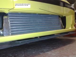

universal front mount intercooler flow rated 480hp
2''3/4 sfs boost hoses

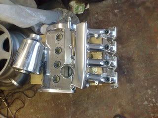

polished rocker cover
polished inlet mani
polished green cotton dyna twist airfilter
polished boost pipes
porsche d90 rims 7.5'' fronts and 9'' rears with stretched toyo t1rs
porsche carrera 4s brand new front brembo calipers with custom 332mm disks ferado ds2500 pads
rear brakes audi tt 225 calipers and custom discs
wizard of nos nitrous kit with progressive controler
cobra bucket seats for now
luke 3 point custom colour coded harness's

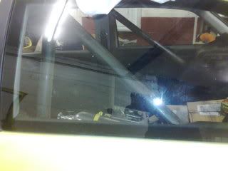

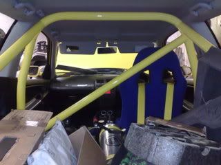

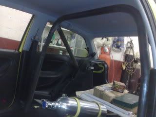

4 point custom roll cage also colour coded made it my self out of stainless t304 2'' tubing
also custom rear strutbrace colour coded
fk highsport coilovers
HID KIT 8000k

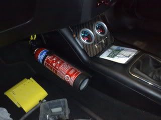

auto gauge boost,oil temp,oil press,exhaust temp
LED nitrous and water spray switches to go with the dash lights
loads more mods to come all work done by my self including i give the car a full respray and adding a few of my own touches ie custom front bumper gloss black bump strips mirror base plates wheels loads more the only work being done will b the mapper everythink else was me well i thought i should post some pics up as a few people have asked
