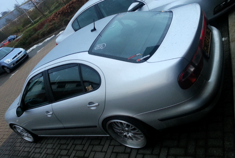

Here you go Damo, I managed to get you a pic today of the roof.
Haha, no copyright on it at all Damo :D feel free to copy it if you should wish. Most people don't notice it at first, but when they do they do like it.
Joshy - It's the standard Seat Satnav aerial base that came from factory, truth be told mine isn't looking so good these days so could do with a new one as well :(
