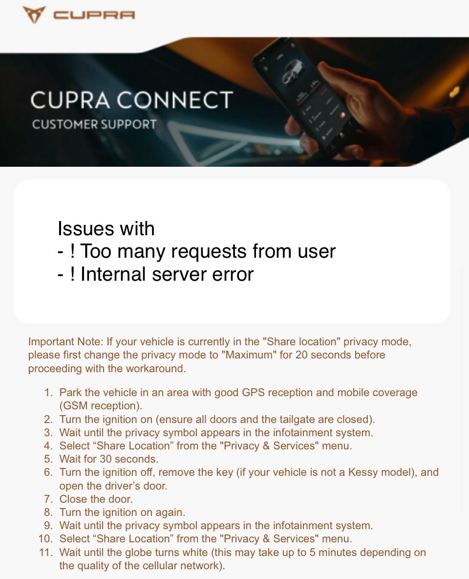

Hi,
MyCupra app is not working, i get always Too many requests from user error. Car Formentor 2022 is connected and privacy is correct. Hwt i did so far:
re-installed the app on my smartphone, logged out and logged in the car and the app.
any idea or help please.
Thanks

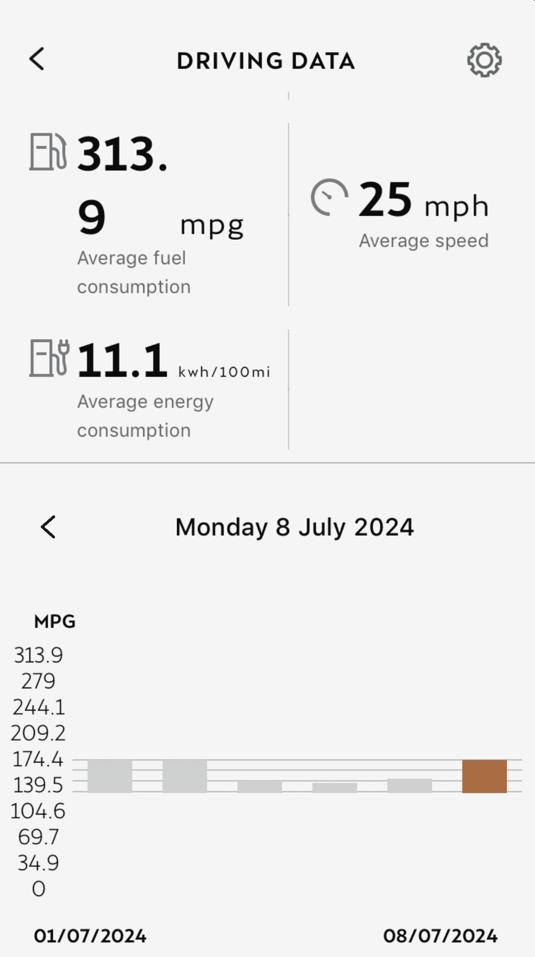

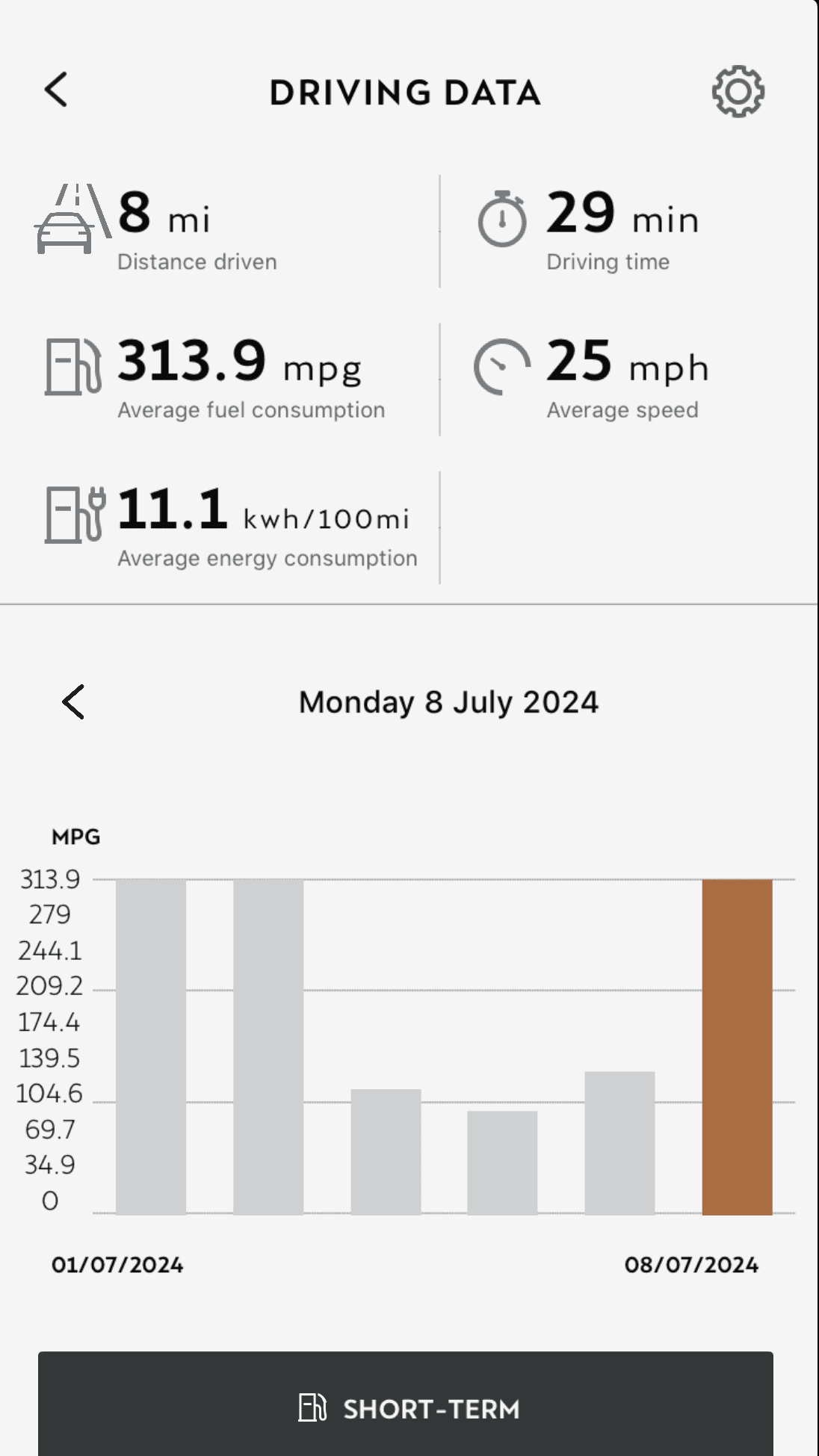

Have worked out what the five year old failed to do - to take into account Dynamic Text Sizing on the iPhone, so if you make the text larger than default the Driving Data page can't handle the larger font size , lines fall off the screen and the chart fails to scale correctly.

Screen shots
As it is with text size increased, note the top row (distance and time) missing, data select button at bottom missing, graph scale wrong.
As it should be (with text size set to nominal). In addition: Where's the end time of the trip as per previous app? Why does it show 313.9 mpg when car and previous app always shows 300mpg for an EV only trip?

I have had similar problems with the My Cupra app. Cupra Connect customer support sent me this info. It has worked for me ??

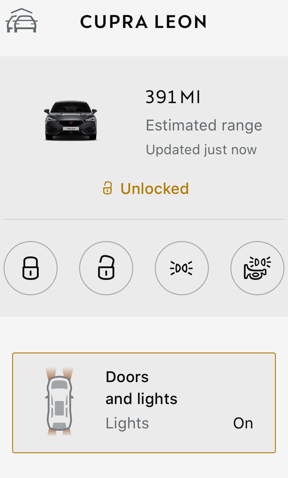

How do you tell that the car is locked in the new app? Lock and unlock works, but the old app reported lock status - can't see it on the new app.
The new app shows the car unlocked. I guess when it’s locked, there’s nothing to report.
