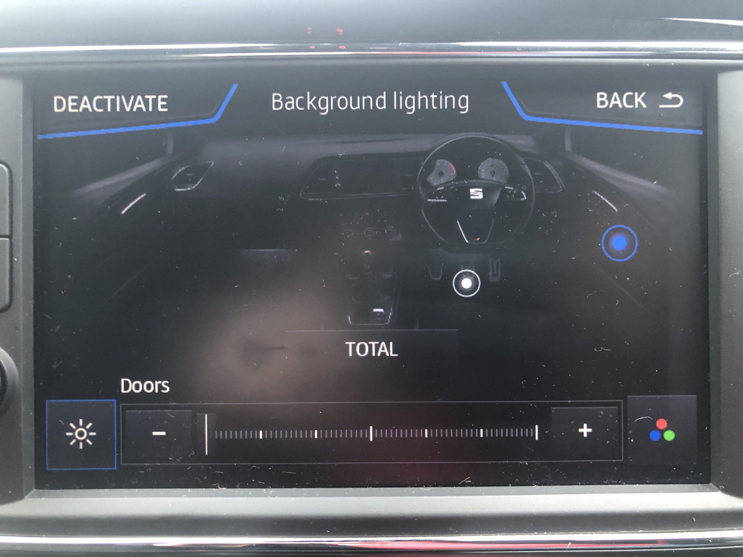

Just to ask if the ambient door lighting is standard?
I know I seems small thing but having it adds to the wow factor. I have a 520d m sport and it adds a massive element to interior design.
Got him down to £8750. Unless there’s something I’m not happy with all agree that price. Hope to pick it up this week, didn’t want to risk money transfer not going through due to weekend.
I’ve ask him about ambient light and he doesn’t see any, pretty sure these were standard as I’ve checked the catalogue for that year????? Or can they be switched off?
There should be footwell lighting and ambient lighting in the doors on the FR.
@Woody_72 On the pre-FL models the ambient lighting strips change between white and red (sport driver mode selected) - the brightness is adjusted via the interior light settings if low or set to white they are very hard to see during daylight.
On the FL:
If you go to the infotainment screen there are a couple of places to look - my Cupra has the multi-coloured background lighting so may be slightly different on FR:
Vehicle >> Settings >> Light >> Interior Lighting
(This changes the light level/brightness on the switches, instruments on dash, infotainment screen)
Vehicle >> Settings >> Background Lighting
(This controls the colour, brightness of the footwell lighting and the door cards). Total sets both levels together or you can select one area (for different levels in each). You can also deactivate.
Screen looks like this:
On the FL:
