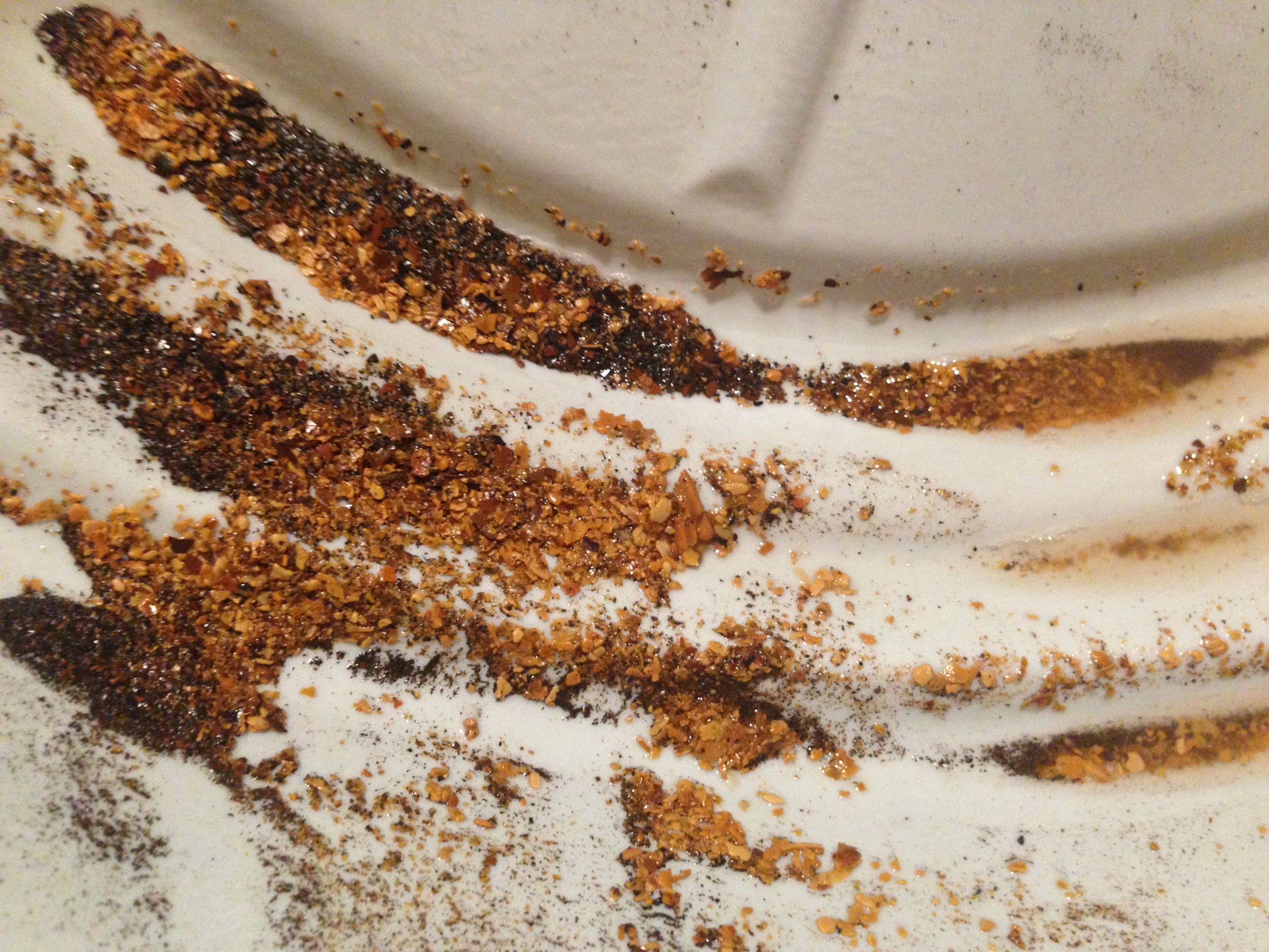

Brian Cheers pal, im hoping it is just an air lock, well crossing my fingers on it, the garage that replaced my matrix did flush out the system, but my blockage wasn't due to the silica bag, it was down to limescale/ what I thought looked like rust when he showed me the old matrix, he could only reckon that the previous owner hadn't used coolant but most likely water instead!! So I dread to think what else is buggered. I'm pretty sure he removed the silica bag for me aswell as he does that for his vag customers.
Just so you know, the `rust` is probably a combination of gunk and casting sand from the engine block. Another known issue that blocks the matrix. When I unsuccessfully flushed mine out, loads came out. Othe people have posted photos of much the same (this is not my photo)
As the matrix cooling system is so small (I got about 500ml out of mine when I changed matrix), the majority of coolant is in the radiator circuit. As I have my cambelt/pump/thermostat (+housing) changed, I got my mechanic to ditch as much coolant as he could.

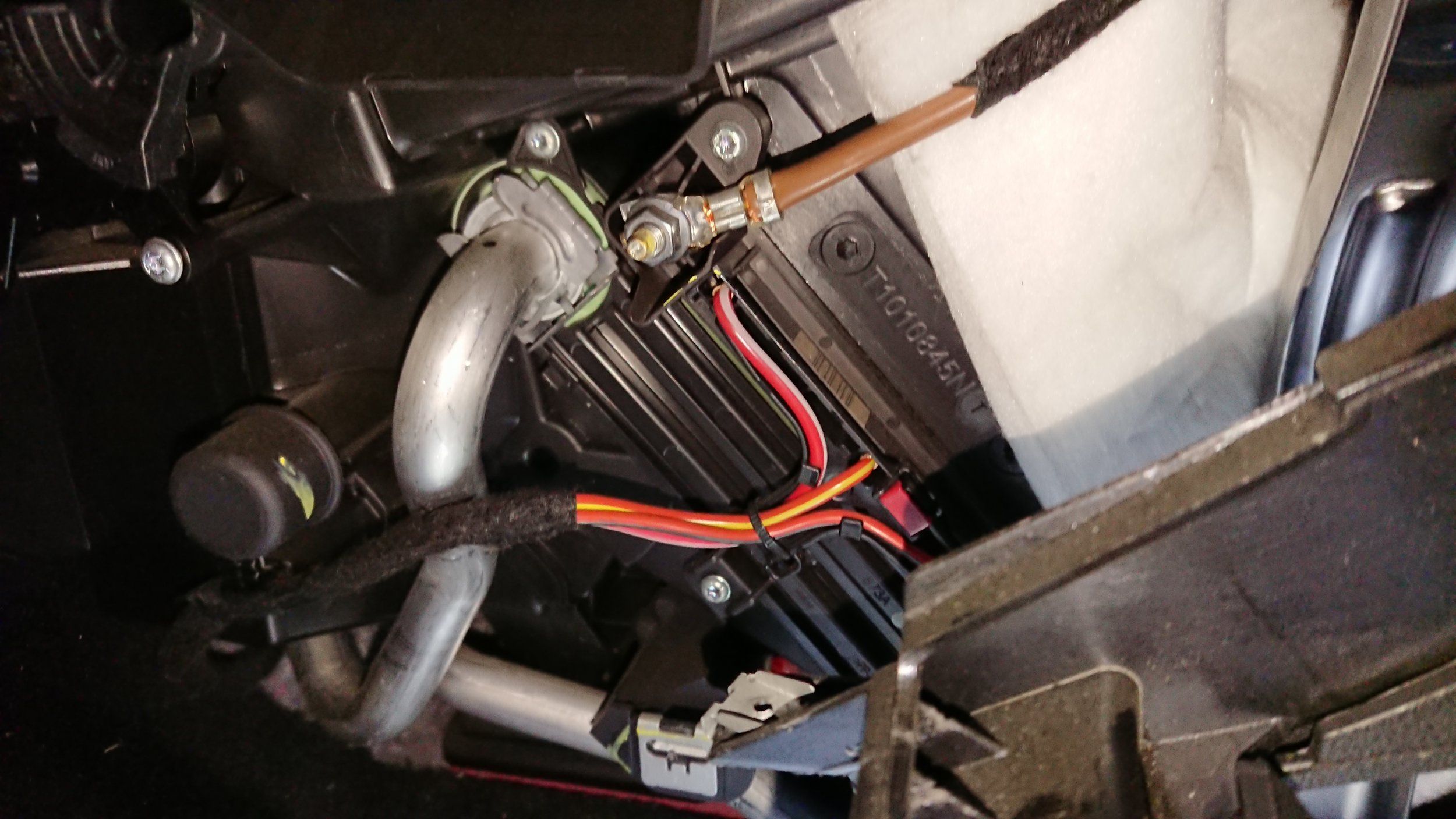

Does anyone have instructions etc to replace the matrix via the glovebox on a 64 plate leon please
Hi,
Being non-mechanical, I did a lot of research before doing this job and couldn't find anything to confirm that the glove box can stay in place, so I followed:
https://www.seatcupra.net/forums/resources/how-to-remove-the-glovebox-media-unit.6/
and then used the video in my post above, to do the matrix.
I would recommend taking the glove box out to do this job. I see from your other posts you have a proper mechanic in tow, it should be a doddle for him. Good luck.
