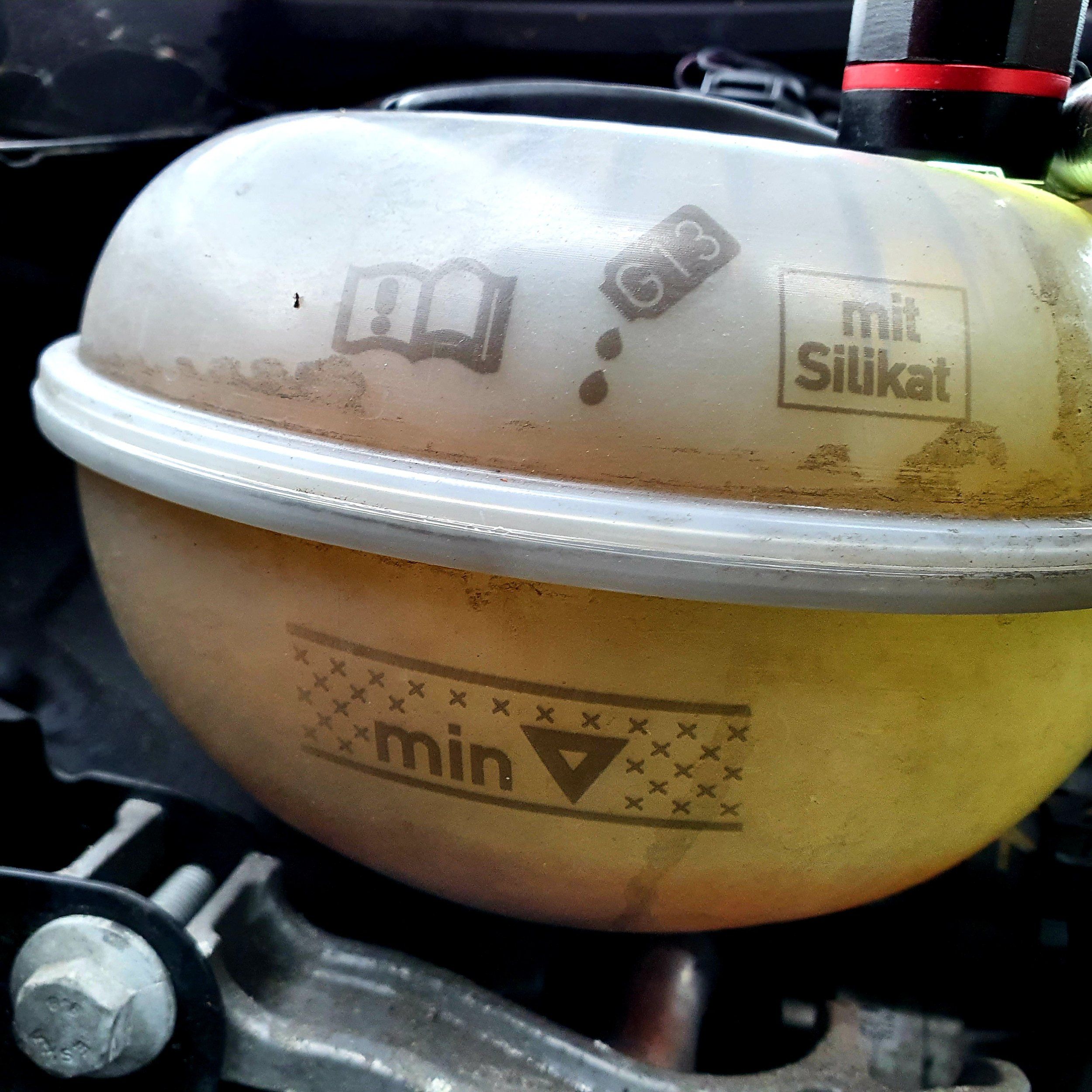

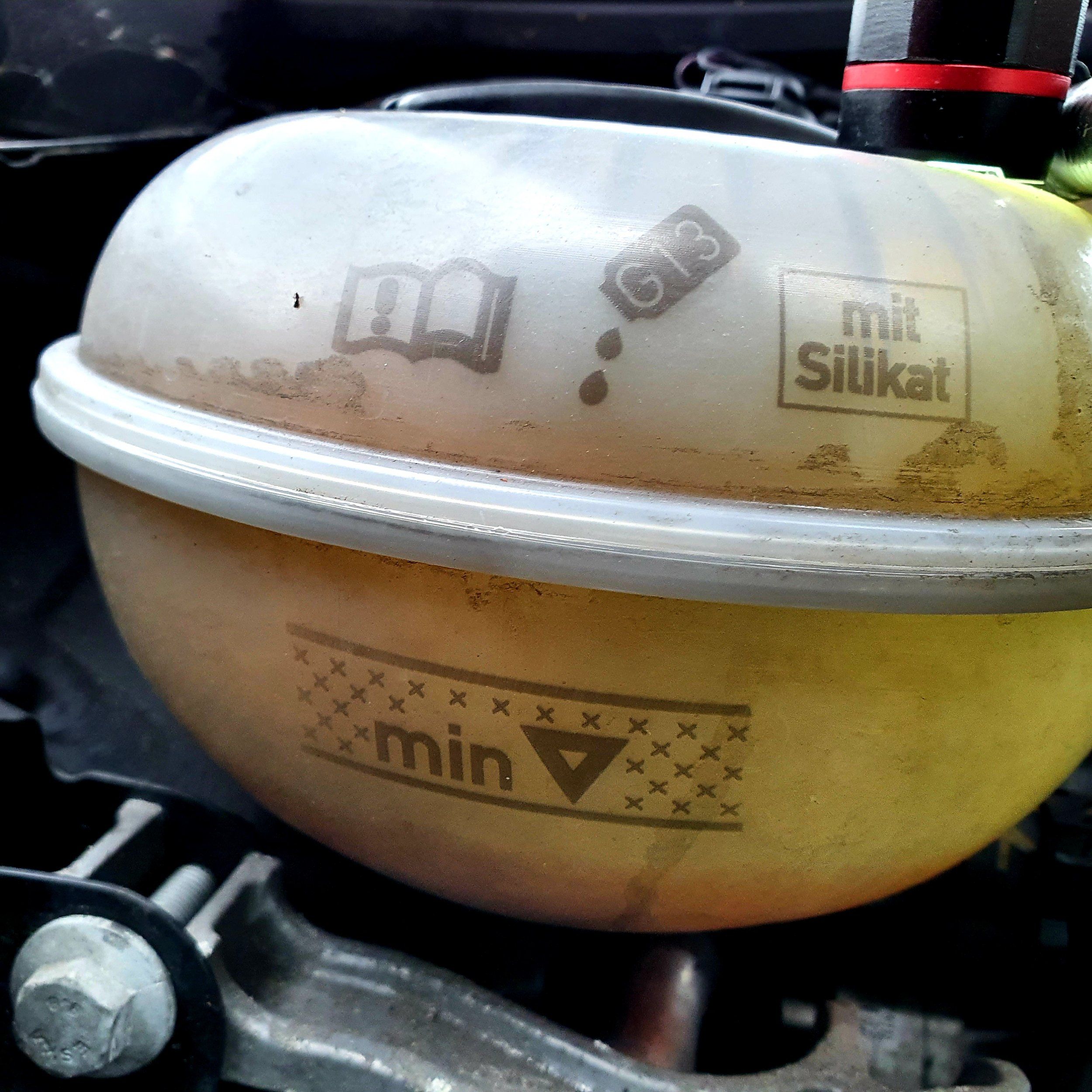

Just to confirm, the coolant header tank on your car has "MIT SILIKAT" written on it and the silicate is contained in a nylon "rectangular tea bag" in that header tank.

That is why I asked that last question, okay the casting sand hopefully seem to have been a short manufacturing period in engine build for some TDIs, but at least some petrol engines got "MIT SILIKAT" header tanks, my daughter's May 2019 Cupra certainly has that, though I'd need to have another look-see to see if it has a proper porous container or something that looks a lot like a rectangular tea bag!
Edit:- I seem to have failed completely to get people to assist in working out why/when "MIT SILIKAT" is included in initial factory build in terms of when, which engine type(s) and with which version of VW Group coolant. This is all still a bit strange to me, VW Group must know the answer to that, and why, and also why and when or if they dropped the need for having to have a back up store of a chemical that was released slowly into the coolant to extend its service life which never seems to be defined.
I though the heater matrix blocking issue with silica was just related to TDI's?
My 1.8 TSI 180 is mit silikat ? Car is currently in garage but here’s photos I took before topping up the G13 last month.

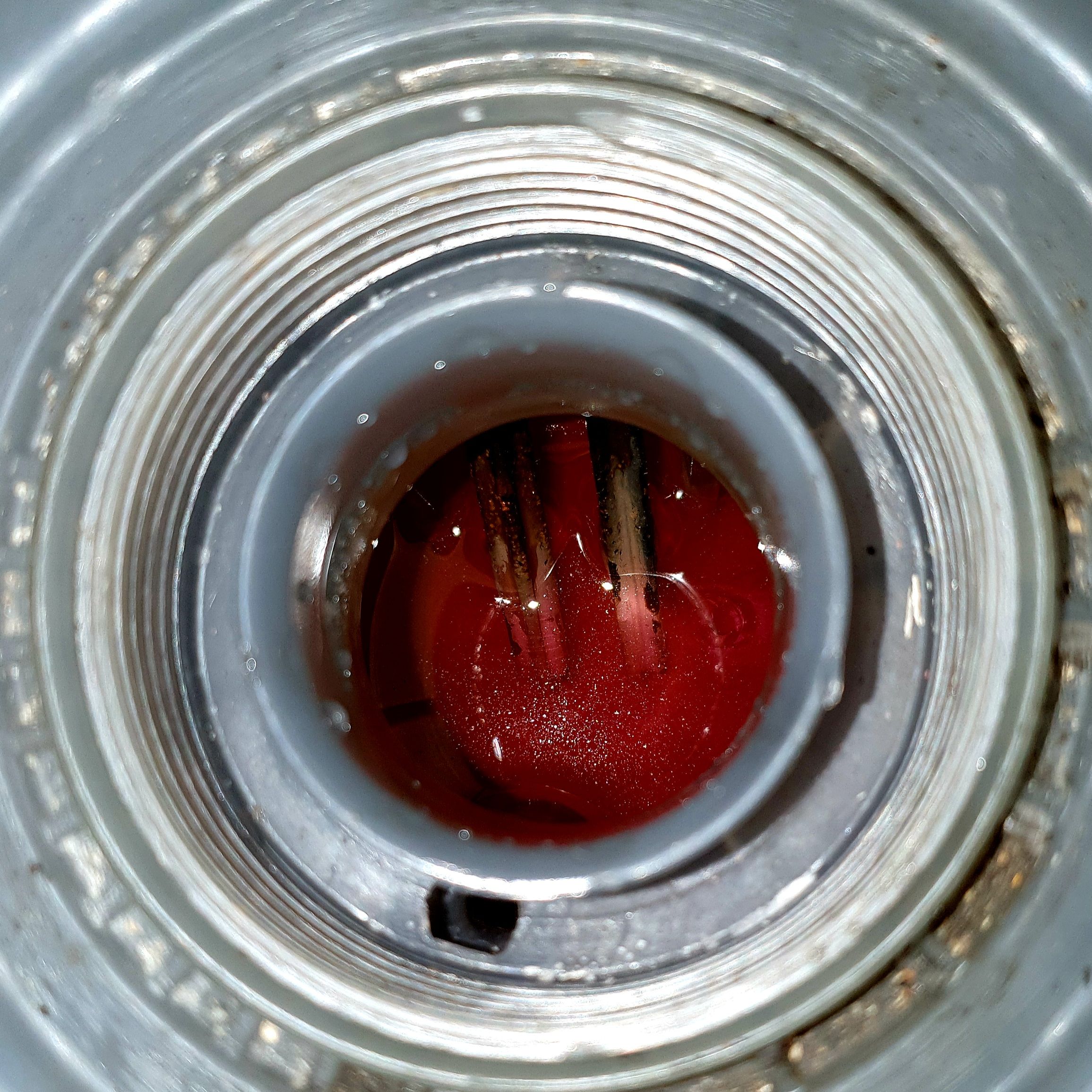

View attachment 20025View attachment 20026
