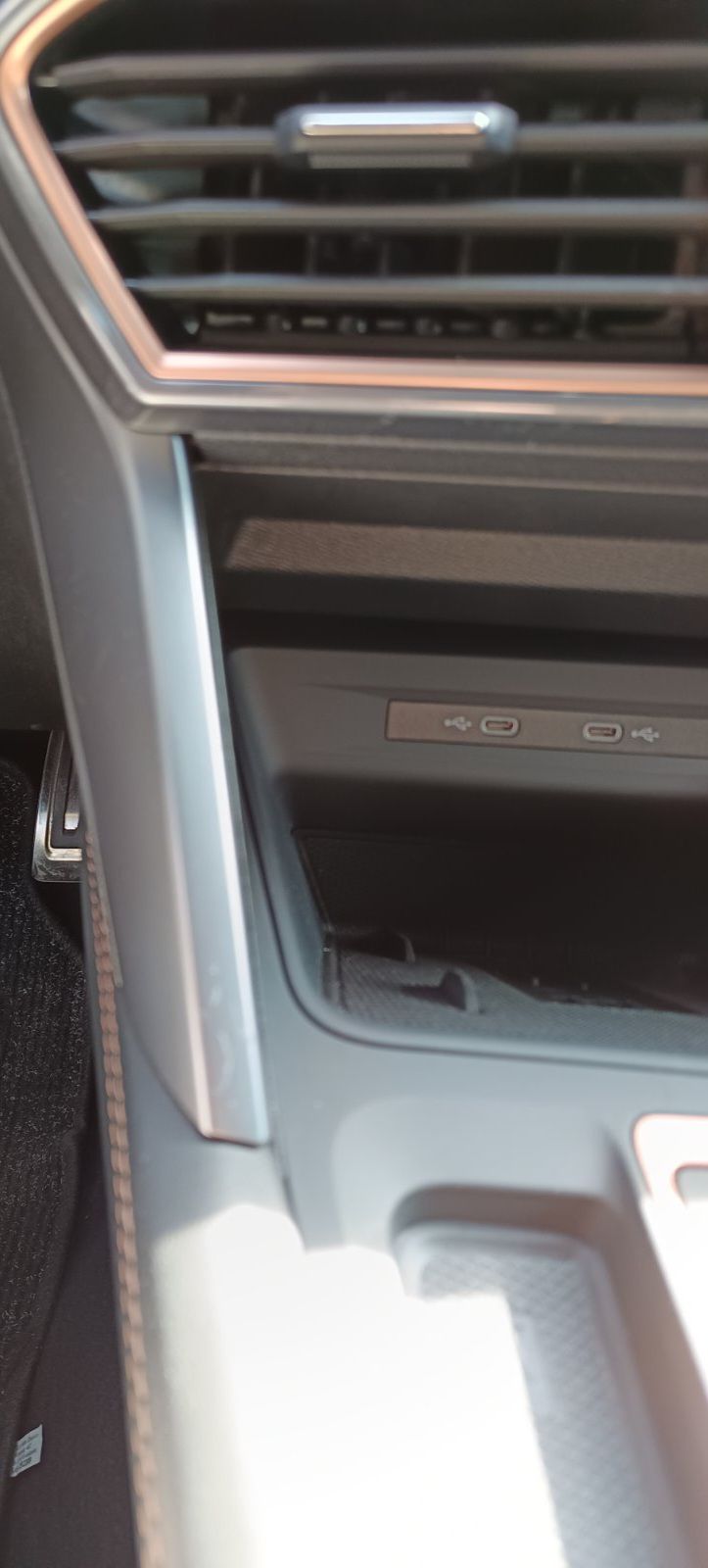

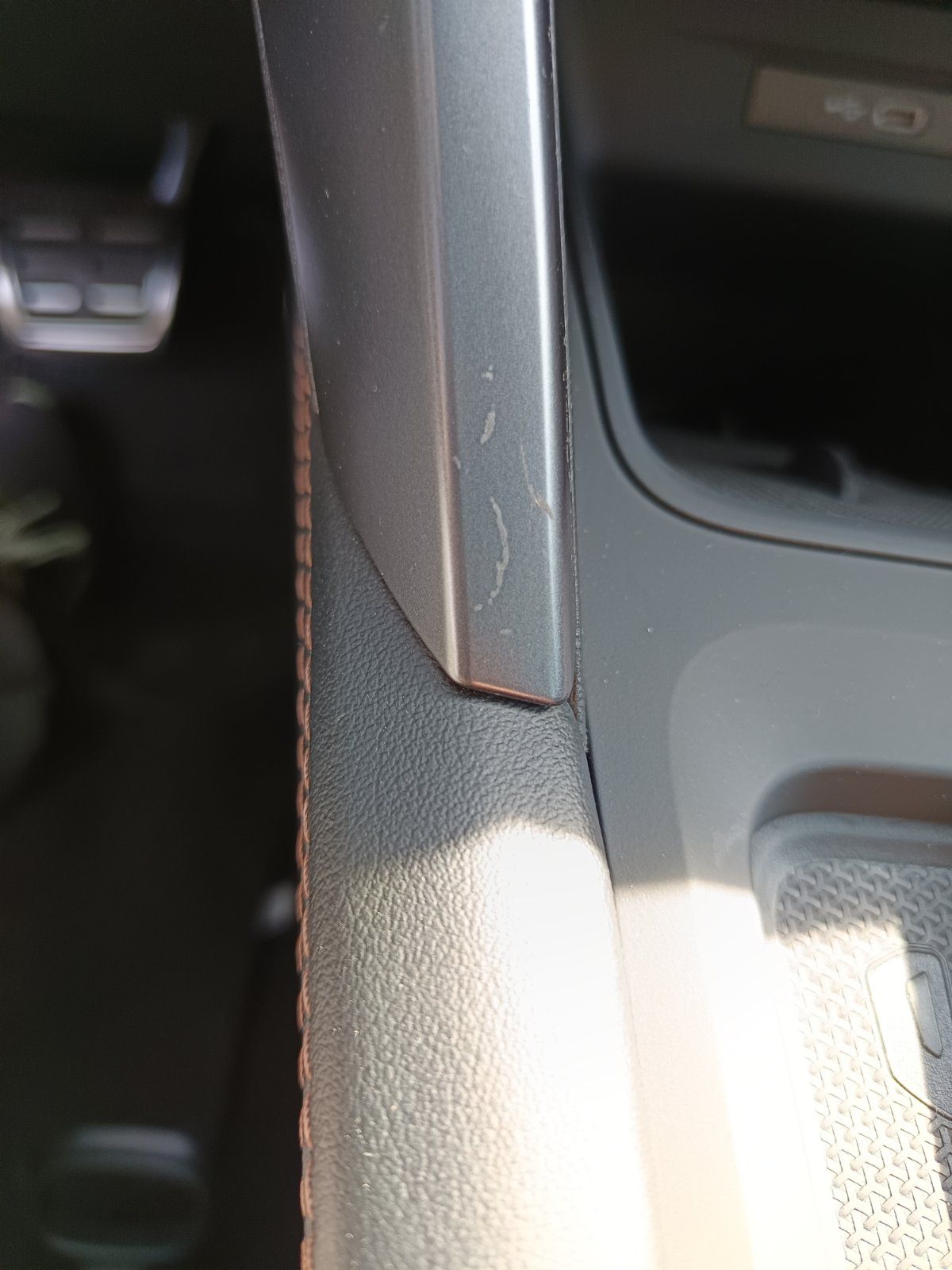

I have a 2025 Cupra Leon Estate and unfortunately my driver's side dashboard strip got scratched and I need to replace it.
I'm attaching photos from my car so you can see exactly which part I mean — it's the vertical strip that runs between the steering column and the center console.
Does anyone know the full OEM part number for this piece?
Would really appreciate any help

I looked up the part and found it, but there are four variants in different colors, depending on the car's trim.
If you don't mind sending me your VIN via a private message, I can tell you which is the exact one for your car.

5FB858451C8RX Strip - Grey
The last three digits of the part number is for colour grey.
Some websites list part numbers without those digits, so make sure it is 8RX before you order.
