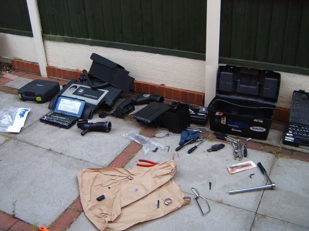

Finally got round to fitting mine today. Every thing came off the car so easily and it only took me an hour..................... Then i realised they had sent me the wrong kit, it has no pipe for the DV return hose.
my mess
