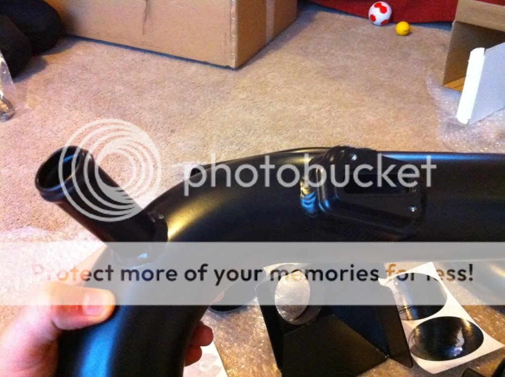

Yeh that's what I mean, you're right, it's for the K03, but doesn't have this pipe near the MAF housing:
Good price though, wish it did fit, reckon they'd sell a lot of them!
If you zoom right into the picture from the link Damo put up mate I think I can see this pipe off from the main pipe. The description to me of this kit say's it should fit our K04'd cars without any modification's necessary.
Suppose an email to Bsh or to Dubtek may clarify though.
