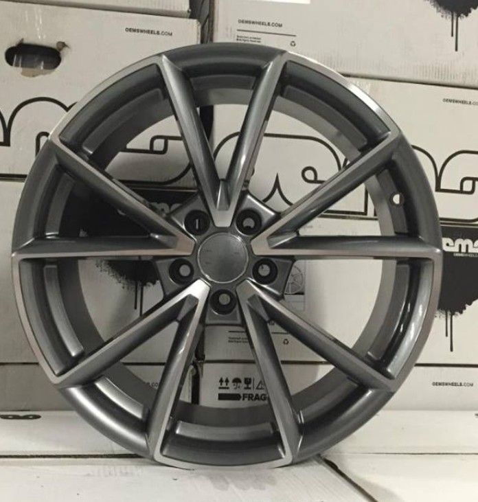

These arey new favourites,
I wish there was a website that you could add an image of your car and try different colours to see what they would look like, after all spending that sort of money you want them to look nice.
@BigJase88 I like the look of the Matt carbon gray on that A3, don't like just black alloys, never have, must have some silver on them to fetch out the details. Decision now is do I go for the ones in the picture above or plain silver 🤔

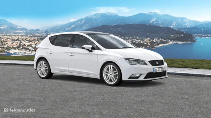

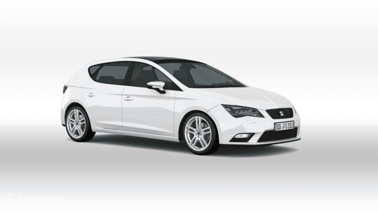

There is a website that you can use. I will try find it
Unfortunately they do not have Romac but i'm sure you could find a similar wheel on there

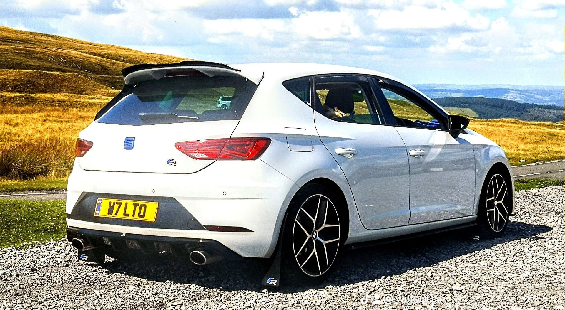

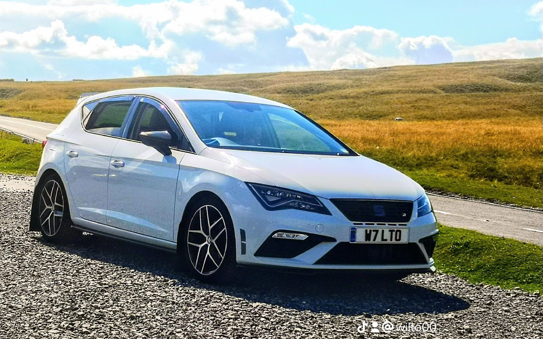

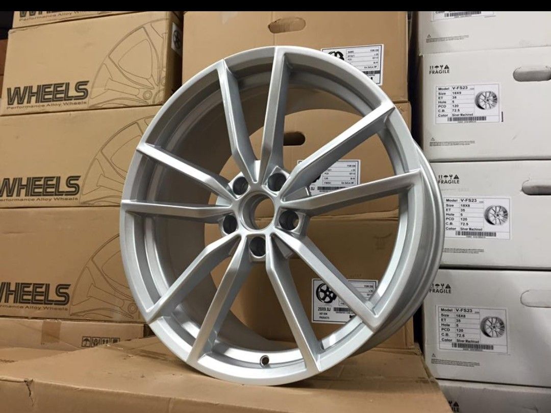

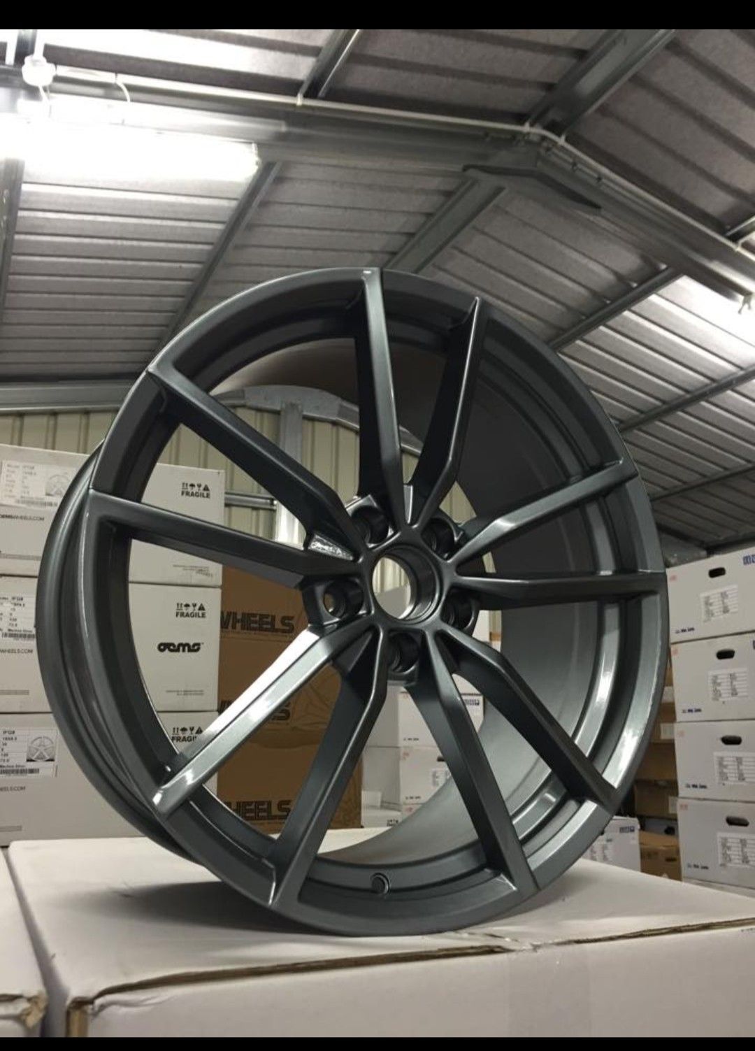

Hiya guys and girls, looking to change my alloys soon, been looking on CM Wheels website. All wheels are 18" the same size as I have on there now
Which one gets your vote?
(1) Pretoria gloss gunmetal
(2) Pretoria hyper silver
(3) Audi RS4 gloss gunmetal machined
This is my current setup
View attachment 35870 View attachment 35871
Many thanks in advance guys
Gun metal would be my choice, love that exhaust system btw 👍

It’d be the Pretoria reps in gunmetal for me.
I’d always avoid anything machined, especially at the lower priced end of the market. It’ll only be a matter of time before white worm corrosion sets in.
Factors to consider with alloys from CM Wheels;
  • Bear in mind that they only sell alloys as sets of four so if you are unlucky enough to damage one, if it’s not repairable you’d be faced with buying a complete replacement set. However, if that does happen, at less than £500 for a set of four it wouldn’t be too expensive replacing all of them.
  • The standard Seat centre caps may not fit. If they don’t, you can buy a set of centre cap stickers on various websites (e.g. eBay Etsy) and attach these to the centre caps supplied with the alloys.
  • Wheel width and offset of the CM Wheels Pretoria reps are 8J and ET45 respectively. I may be wrong but I think the equivalent with 18” OEM factory alloys for the mk3 Leon FR are 7.5J and ET51. Therefore the face of the CM Wheels Pretoria reps will protrude outwards an extra 12.4mm and the inner face will be 0.3 mm closer to the suspension strut (according to the calculator on www.willtheyfit.com) compared to an 7.5J x 18” ET51 OEM factory alloy for the Leon FR (IMHO, the reps will give a slightly better stance than OEM).

Cheers pal. Which gun metal do yo like, the Pretoria or the RS4
Low cost diamond cut alloy wheels (which is what the RS4 reps from CMWheels are) may succumb to the dreaded white worm corrosion fairly early on in their life - especially on a car used as a daily driver all year round - as the quality of finish maybe poor compared to OEM alloys. Winter road conditions and diamond cut alloys isn’t a good combination.
I personally dislike diamond cut alloys with a passion, so I’d avoid anything diamond cut; too many downsides IMHO;
  • Poor durability of clear lacquer on bare metal (bare metal doesn’t provide a good ‘key’ for the lacquer to bond to), so susceptible to lacquer peel and white worm corrosion.
  • More expensive to refurbish than painted / powder coated alloys, and can usually only be refurbished a maximum of two times; more than twice and the structural integrity of the wheel may be compromised.
  • Refurbishing diamond cut alloys is usually a temporary fix; white worm corrosion is likely to reappear at some point, and the refurbished finish is unlikely to last as long as the original finish on OEM diamond cut alloys.
  • Easily damaged by tyre fitters and poorly maintained tyre changing equipment, and then denying they caused the damage.
That’s just my opinion though and we all have different likes and dislikes, which is a good thing 🙂.
