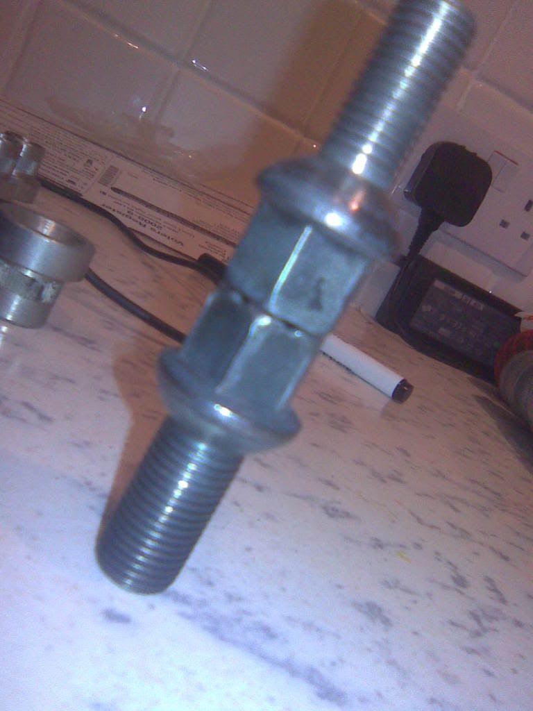

OLe thanks for taking the time to do this.
So that second to last picture is what you put in the rim hole to make it go from M14 to M12 right?
Because the other pictures of the bolts, just look like regular bolts?

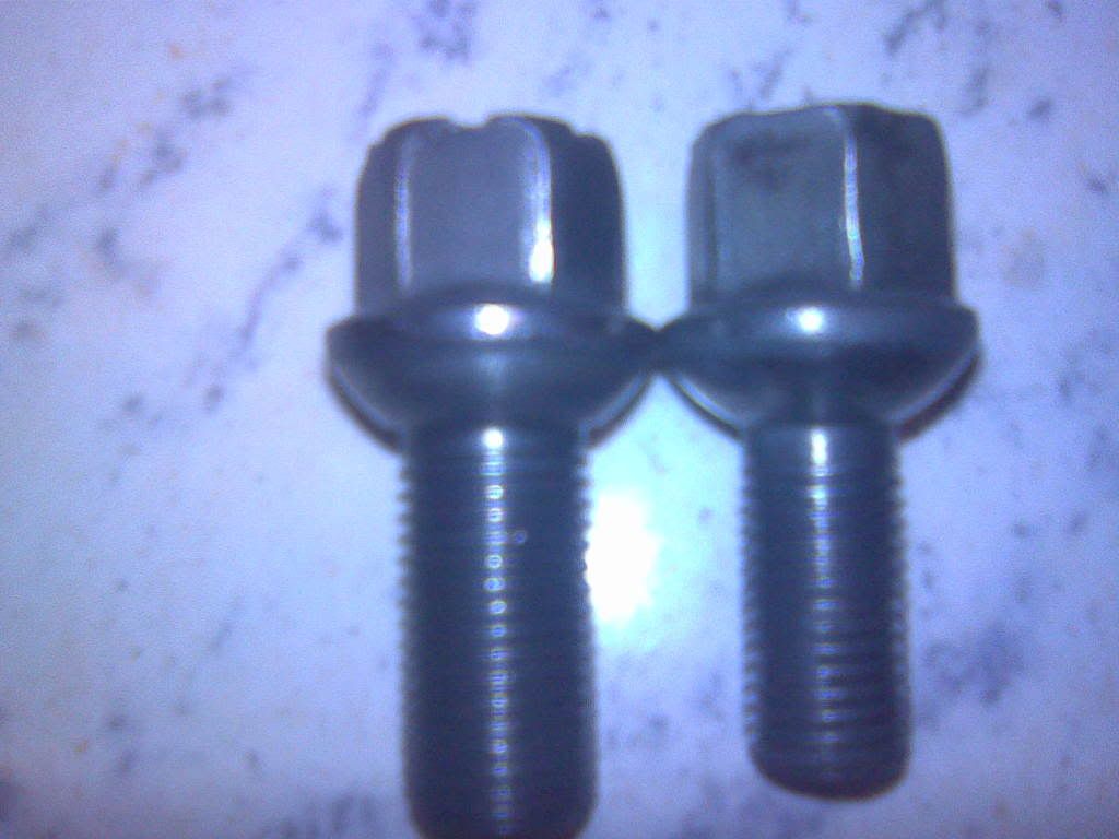

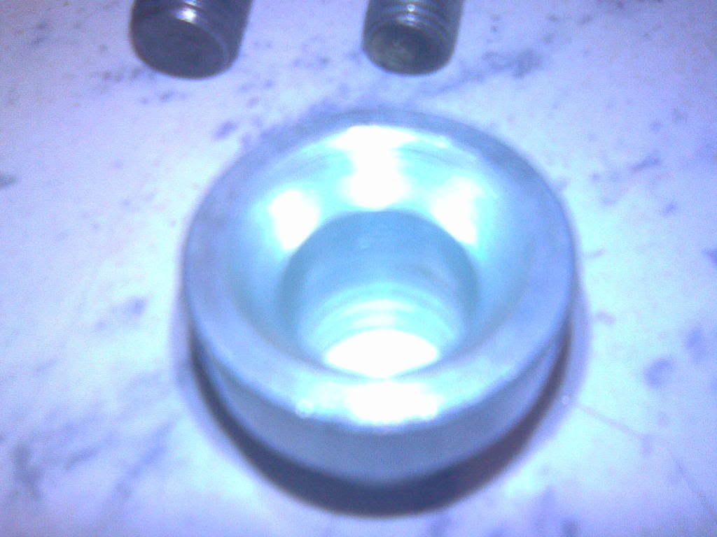

Ok first of picture of the OEM non-conical bolt which is not right for the rim
then the space it leaves in the rim bolt hole
As you can see quite some space left to fill

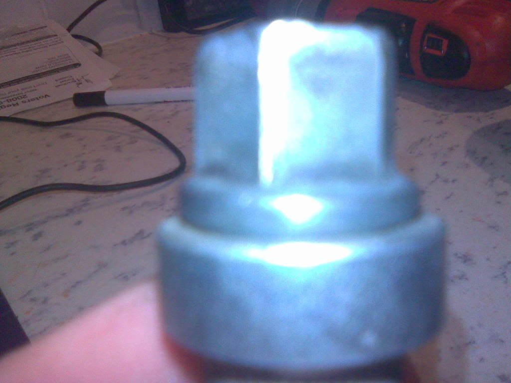

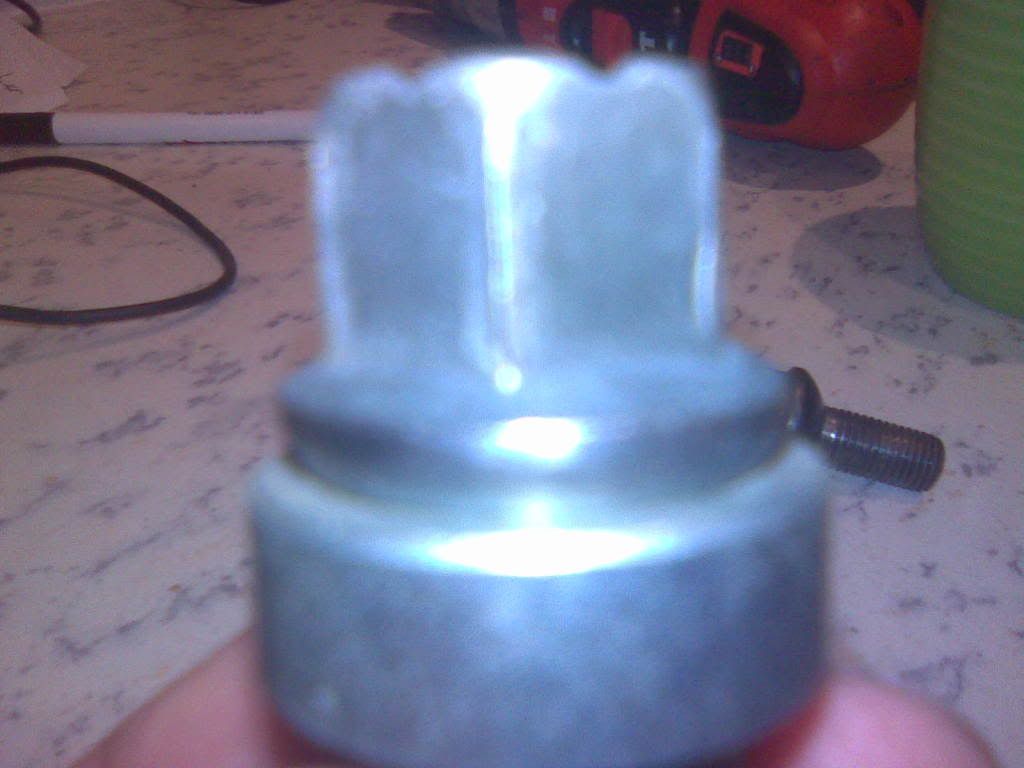

Here you can see the ring I meant which makes it sit nicely on hub spigot. And you can kind of see it needs conical bolts
