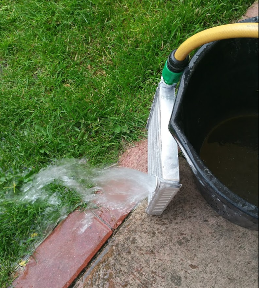

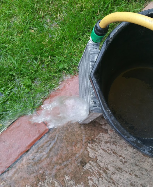

Finally received my new heater matrix - even just blowing through it you could tell the old one was restricted.
Thought I would do a simple hose test of old and new and you could also see a difference in flow.
OLD vs NEW

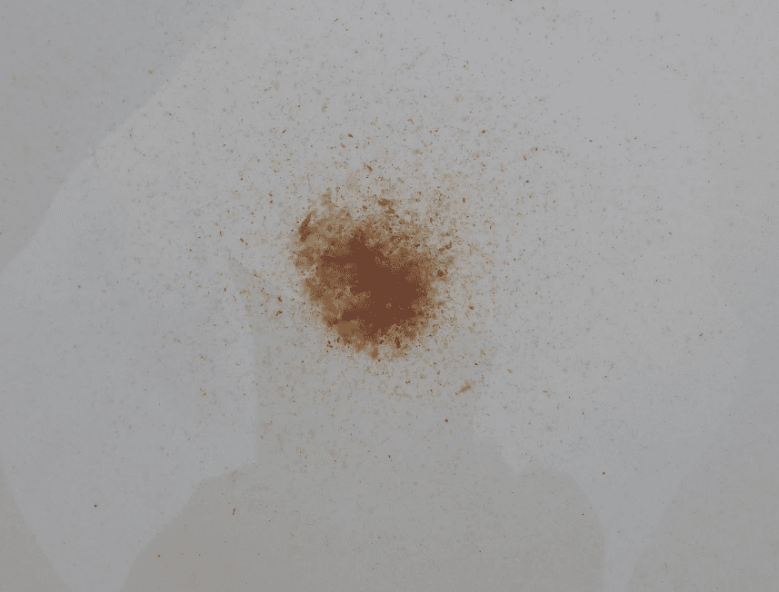

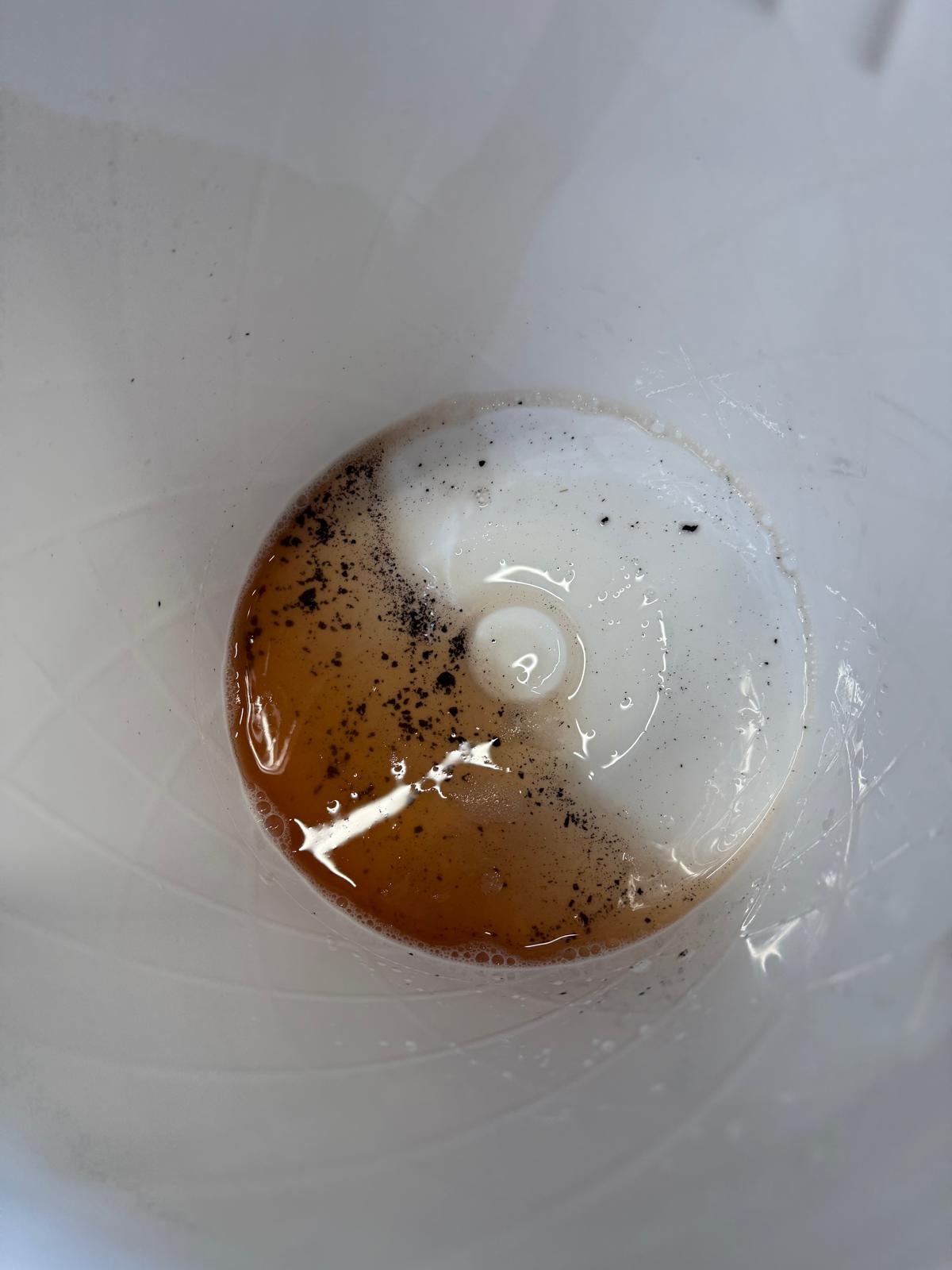

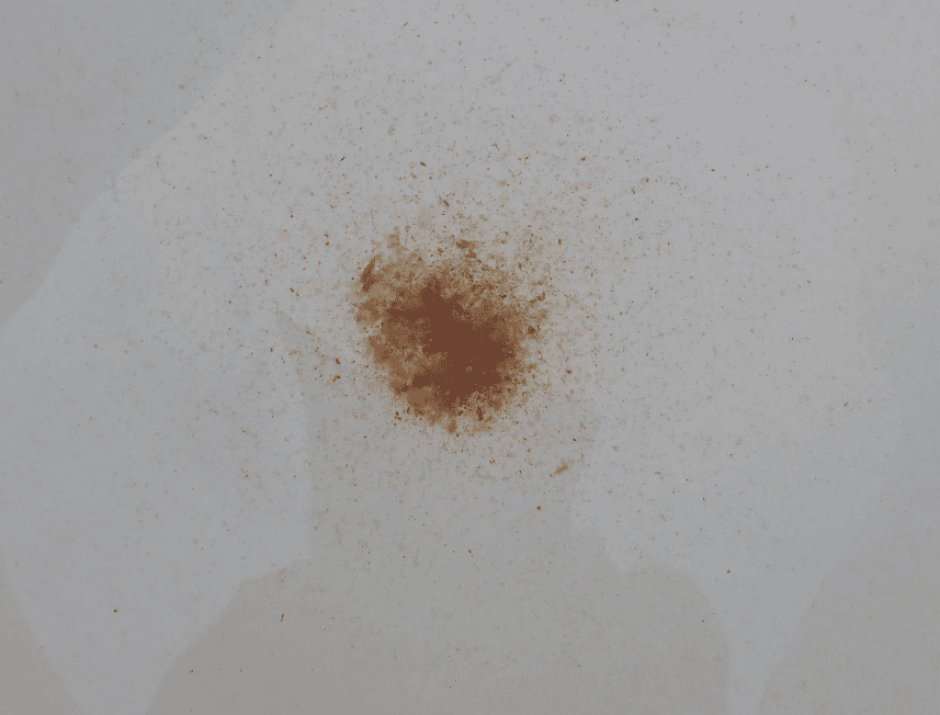

Since then, I have tried to clean the system properly myself. I drained the coolant from all three drain points according to the workshop manual, but as you know, that only removes roughly half of the coolant from this engine. I then repeatedly filled the system with distilled water using a vacuum filler and performed around five complete fill/run/drain cycles before finally refilling with concentrated G12 Evo to achieve approximately a 50/50 mix.
The worrying part was that every single drain produced a large amount of black/brown debris and sludge. After doing more research, I realized the dealership had refilled the system with G12 Evo after the heater core replacement while a large amount of old G13 residue was still inside the engine. I suspect the mixture of degraded G13 contamination and G12 Evo created the brown sludge that eventually cooked inside the EGR/oil cooler circuits and heater core.
Even after all those flushes, I still could not fully eliminate the contamination. I have been forced to reverse flush the heater core every couple of months just to maintain cabin heat.

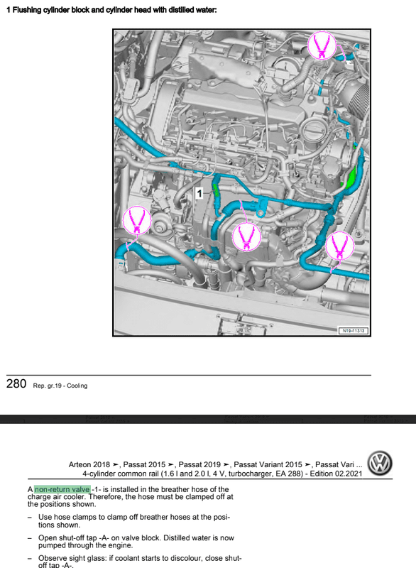

Recently I noticed there was no coolant flow visible in the expansion tank return hose. After investigating further, I found both the return hose and the non-return valve on top of the oil cooler circuit (#1 in the schematic) heavily clogged with debris. I cleaned the hose and valve thoroughly and found even more contamination trapped inside the oil cooler passages. After reassembling everything and running the VCDS bleed procedure again, the return flow finally came back and the thermal management system started behaving normally again, including after-run pump circulation.
Ironically, one day later the heater core partially clogged again, which makes me think restoring proper circulation liberated a lot of debris that had been trapped in stagnant areas of the system for years.
Interestingly, despite all of this, I never experienced overheating or abnormal oil temperatures. My theory is that many of these small bleed/restrictor/check-valve circuits gradually became restricted over time while the main cooling circuit remained functional enough to avoid major thermal issues.

Also your 'debris' looks very black - don't remember anything like that in my system - when I went through a couple of years of flushing my matrix and the 'debris' was always light coloured, like sand or limescale.
