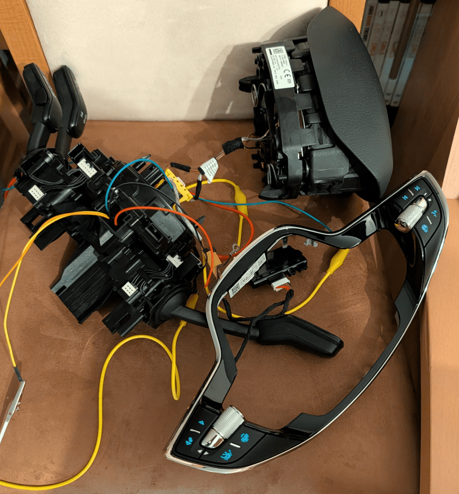

I converted a Kodiaq myself and find the prices of the adapters simply outrageous...
There must be an OEM solution for this, and I seem to have found two solutions after studying the SLP and comparing it, etc.
But currently only affects the Continental Gateway.
So, the monster lives! 😜
Successfully using the MFL (multifunction steering wheel) at the table today. Here's the configuration:
The new MFL buttons (sub 19)
Gateway (19)
Multimedia System (5F)
Steering column control unit (16)
"Analog" speedometer (17)
Coding, adaptation, and data set creation were all done, of course.
The starting point was a Conti 3Q0907530C as hardware and AA as software.
