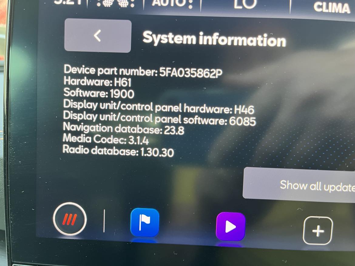

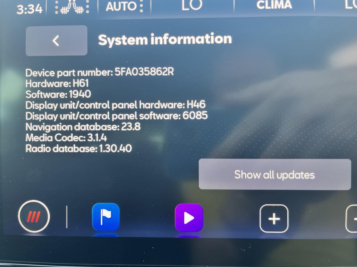

vectra
Sep 3, 2011
150
53
Came across somewhere and found this 1940 update, can anyone confirm this is the correct one?
5FA919360AN
Took a punt and stuck it on a pen drive.
All went well
vectra
Sep 3, 2011
150
53
You have quite a new car then as you have hardware H61 mine is 2021 and I’ve got H56 think H56 was the first version. Glad it went well.
Hi
Yes it was built in June and I collected it on aug 11.
SWANSWAY CUPRA Dealership
