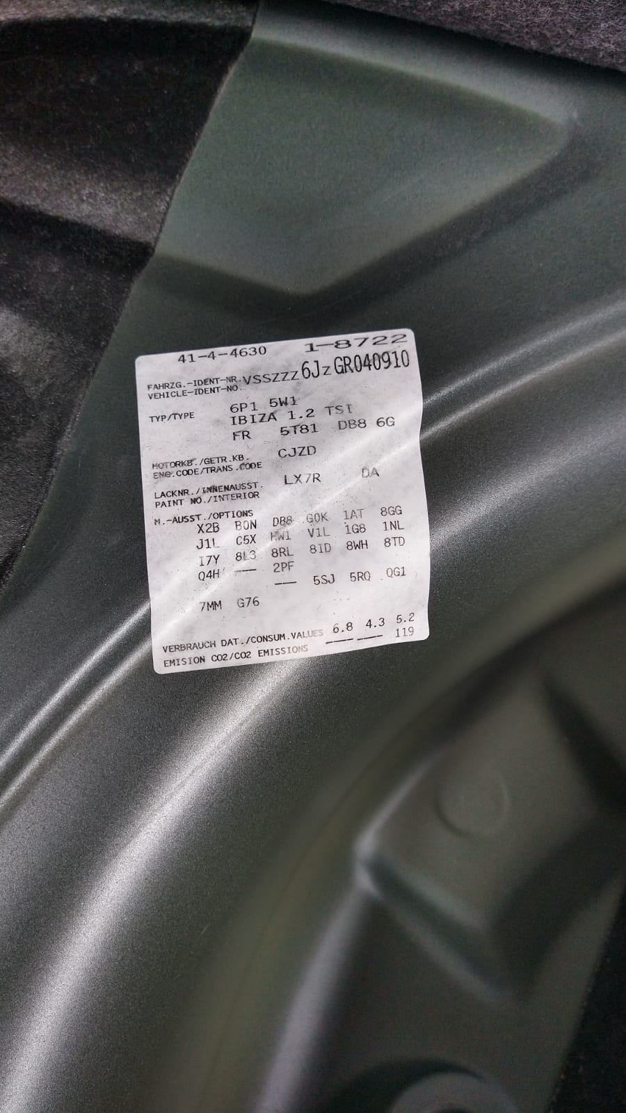

Hi everyone, as title suggests I've just bought a 16 plate Ibiza fr 1.2 110 bhp with 6 speed box, my first seat?, the car has 14, 000 miles on it and it has the engine code cjzd, I'm wanting to know a few things, will it have a timing belt or chain? If it is chain do they need to be checked periodically? What are the service intervals on it? What is the difference in engines between the 110 bhp and the 90 bhp? And lastly anything I should look out for with regards to things failing? Thanks very much for any help with my questions

Has a belt.
Its the 2015 replacement for the chain cam drive 105 that I had.
I've driven the 110 and its pretty much as nice as the 105 but reputedly more reliable.
The low power ones (86 or 90) tend to come with 5 speeds, better torque and slightly better real world economy.
If you haven't already, you can use this site to decode the options on your sticker:
Or download the full lists from here:
The manual should have everything else you need in terms of service intervals etc and that is here if you don't have a paper copy:
The option codes may tell you the service interval too. Both of mine since 2014 have been delivered on variable service (up to 18000 miles with the right oils - depending on driving style). But owners can opt for 10000miles/12 months instead I think - your low mileage car should be on this regime the variable one is more applicable to commuters and high mileage drivers.

Actually when I asked the garage the service history they said yearly so that answers that, is there anyway to tell if it's defo a 110 bhp? Cheers
