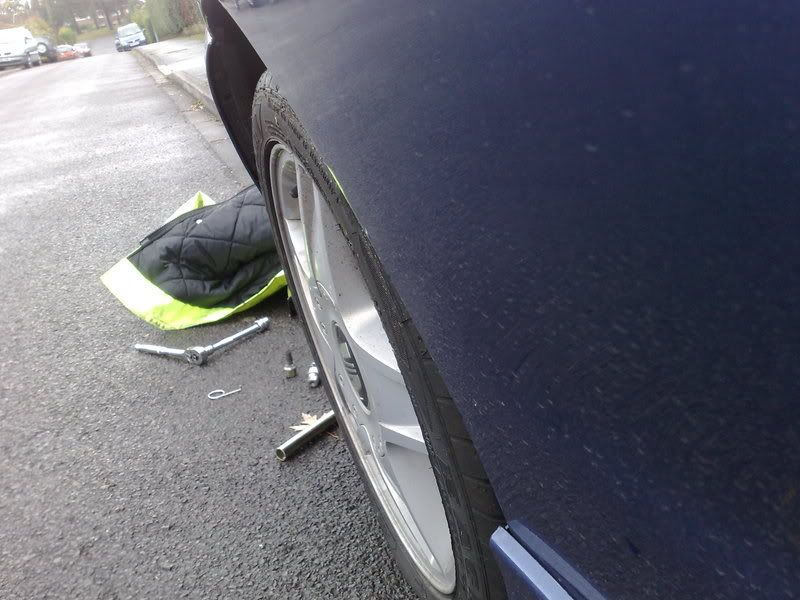

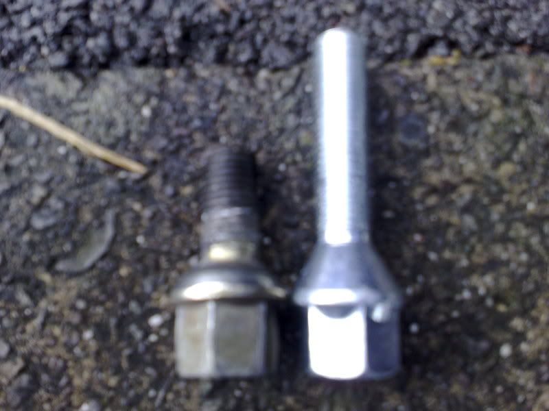

so the bolts were long enough thennice
When i put them together i wasnt worried, pic abit blury

DO NOT DRIVE THE CAR
you've fitted conical bolts to your radius wheels.... they're NOT SECURE.
don't go anywhere until you've fixed this.
I had conical wheel bolts with my Cupra wheels. I am sure they took conical ones... Maybe I'm wrong though, but I would check your wheels to see if you had the wrong kind to begin with.
No, the bolt in the picture on the left is the original bolt.
Then why do you say that he might have had the wrong ones to start off with??![]()
I had this problem with the bolts on my previous car. They had to be conical but the guy who mounted the new rims didn't use conical. That caused play on the wheel and hub, and in the end when I heard it and tried taking out the bolts, 2 bolts snapped off in the hub. had to buy a new one...
so yes sort that before driving
Spacers are off oem bolts back on till i get the right ones thanx to all for stopping me doing some damage, great bunch of people![]()
