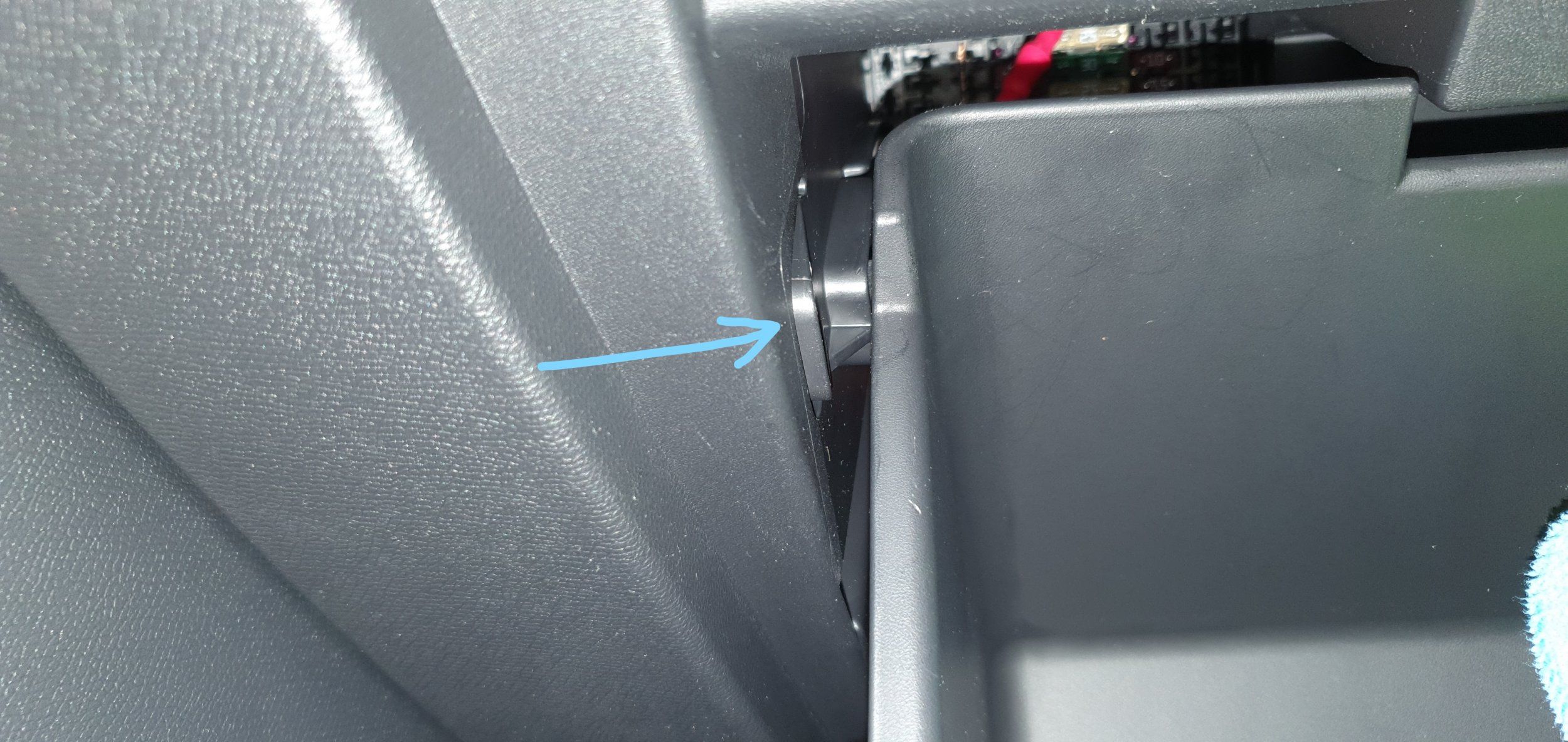

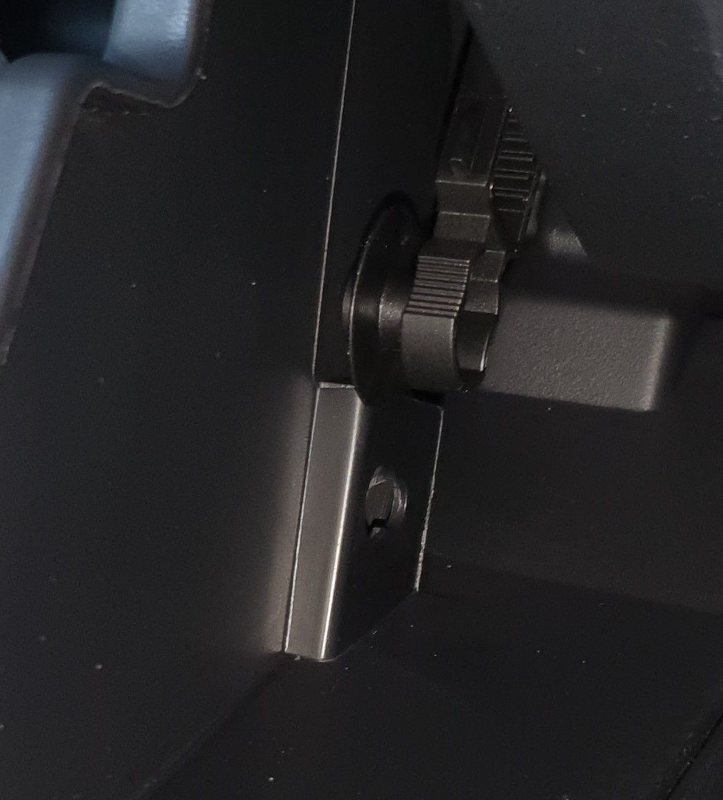

Then the glovebox has a peg which locate in runners on either side which need freeing. There may be an easier way but the only way I could find to release them was to press in the plastic where the arrow is pointed and at the same time press the side of the glove box in. It took patience and a good deal of brute force. When they are both freed then the glove box can be dropped down to reveal the fuses.

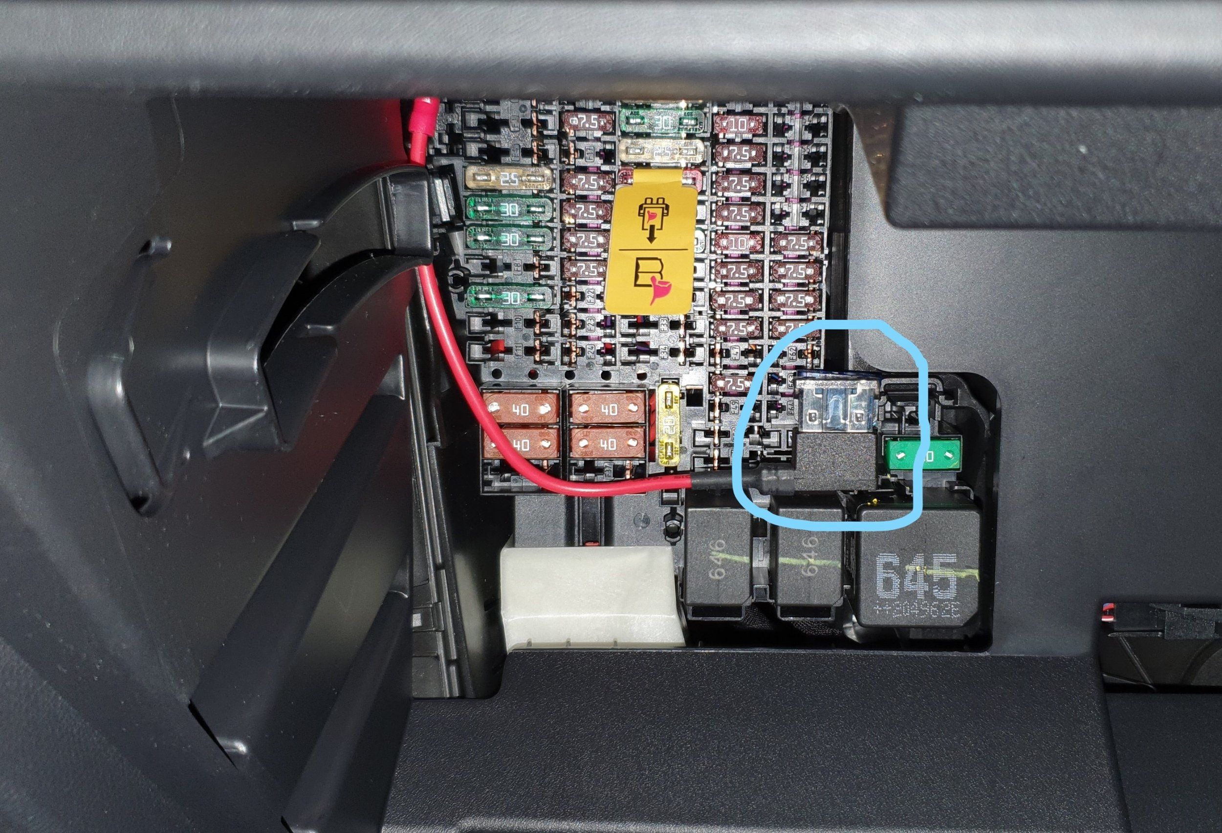

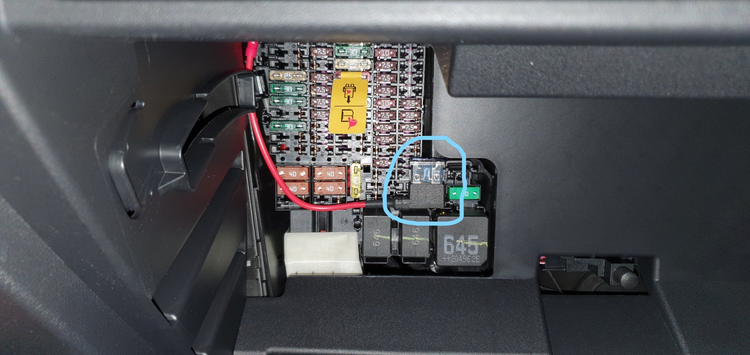

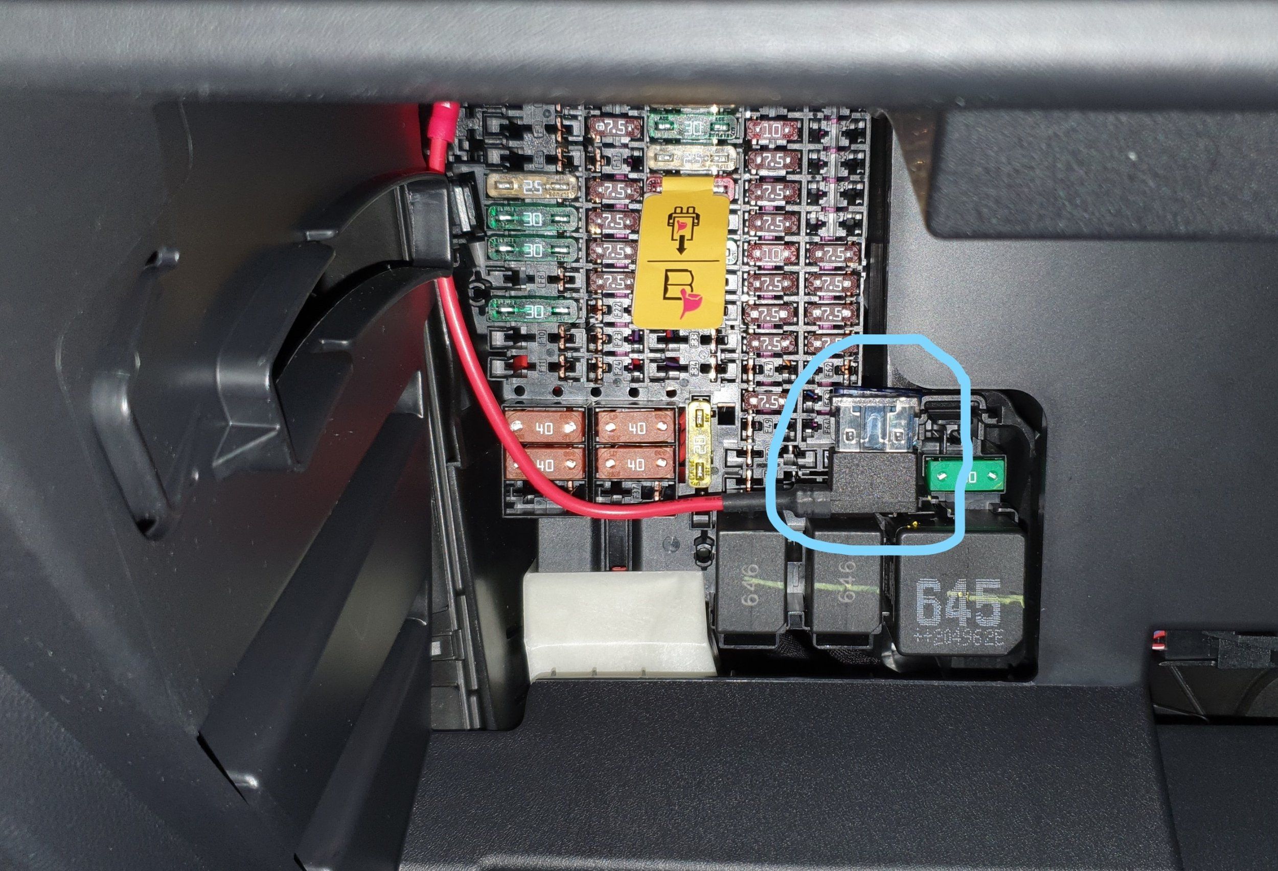

Then I placed the fuse piggy back holder in position 66 which is the rear wash wipe and as such is ignition switched. The wire was then fed up in front of the fuses to where you can see it emerge in the next photo.

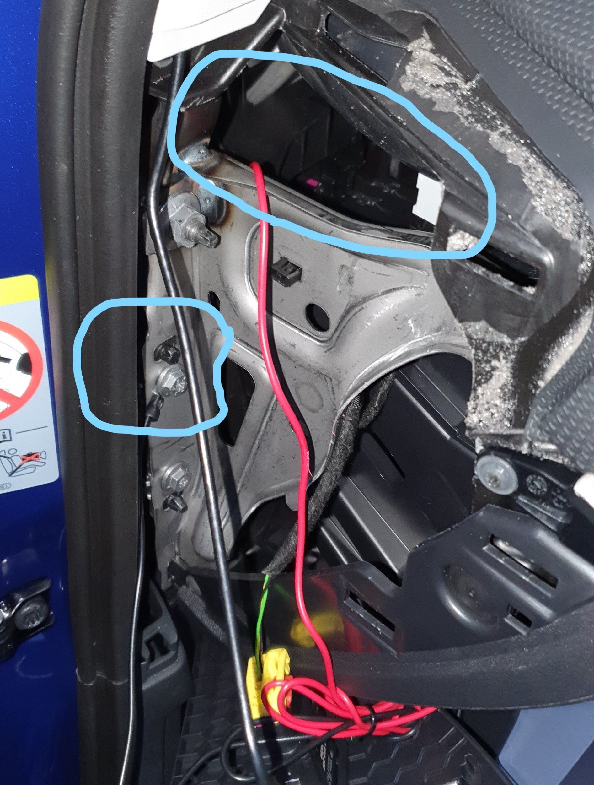

Next I pulled off the dash side panel which was simply clipped in. The earth spade was then attached behind the dashboard bolt circled above as this gives a good earth.

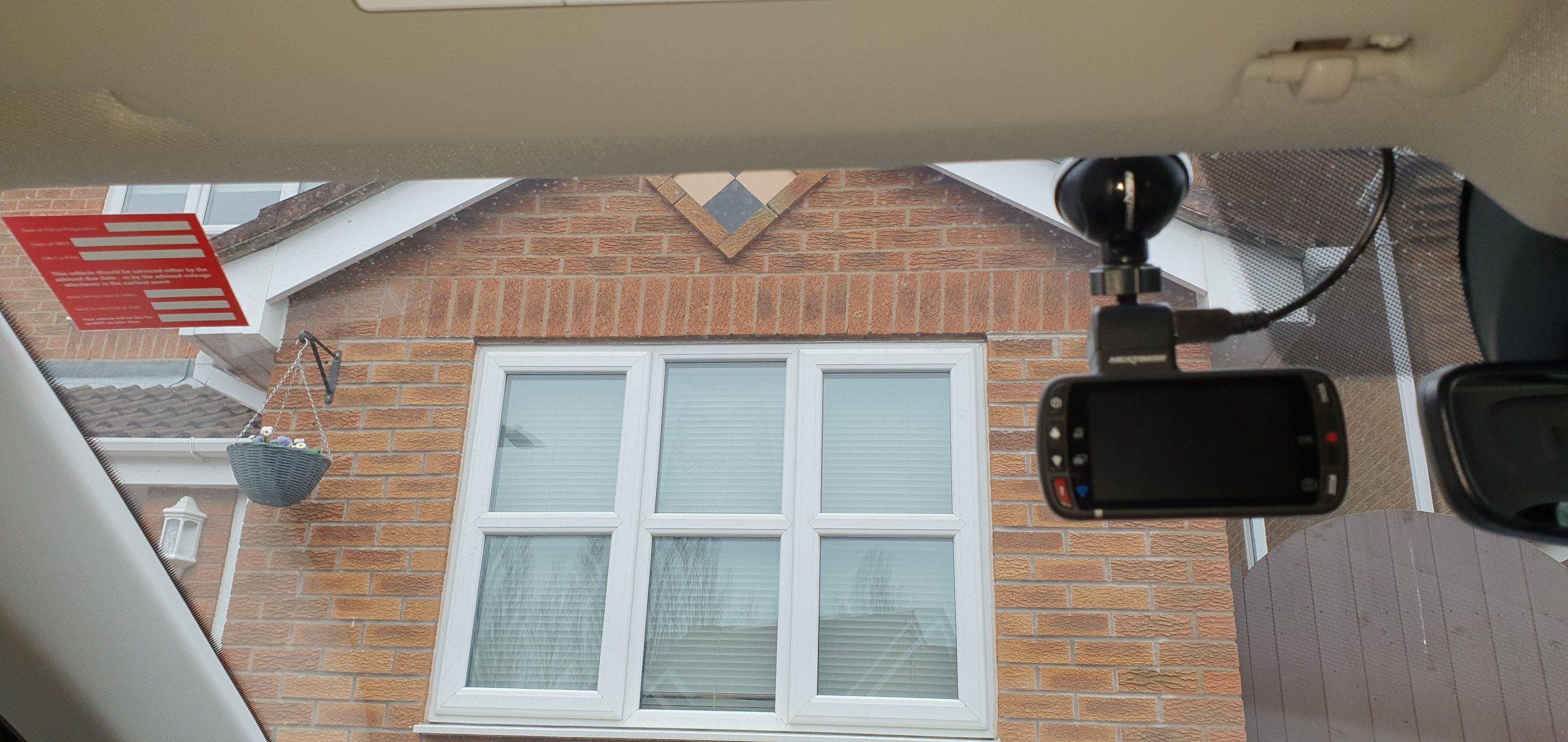

Next I put the camera unit in position and fed the cable behind the headlining and unclipped the A pillar cover partially and fed the cable behind. Finally I tied all the surplus cable together put all the excess into the handy void circled at the top before replacing the dash panel.
The result is a very neat installation with only a tiny bit of wire visible and the camera operates automatically when the ignition is switched on. It took about half an hour in total.

You should be using slot 52 not 66 - if you notice slot 52 has two position one is for key on and bottom one is for constant power (in case the camera has parking monitor without battery inside)
Has anyone hardwired a dashcam on a LHD car? I am struggling to find a good ground point, none of the screws near the fuse box seems to be working.
One of the many drawbacks to modern car electrics, earthing points are now very specific as all components are loomed and part of assembled block installation - each used to have its own earth point and it was easy to find one, but prone to install errors.
You could try taking off the dashboard side panel, open the passenger door and prise it out from the front edge. On my RHD there was a host of sharp steel in there and, if I recall correctly, an earth point that might be duplicated on the LHD?
Edit: it's shown in the fourth picture of the original post above.
Thanks for your reply. Turns out it wasn't bad earth, but a bad live connection ?‍♂️ It's all fine now, either of the two bolts near the fuse box will work just fine :)
