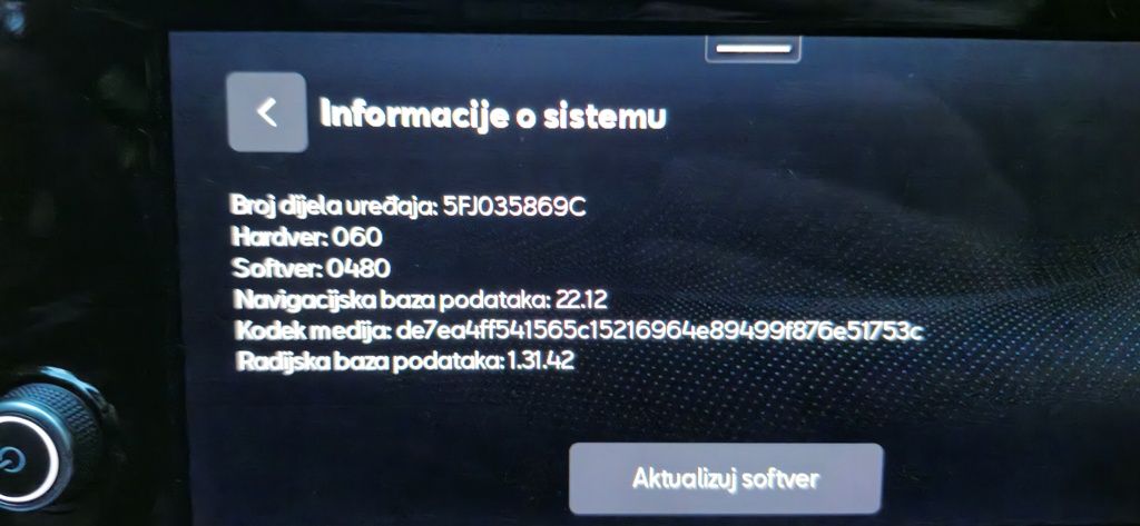

Just bought a Seat Arona with an alleged factory installation mistake, which I wanted to discuss.
It's a 2024 Arona FR, which was supposed to have a 9,2 MIB3 with navigation and wireless android auto. I was explained that a mistake was made during production, and that a wrong device was installed, leaving the car without this piece of equipment. The first owner returned it to the dealer, enabling me to purchase it at a good price. My last car was also an Arona (not the FR) and it had Android Auto which I now miss.
I tried to activate it through the dealership, and they explained that my infotainment system is I8U, and that they can only unlock android auto on i8q.
The thing I have trouble understanding is that when I list the device part number in the menu, it says (in the car menu)
5FJ035869C​
The mighty internet suggests that this is a part number of the "gps navigation system seat arona KJ7, KJP", Also in the My Seat app i can see the location of the car, suggesting it does have a gps.

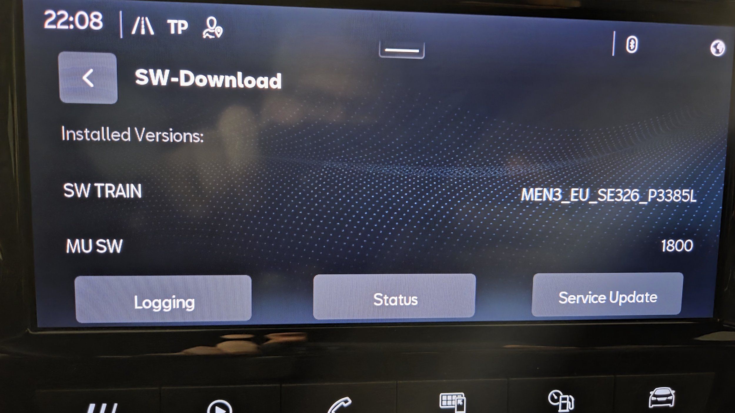

When i opened the hidden menu, it says that the software version is 0480. When checking by VIN number it says that the part number is 5FJ035869D GVK but it doesn't look the same (there is a different button). The display is divided in three parts, bluetooth works fine. Seat Connect works fine, wifi hotspot works, although i don't have an option to connect to random wifi networks.
Could it be that the installed device is right, but the software isn't? Am I making any sense and does anyone have any suggestions?

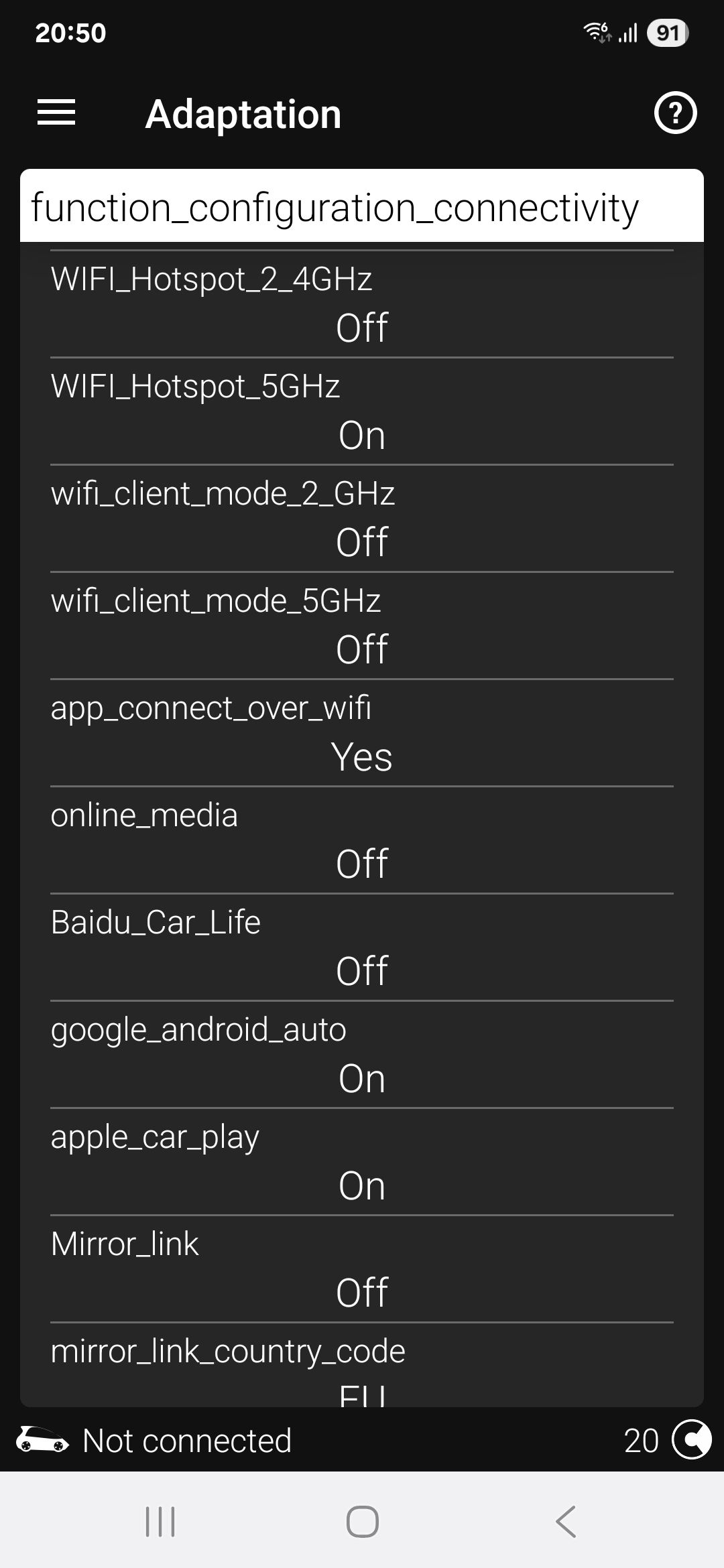

The unit should support AA, it could be as simple as you just need to enable it threw obdeleven or it could be more difficult that the "swap" isnt enable for Android auto.

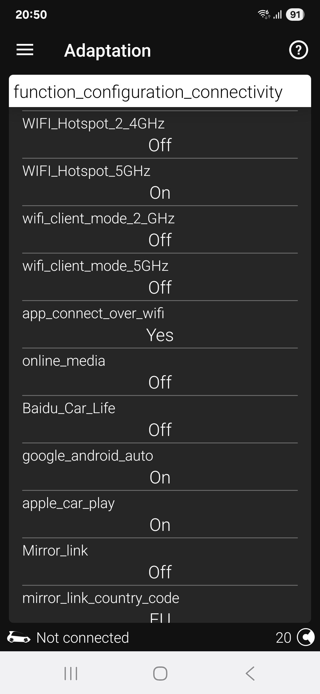

In obdeleven control units, 5F, adaptations, function_configuration_connectivity
Mine looks like this.
Guess I'll have to invest in obd11. Will it affect the warranty?
No, well if you mess up completly maybe. Just do a backup before changing things and you are fine.
I can check the swap numbers I have enable first, if yours the same, in theory you should just be able to fix AA with obdeleven.

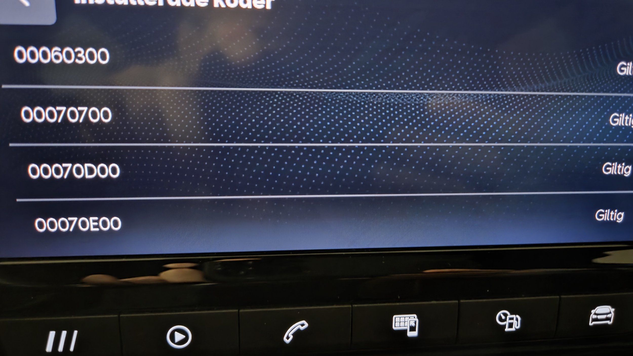

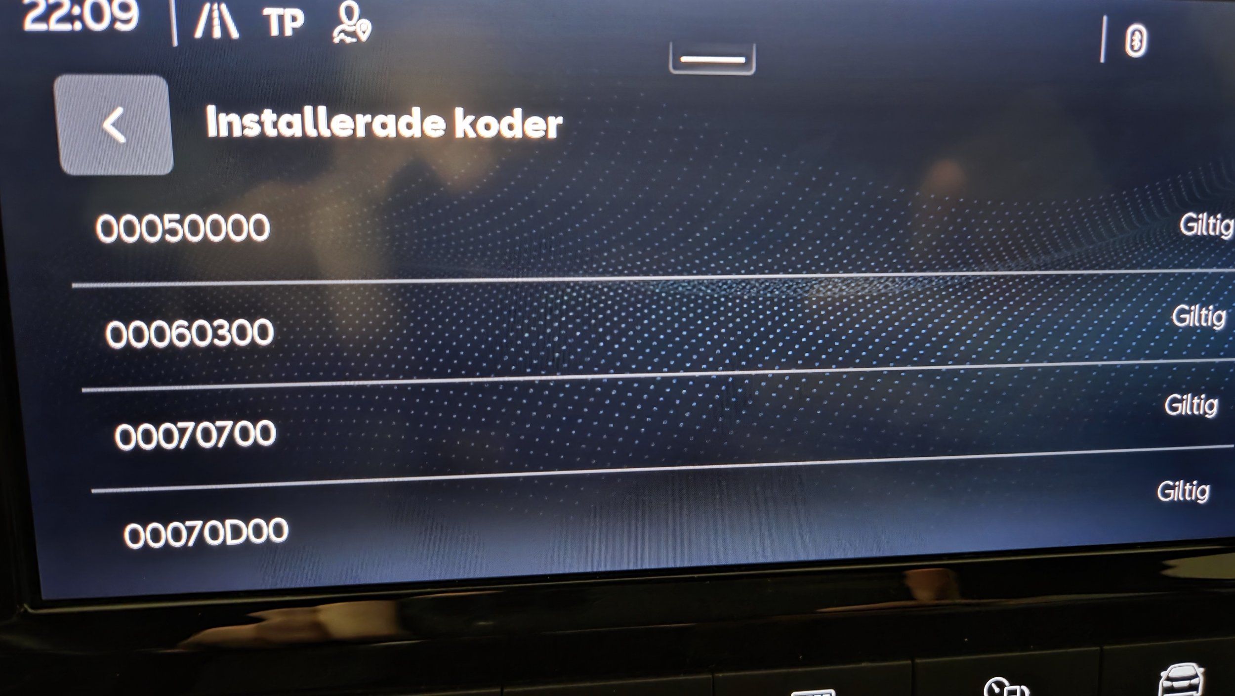

Here is all the info from my unit. Start the car press and hold the car button for 10 seconds and you will find the menu. Then compare the active "swap" numbers, if yours is the same, then you should be able to enable AA with obdeleven.

Well in this case I think they just forgotten to activate AA. If he has the same swap codes activated as I do, in theory it would be just simple an obdeleven activation of AA.

If the unit doesn't have AA/CP, it's unlikely to have the necessary licenses installed

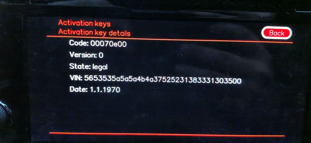

For MEN3
00070D00 is Carplay
00070E00 is android auto
00070700 is wireless AA/CP

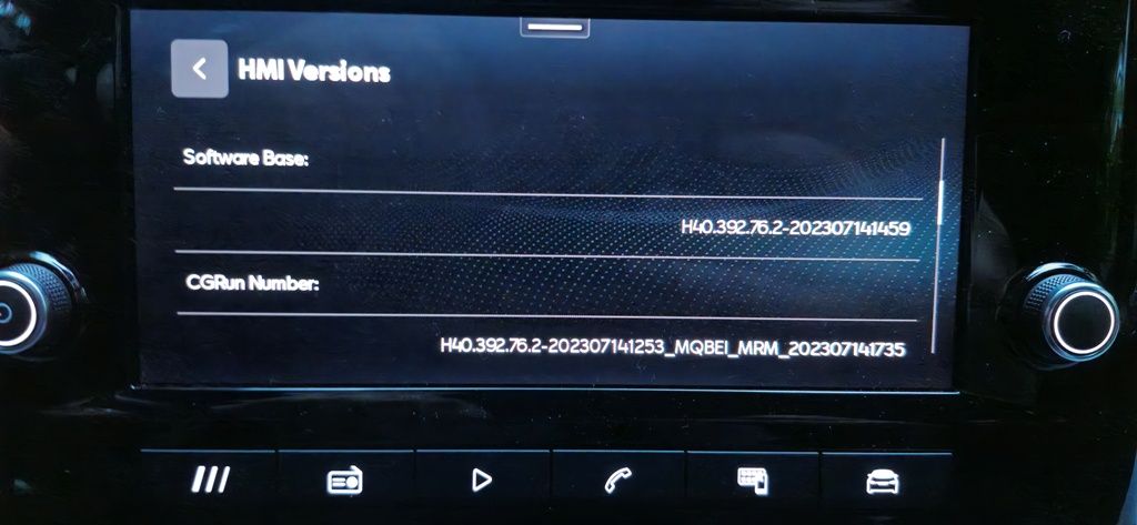

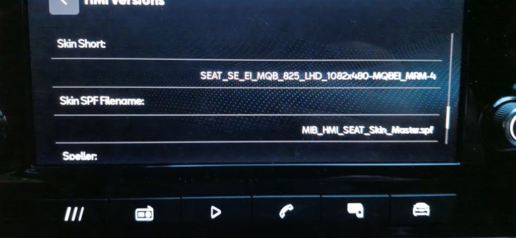

Thank You all for the time and the replies. Sorry for my late response, it's been a busy day. I have attached a few images i took from my infotainment. As I understand (from your previous answers), the device supports cable android auto.
Also, once again, I would gladly pay for the activation in my local dealership, but because of the misbuild, they claim that the device doesn't support it and that i shouldn't waste my money on it.

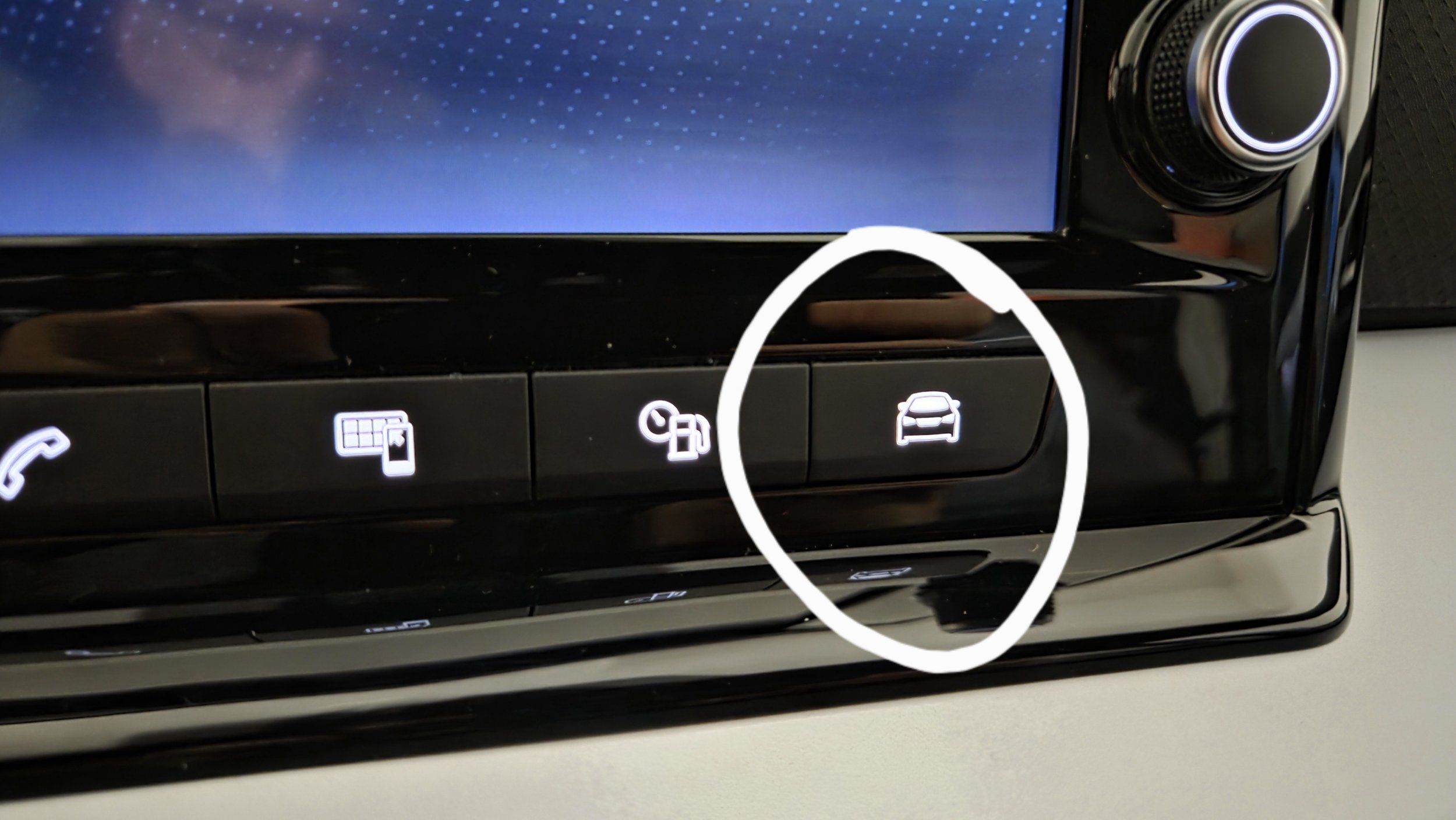

@Jokke our devices seem to be different, I am missing the button on the left of the car button on your photo.
