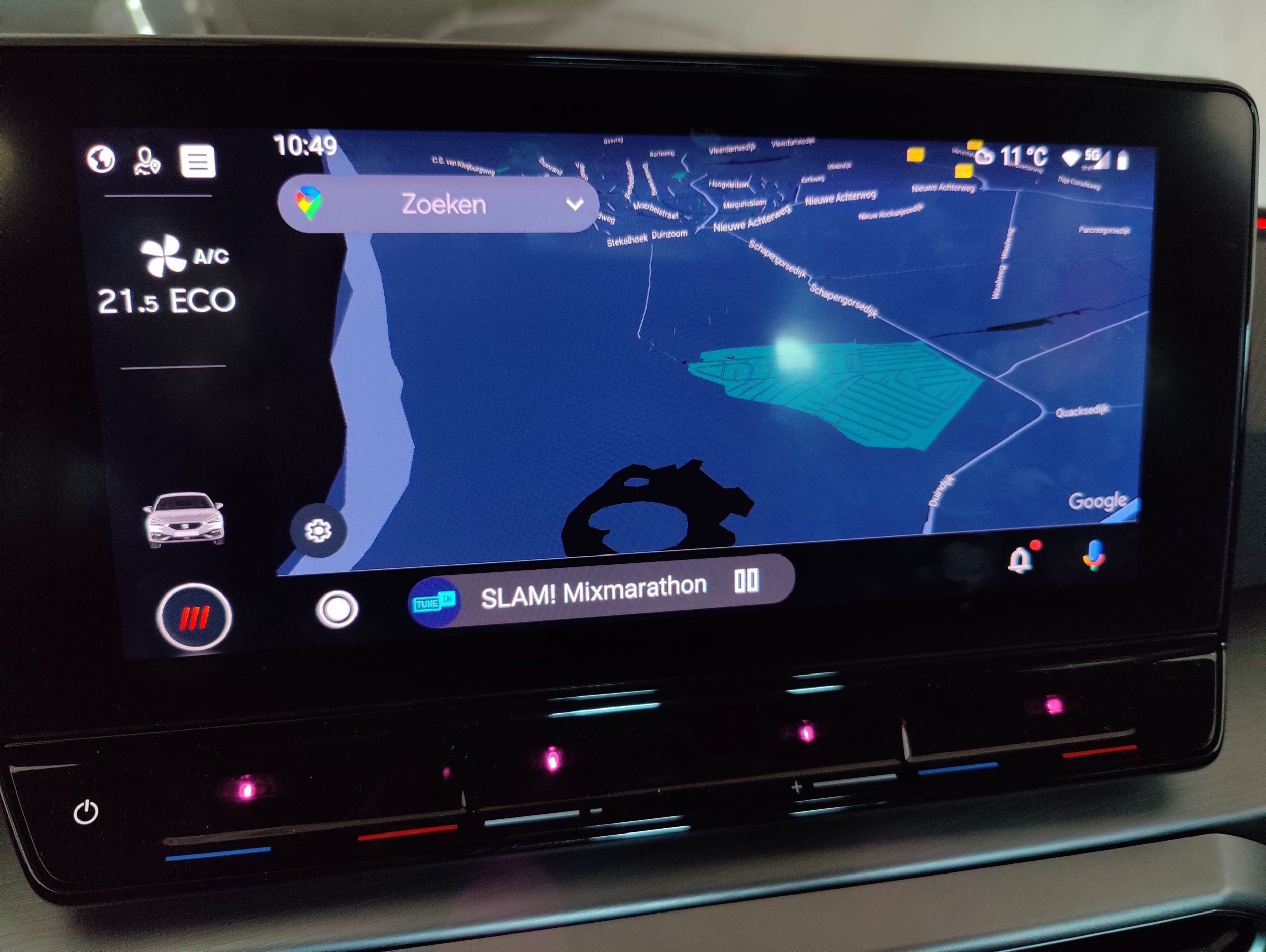

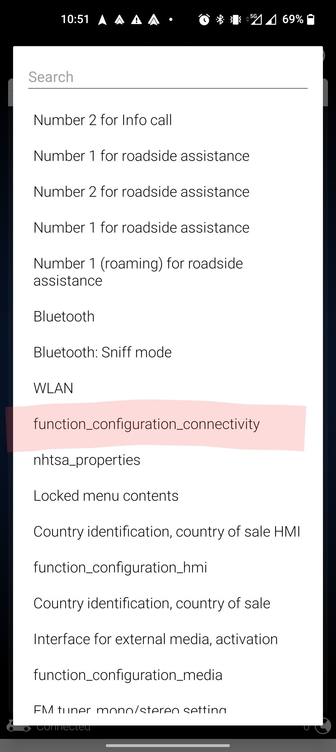

Android auto working over the air!
Module multimedia-adaptions
I did put the red markings to on instead of USB-only.
