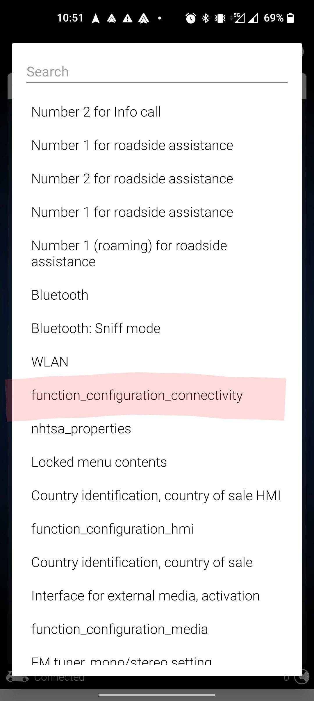

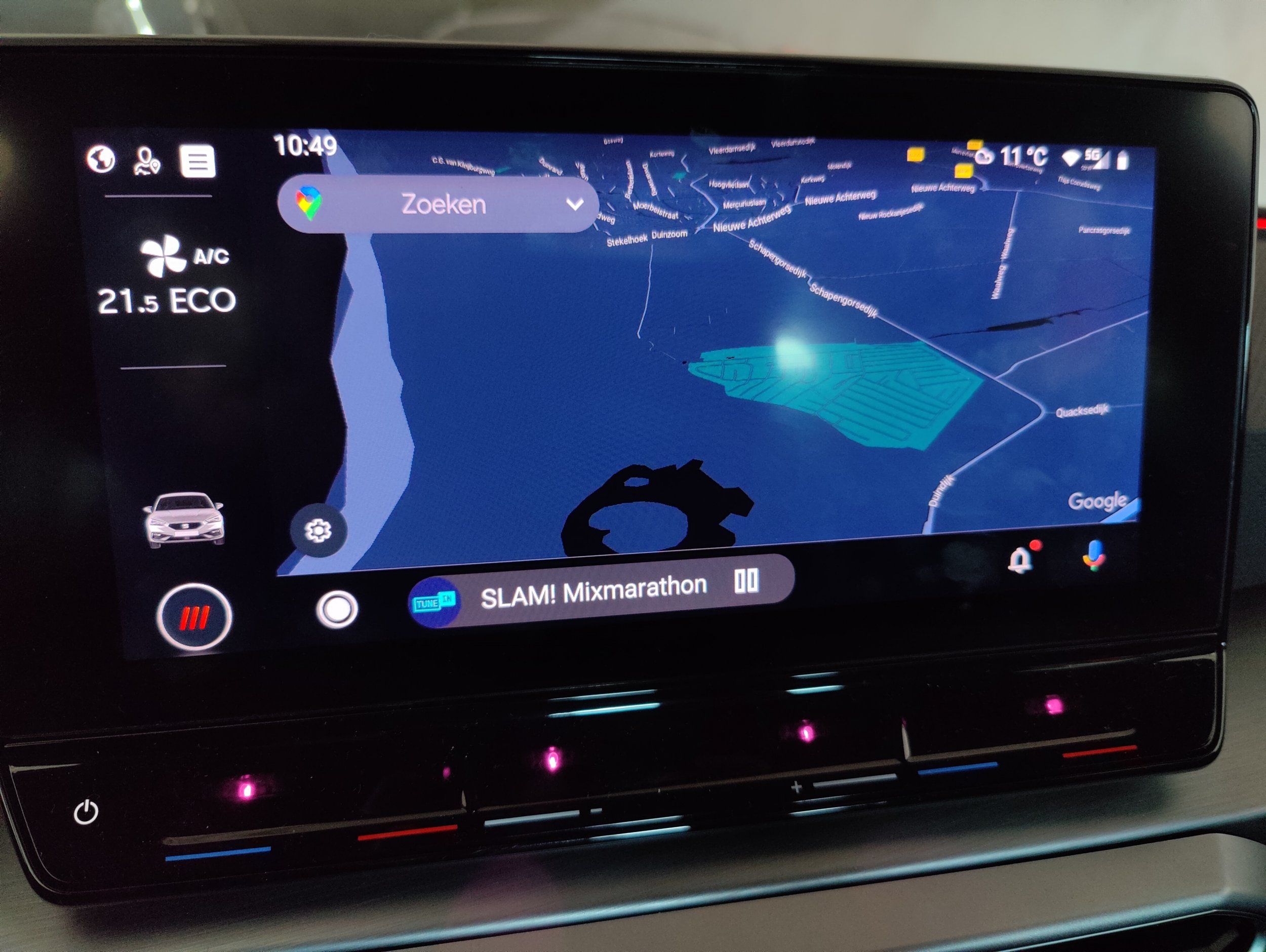

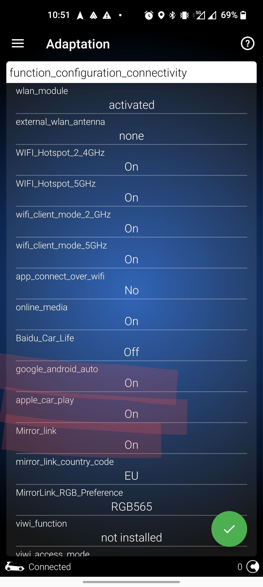

To anyone looking to activate full link/ mirror link. My local retrofitter says it's not possible to aquire keys to do it anymore, because seat is looking into selling this function themselves in near future. We must brace ourselves with patience and hope it's gonna be sooner than later.
