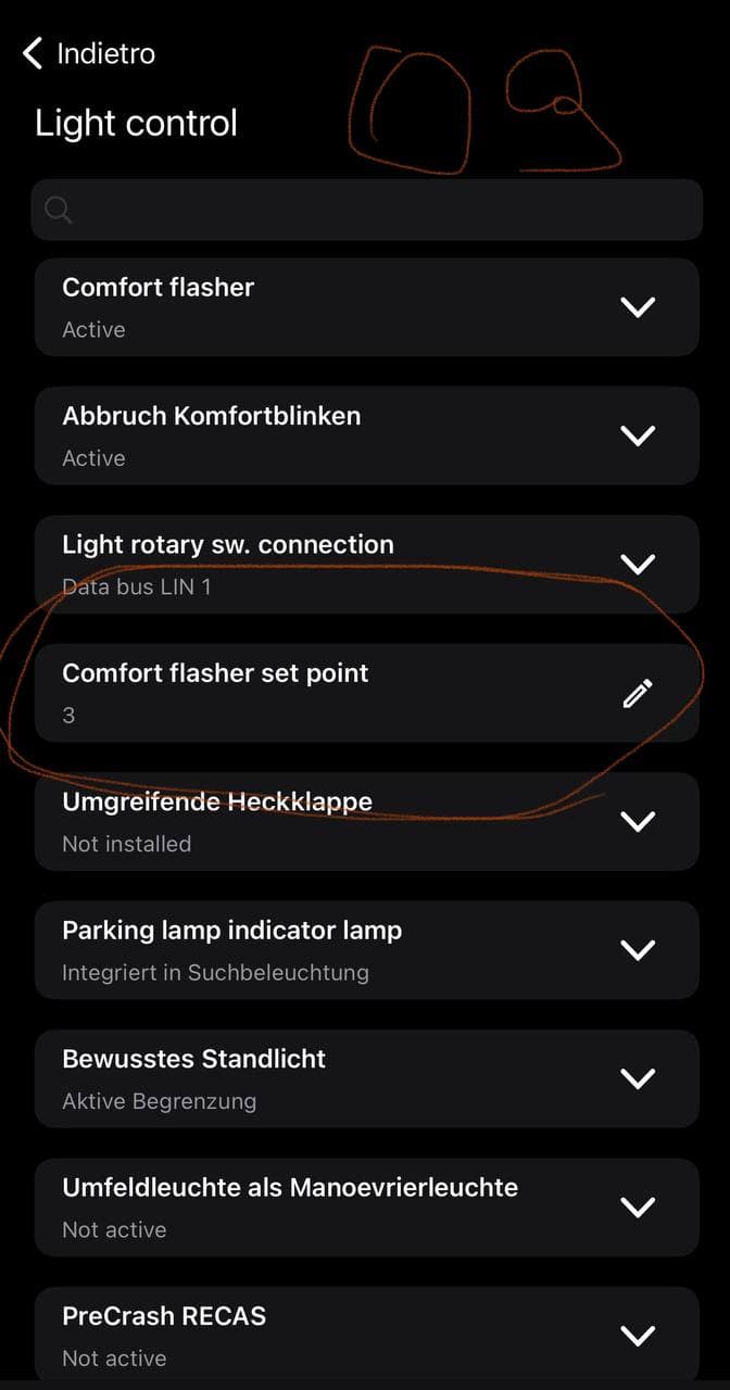

Mine is a Cupra Leon but strangely OBDeleven detected it as a regular Leon. As in it showed an image of a regular Leon instead of a Cupra Leon.
I have the pro license and is comfortable to do coding manually if guided to the exact modules to make those changes. Have done a couple that was shared here.
Would definitely appreciate if you can guide me in the right direction.

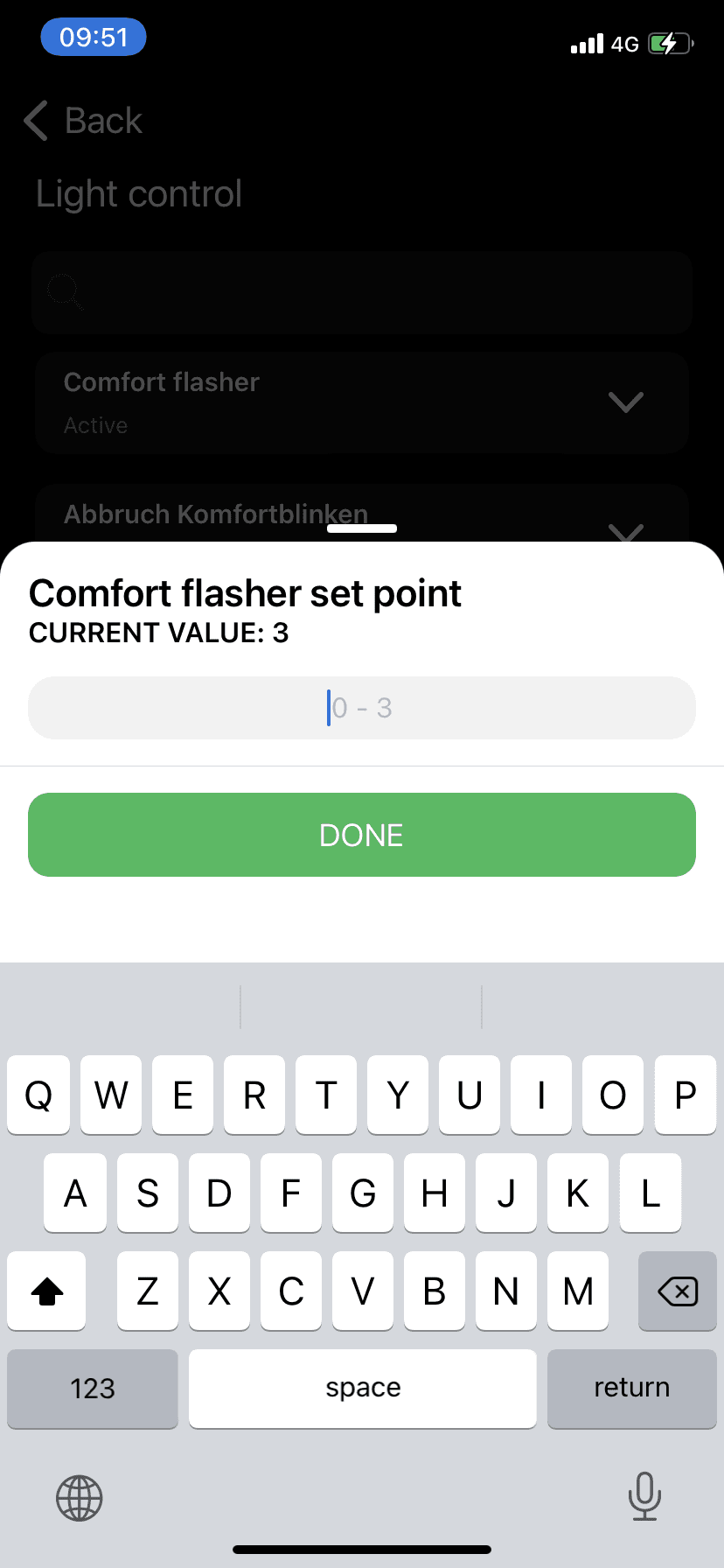

Find out how to change the comfort turn signal in the control unit 09
light control adaptation.
on my leon the numbers are from 1 to 3 but they are not editable

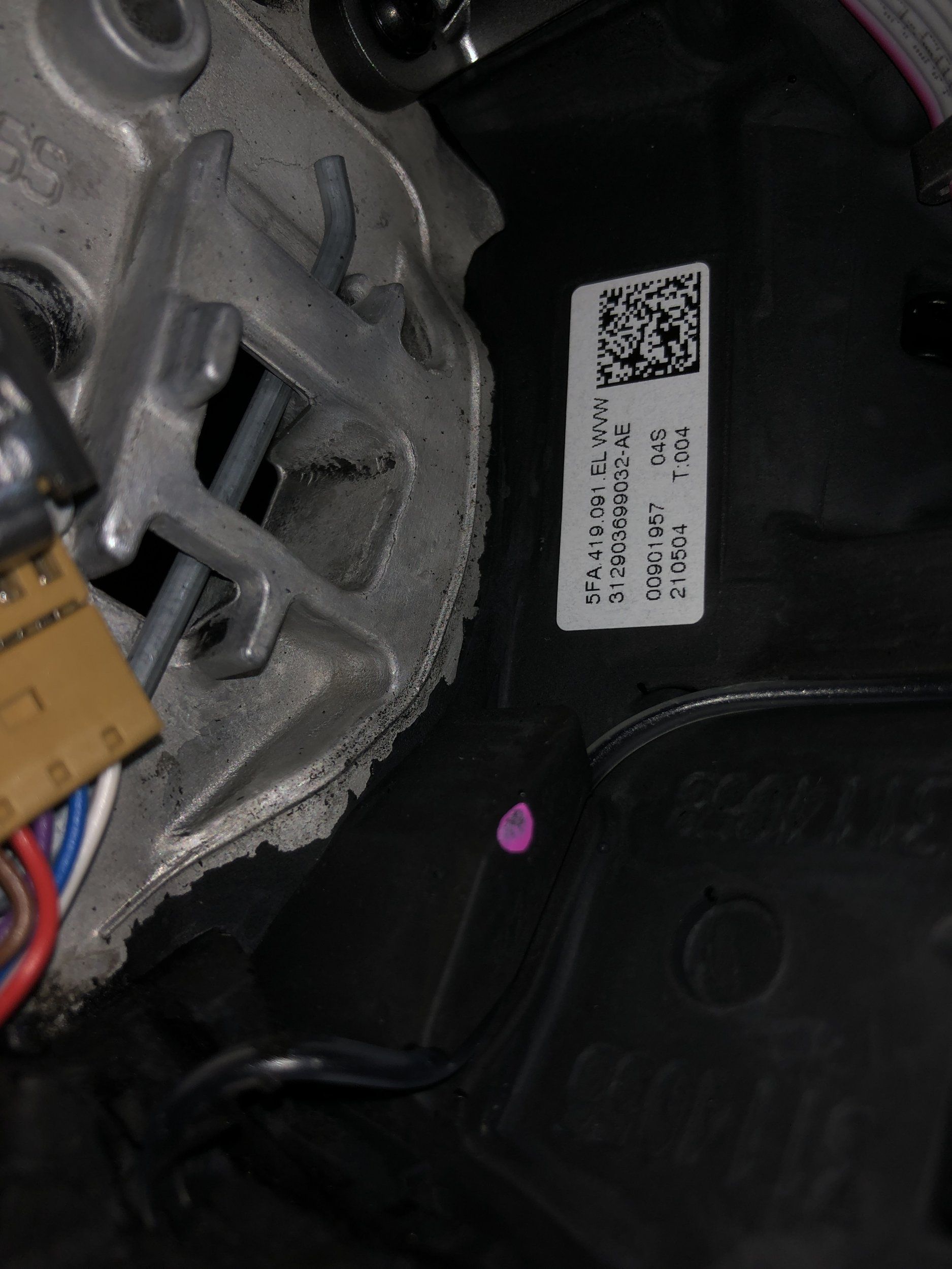

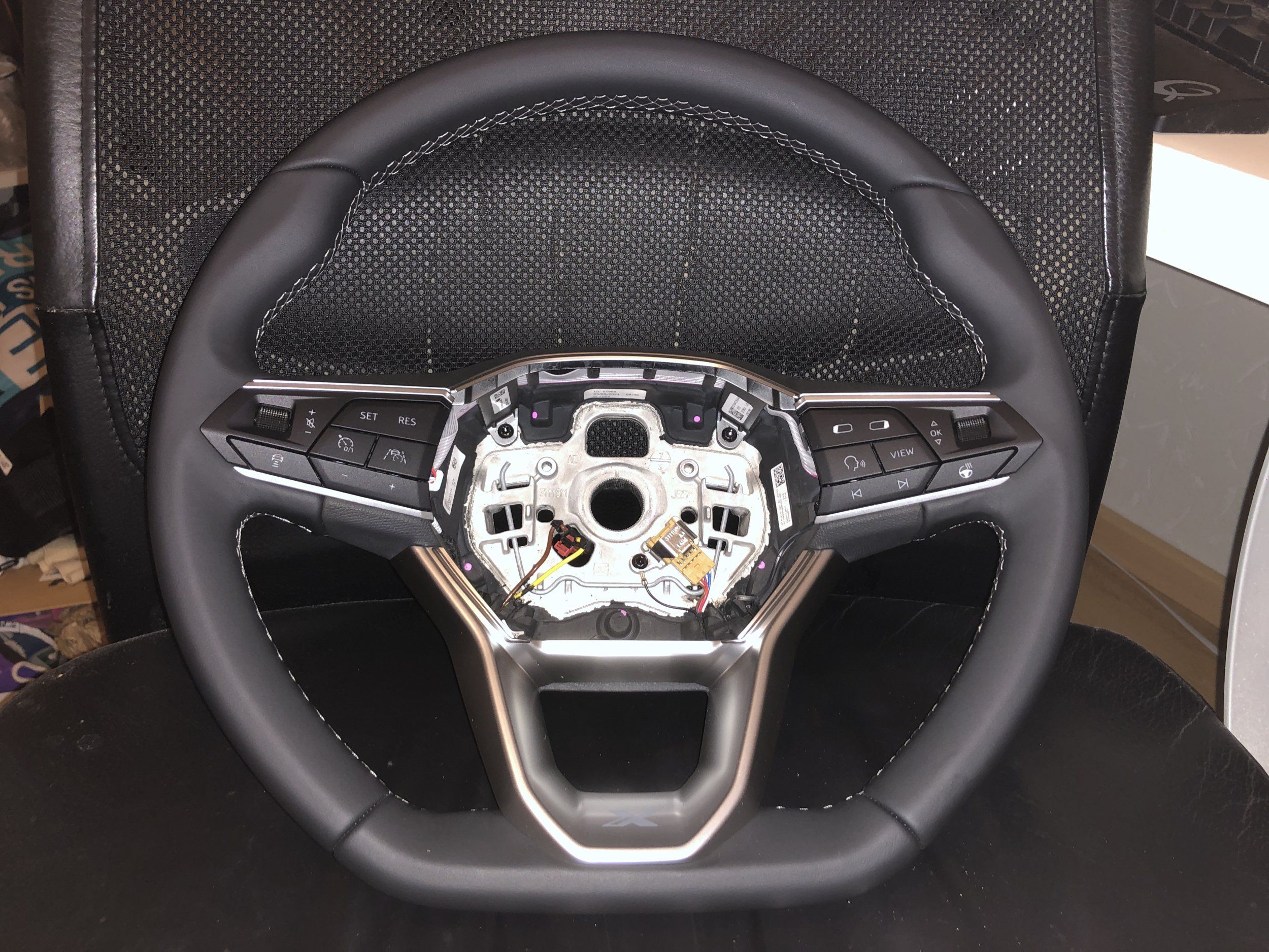

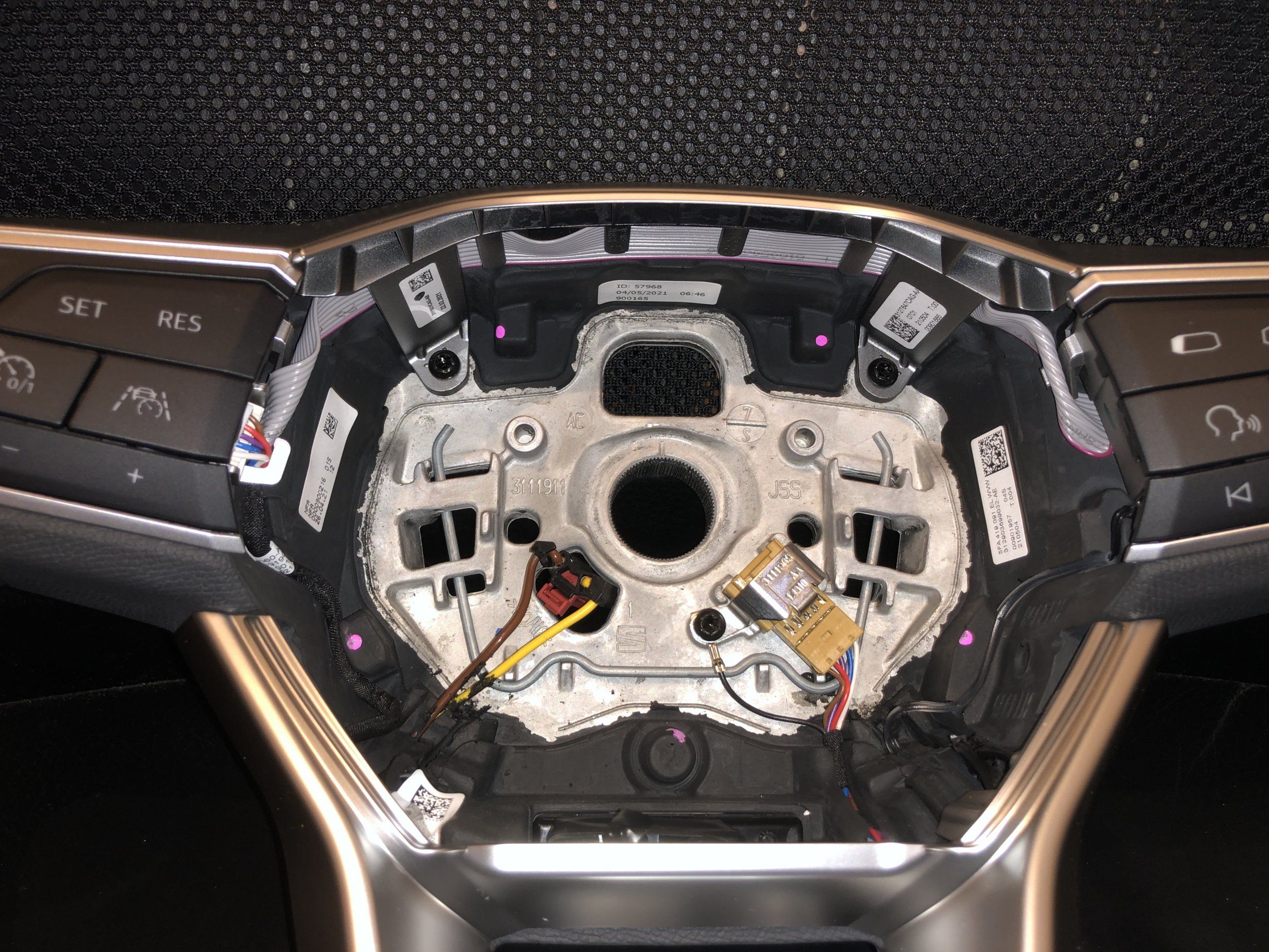

Finally got my capacitive steering wheel for TA retrofit.
Will install it wednesday. Let's hope it works with manual gearbox :)
Congrats man! I've been looking for a capacitive steering wheel for quite some time now but can't seem to find any, where did you get yours? Btw, would be awesome if you could make a video of the DIY installation, there are many ppl on this forum and others that still dont have 100% clear how to install it (including myself). Enjoy it!
Code all and it works i think. Need only fast changing gears. Mqb you got 1 or 2 sec to change iff longer it shuts off.
Keep us posted
@davidgballester
Here is my manual for removing the steering wheel
  • Manual retrofit Capacitive Steering wheel for Travel assist.pdf
