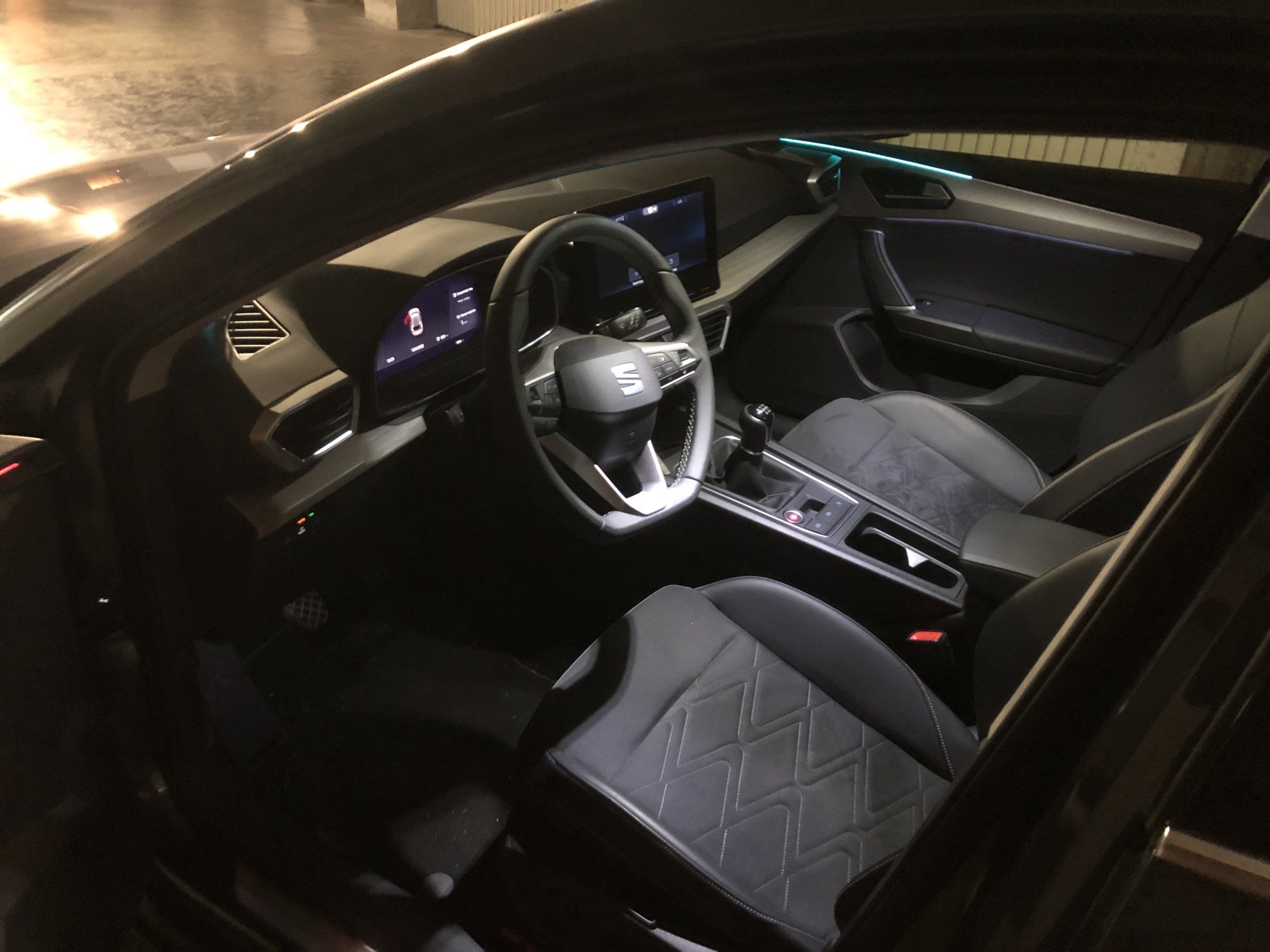

Tested today with my new steering wheel, works perfectly. So manual gearbox and TA is 👍
TA is really cool on Freeway. Thanks to Zoidberg and others who found the right coding :)

Also, you can see that my travel assist display is like the one Zoidberg has, contrary to Antera.
