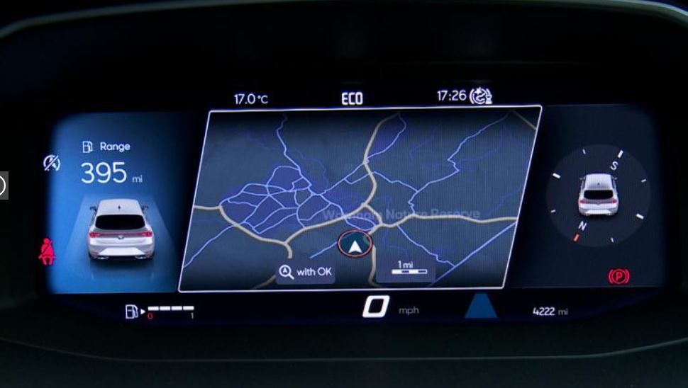

hello,
in internet I have found this photos, range with the blue backgroud but navigation with the black backgroud. Someout have this set up? I have blue backgroud for both the 2 lateral screen. Thanks.

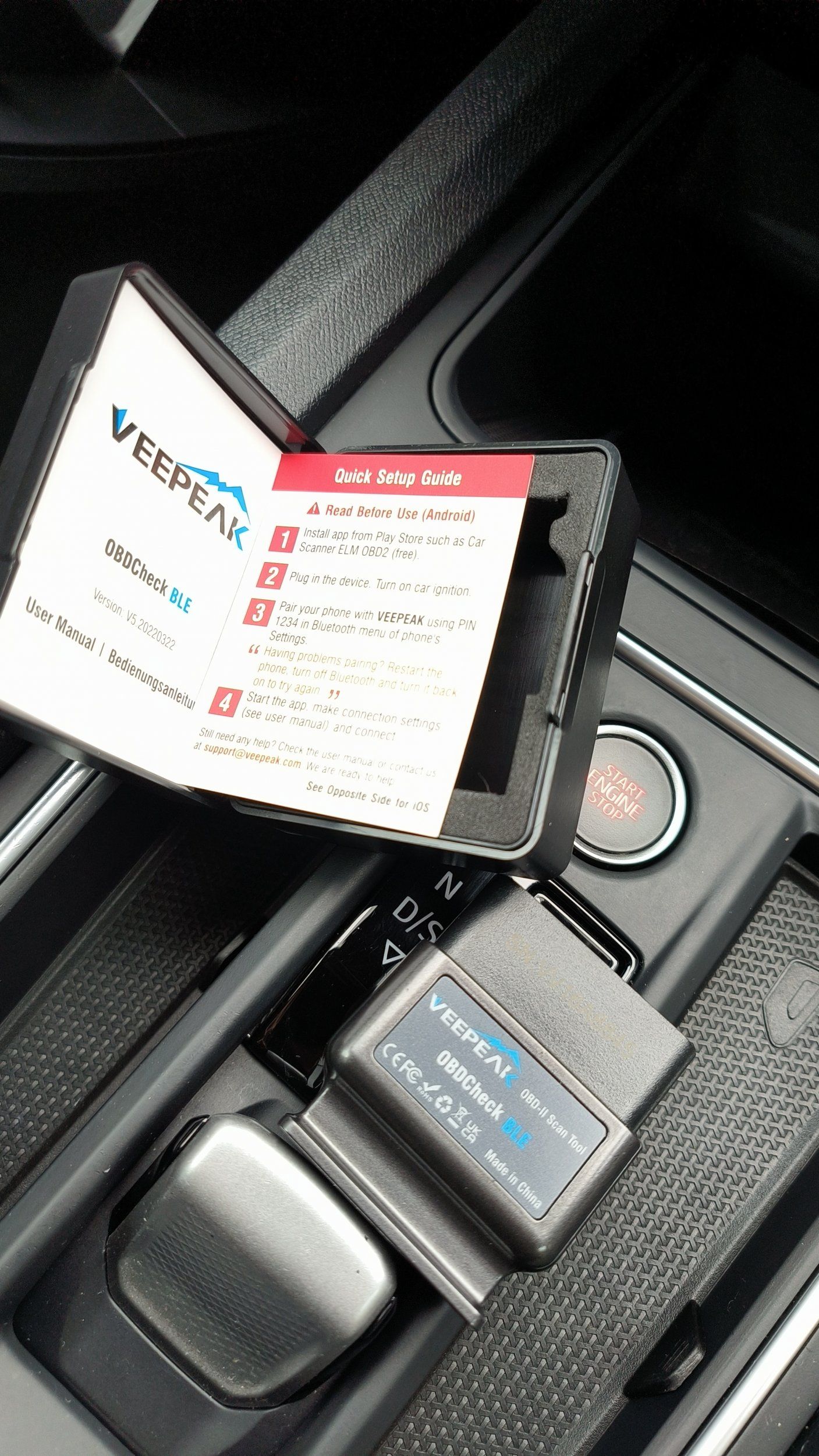

I have this Vee Peak scanner from my previous Mini Cooper that I used to makes some changes. Is there any VAG/Leon software I can use it with?? Like to change the rear bar to be on all the time like I did with my Mini Union Jacks LEDs

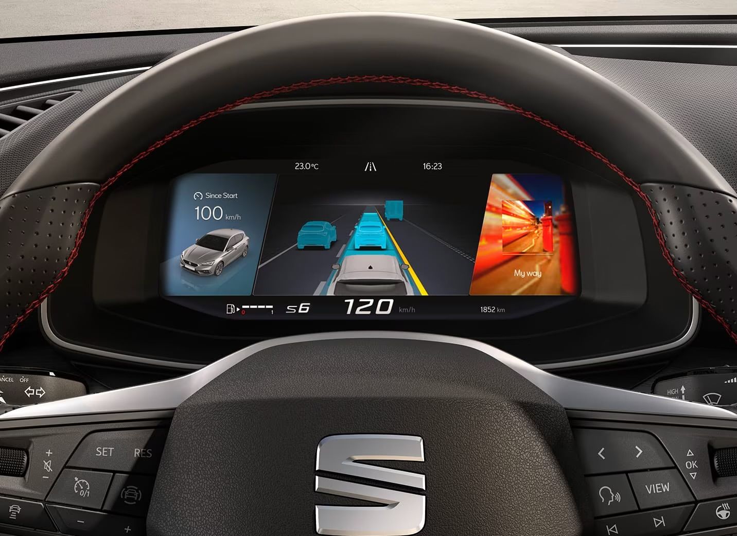

Is there a way to get the same dashboard display that Travel Assist gets without Travel Assist, where you can see the vehicles around you? I don't worry too much about functionality, it just looks great.
Good evening, it is possible to see this screen on the display without having the capacitive steering wheel, thanks
