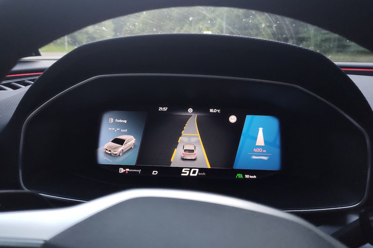

Well, I'm happy to prove myself wrong, Travel Assist can indeed be coded with OBD11, if you have the necessary hardware. I picked up a new steering wheel with the TA button from a seller on eBay and after fitting it (which was a bit of a PITA), the coding part was surprisingly easy. I picked up a few clues on various forums, but was still surprised to pretty much nail it first try. I now have a fully working TA, including lane assist below 40mph and the extended assistant view with multi-lane traffic and road curves :D
Even with the capacitive steering wheel, I still get the "takeover steering" warning once in a while, but it's definitely not as often as before.
View attachment 26144 View attachment 26145
So the key piece of hardware for this to work is the capacitive steering wheel, without that you're getting nowhere. I'm not really sure what else is required, my car came with DSG, front assist, side assist and park assist from the factory and I'm assuming that at least front assist and maybe DSG is required for the full experience.
So for everyone else who might be interested, here are my settings:
Control unit 13, Adaptive cruise control:
Control unit A5, Driver assistance:
View attachment 26146 View attachment 26148
