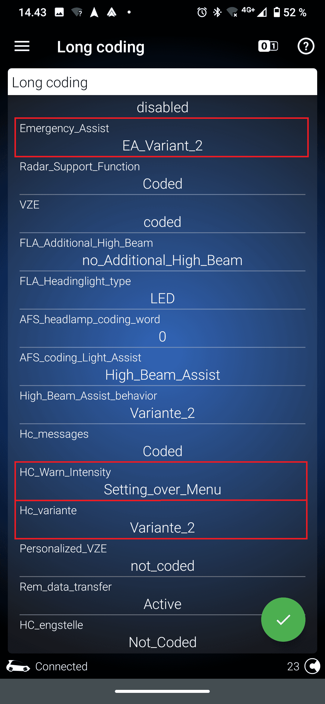

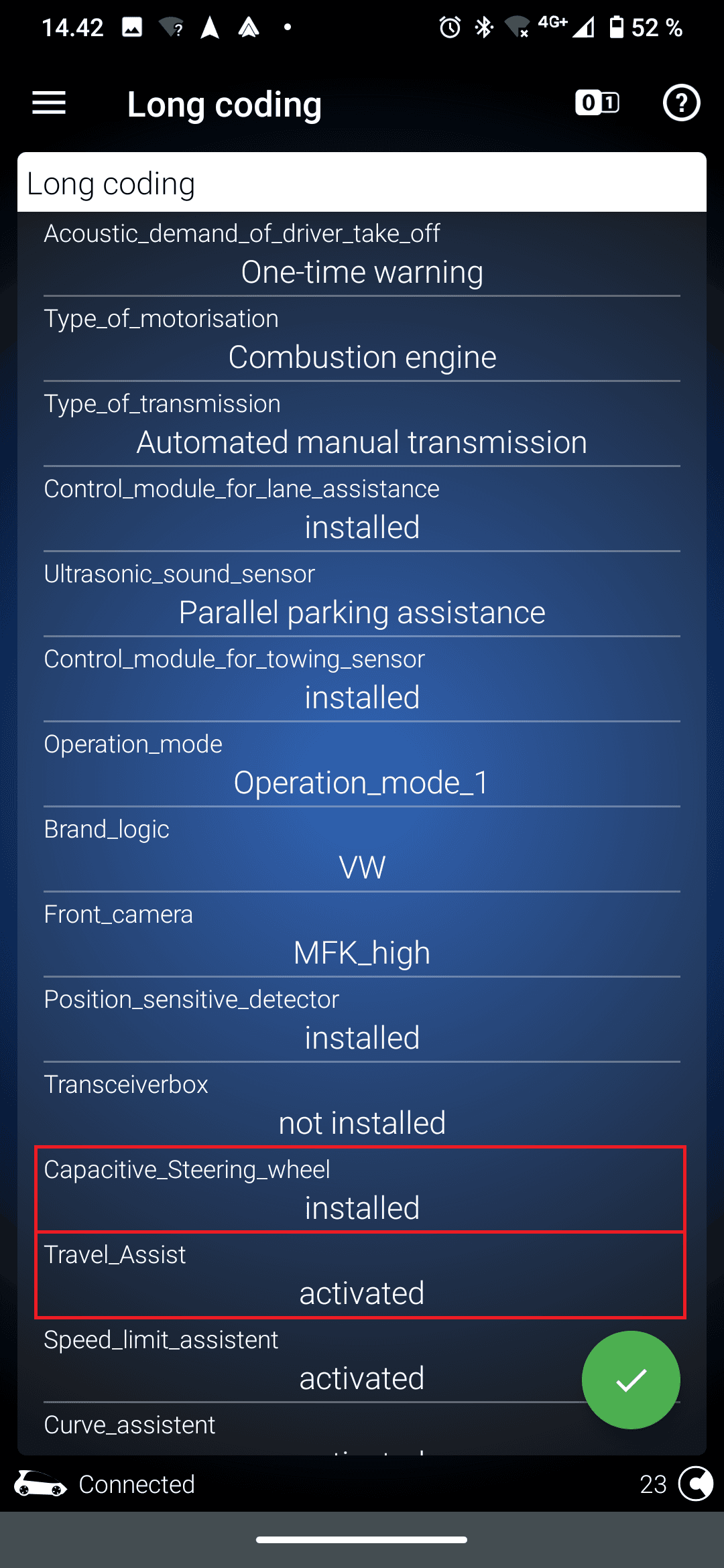

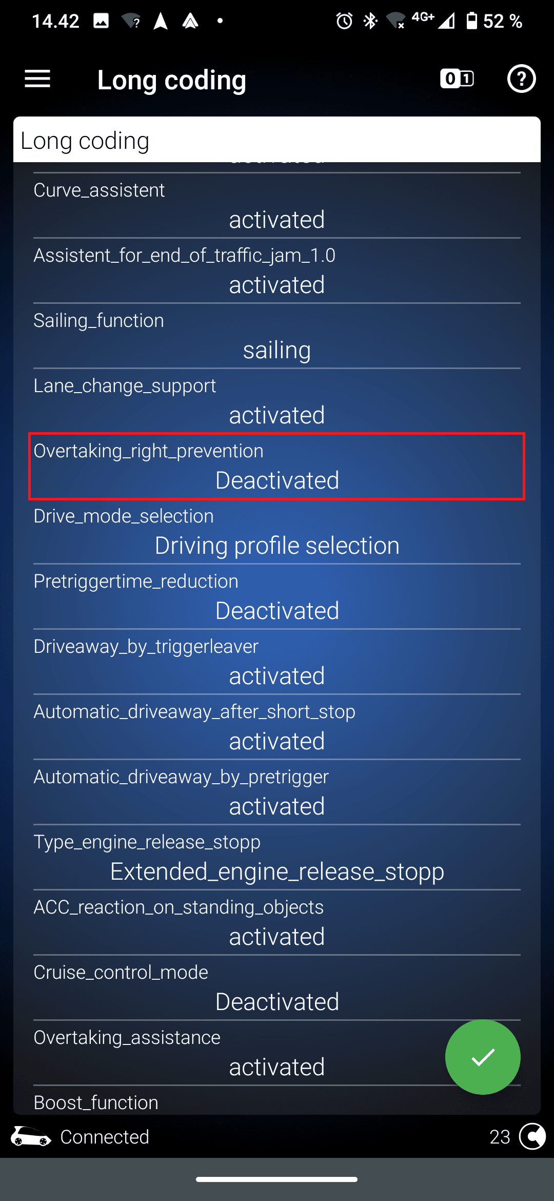

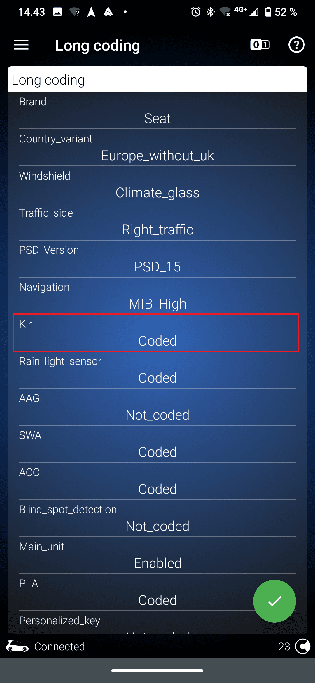

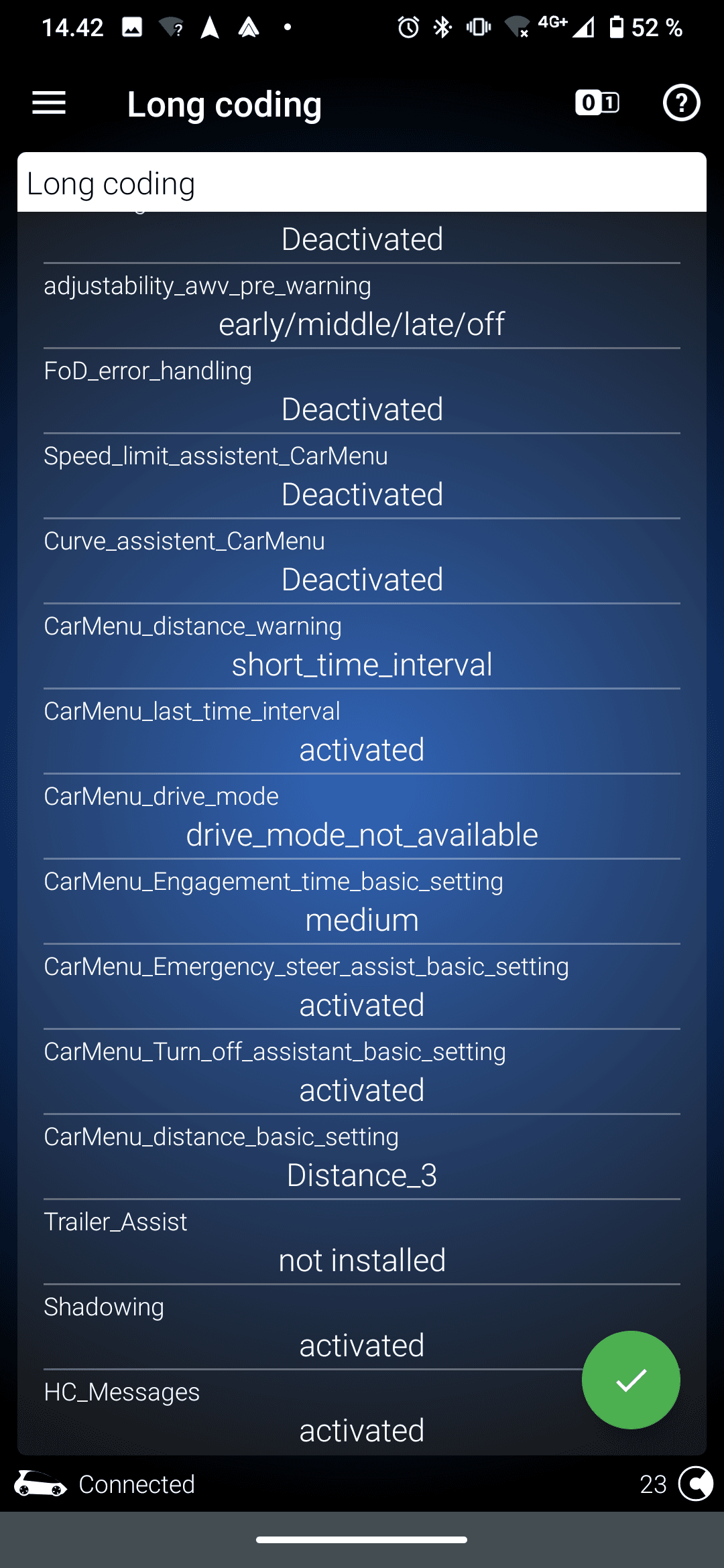

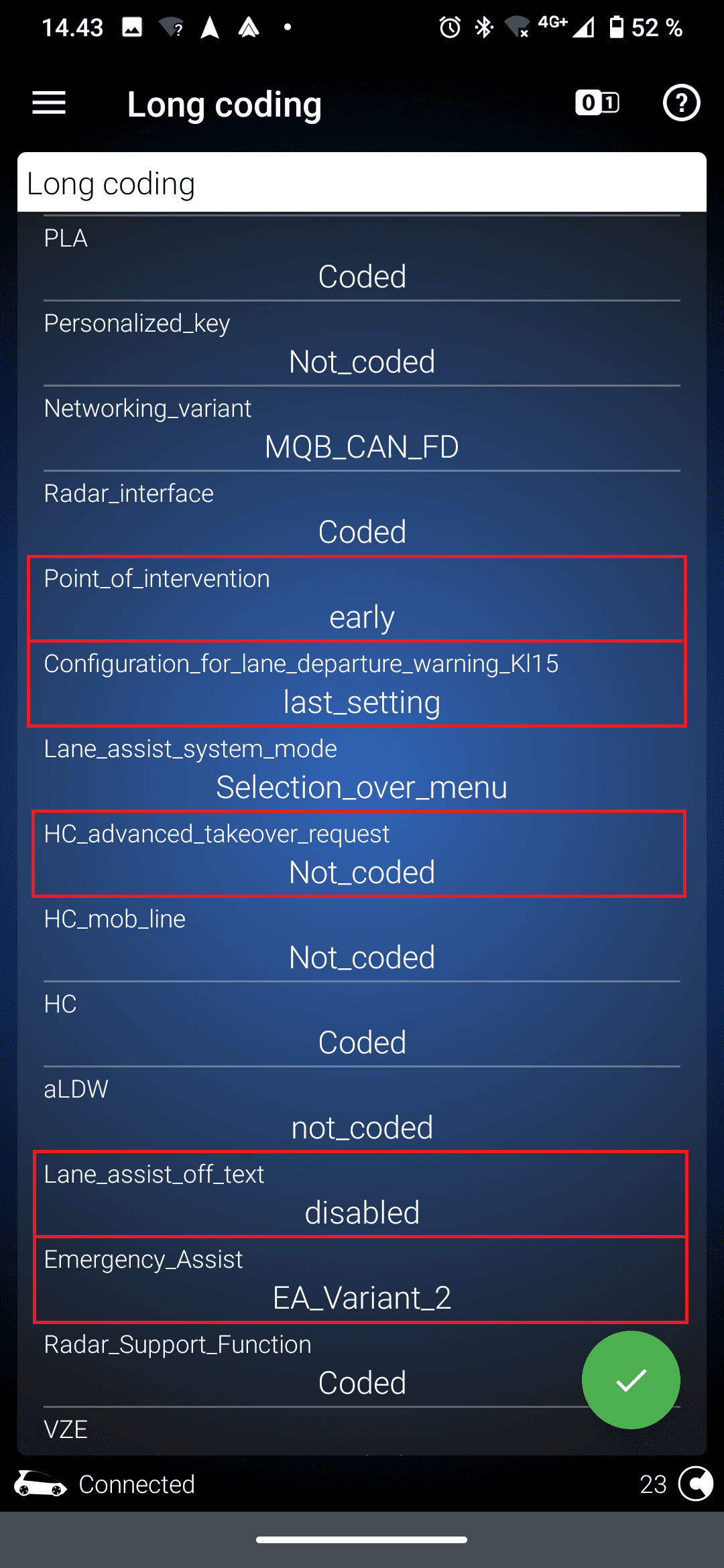

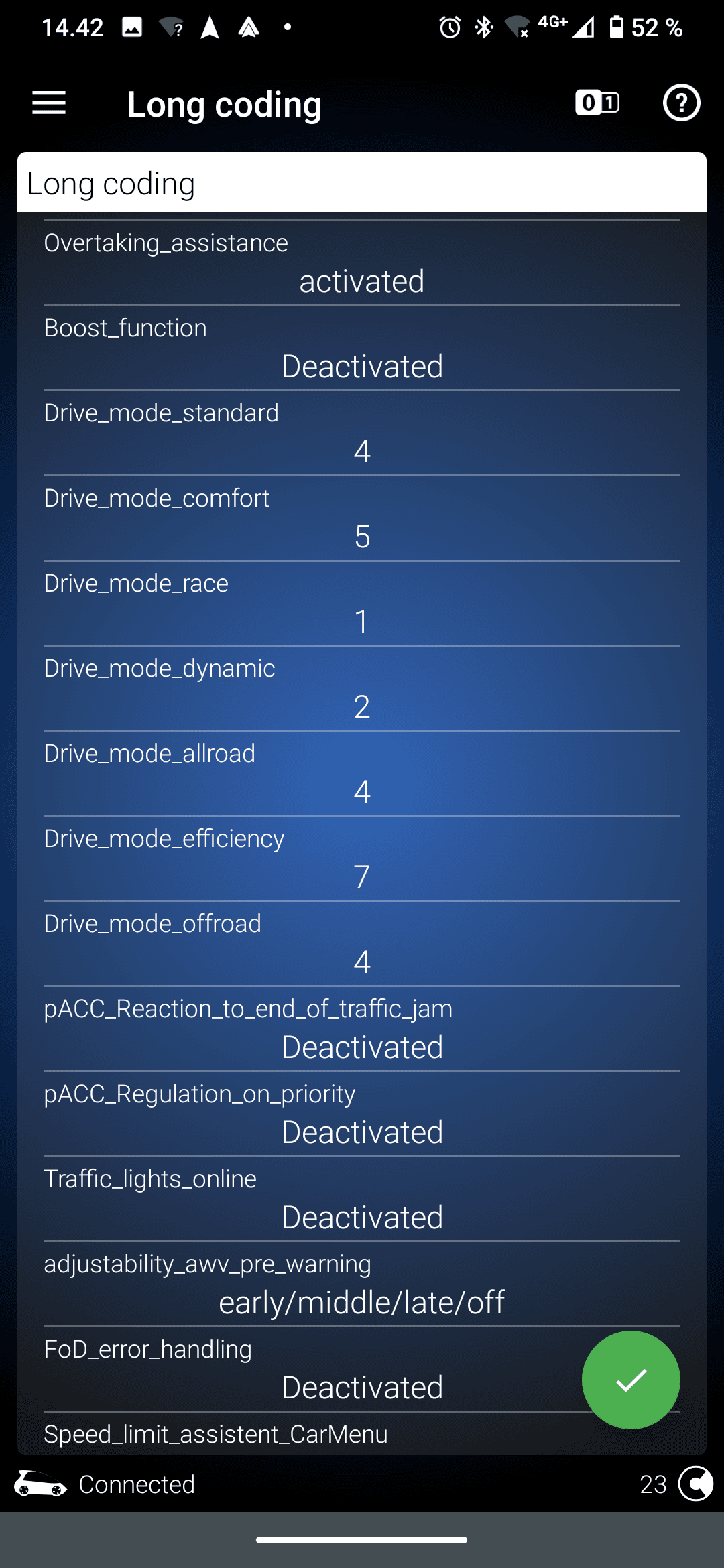

Here are my current settings, the ones in red are the ones I have changed. I have no idea what "HC_advanced_takeover_request" does, I coded it before "Klr" and it didn't seem to have an effect, so just left it like that.
Control unit A5:
View attachment 26986View attachment 26987View attachment 26988
Control unit 13:
View attachment 26989View attachment 26990View attachment 26991View attachment 26992
Hello,
Do you have the option 'Travel assist' in the menu after 'assistants' button in the infotainment system?
Which option do i have to enable/change to get it in menu? I already have travel assist activated.
Thankyou

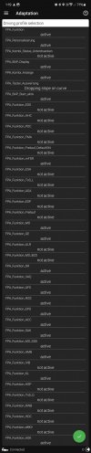

I forget where this screenshot is from, but I think it might be gateway module 19 adaptations (not long coding)? I took it yesterday so apologies if it’s the wrong screen. The settings on this page are default from Cupra - anything here look like it could disable coasting? FPA function freilauf and FPA function freilauf defaultON were set to ‘not active’ from the factory, yet it still coasts/ sails..
