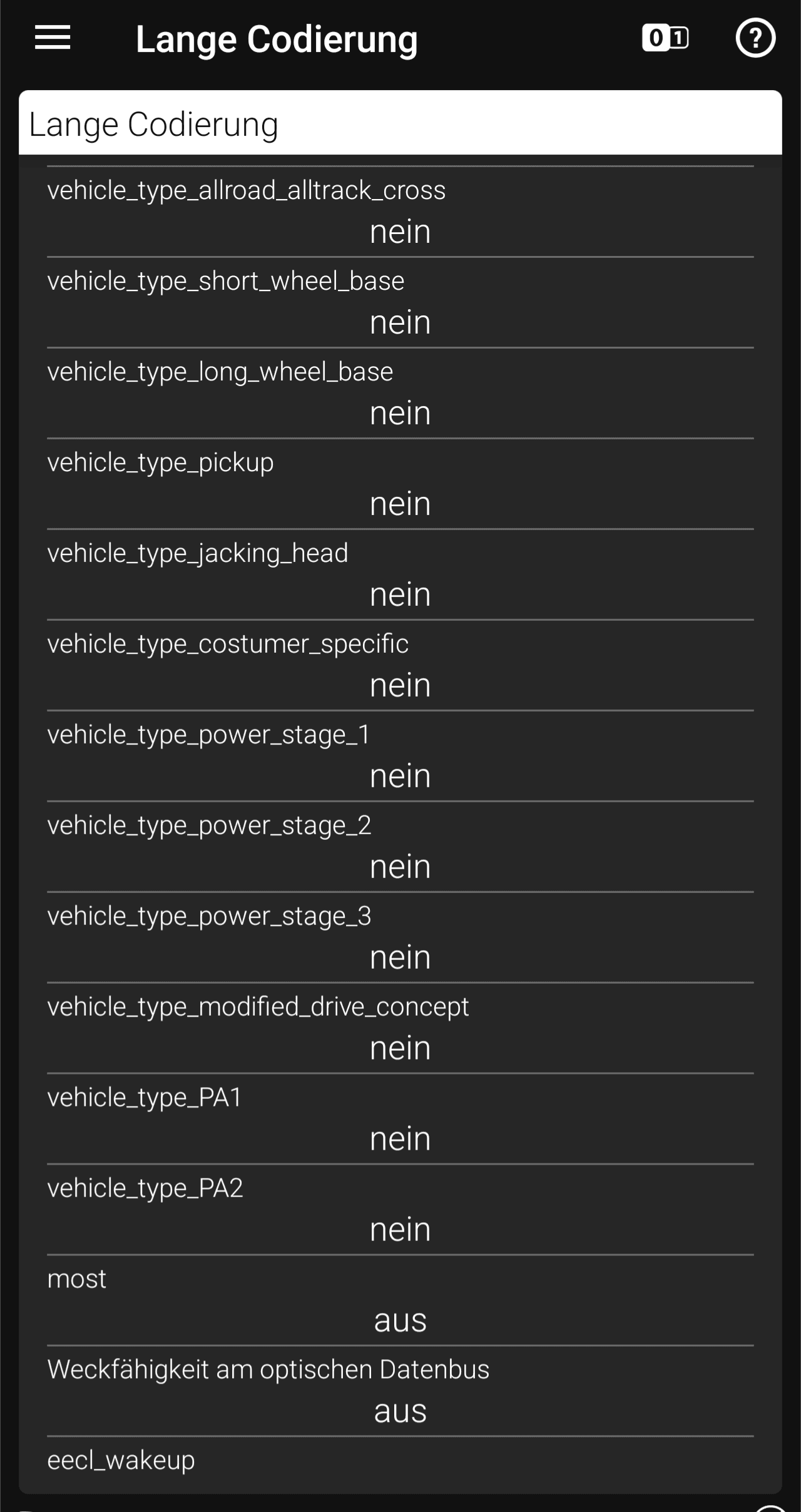

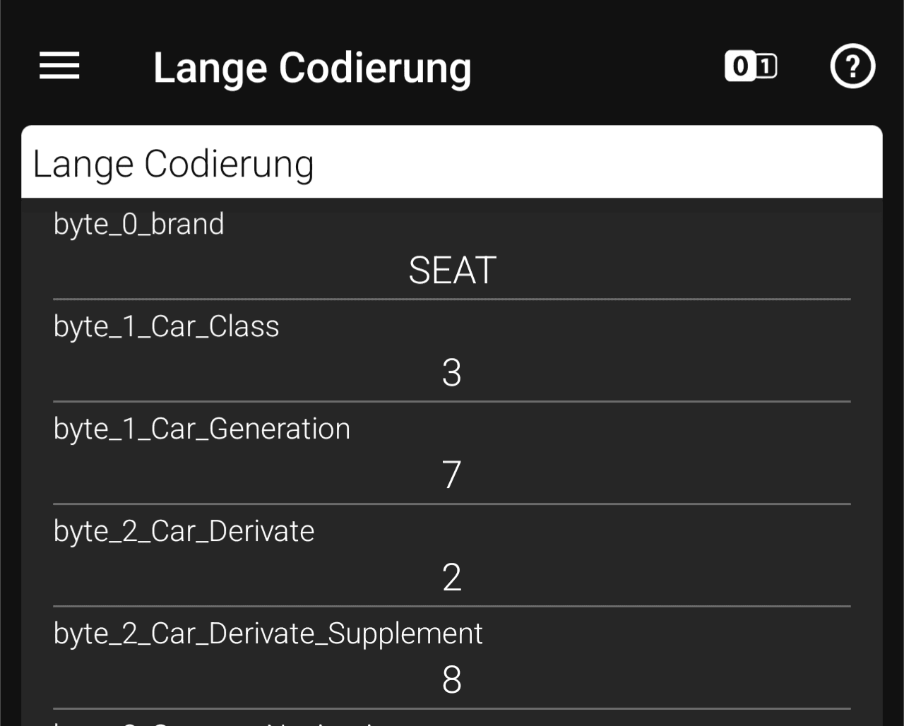

Hello, I have a question: below the values to set the screen to cupra view. I like it but I want to return to normal FR. Someone has the Fr value?
Select Multimedia 5F
- Select Long coding
- Select Car Bodystyle addition
- Set to 1
- Select Vehicle type power stage 2
- Set to Yes
- Select Adaptation
- Select Function configuration hmi
- Select Skinning
- Set to 2
- Select Screenings
- Set to 1
Thanks in advance.
Stefano
cairus
Jun 4, 2024
1,672
588
Facelift FR ST

cairus
Jun 4, 2024
1,672
588
Leon model year 21 but not sure if it is an FR
