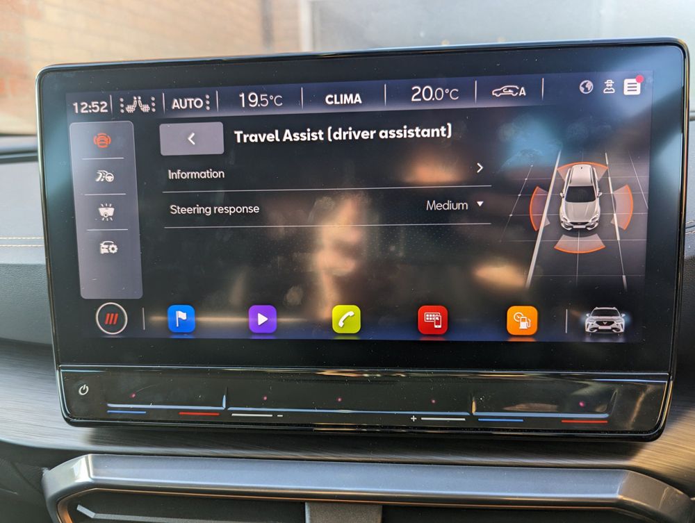

Hello everyone. I think every Seat is coded differently. I drive a 2021 Seat Ateca and would like to retrofit travel assist. I can install the steering wheel myself, but I can't code it. Can someone please help me? Thanks.
