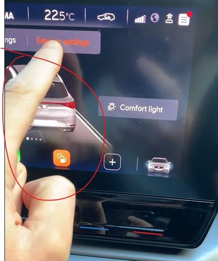

control unit 5F
- Select Adaptation
- Select Function Configuration hmi
- Select Skinning
- Set to 2
- Select Screenings
- Set to 1
Could you please help me with the stardard value for these fields? I can't see the car image in the settine g screen on the multimedia central screen. Thanks in advance.
