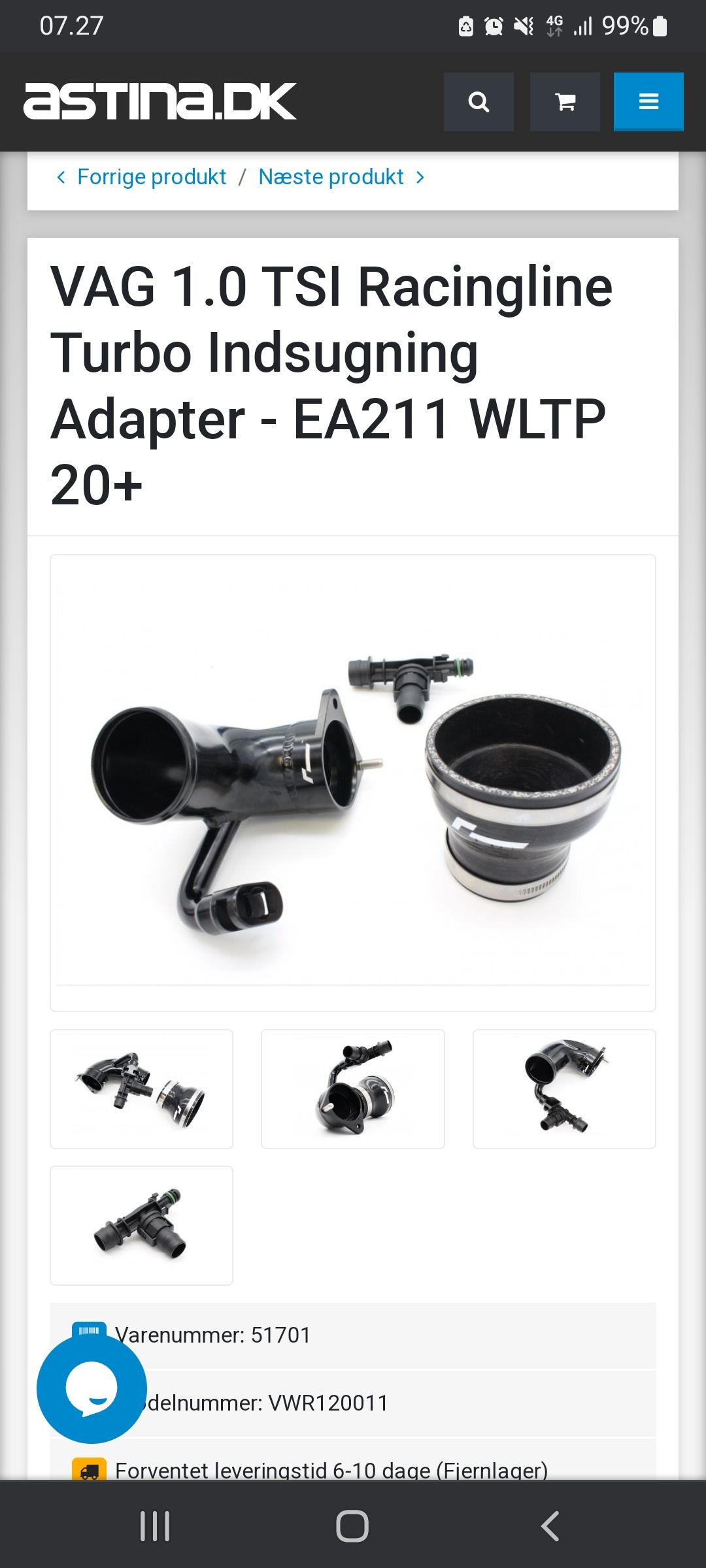

Forget the coding, the infotainment system has it. Start/stop has about 10 or more thing that should be in place for it to work. Temp, electrical consumption- ac/ seat heater and so on. Get a new 'Raceline turbo hose ' and you have a hot hatch
The 2020 & 21 model FR ( motor code DKR ) have the codings in the infotainment system. The best ibiza mk6 made, specially with manual gearbox. DSG is very good but it has it flaws, brakes tends to stuck cuz auto gear supports motorbraking. If you change the air hose ( 120€) to turbo and you have a beast of car 7,9 sec. to 60. Much better than the new sport fr ( only with DSG) and the 1,5 wich was kind if a experimental car with s many flaws. I rattles in the hole car when acc turns on ect and had all signs of a bad build. Try it and compare to the 1.0.
Hi. Just wanted to ask what car you're referring to with the turbo hose (which engine size)? I've got an intake with an aftermarket pipe to the turbo and it seemed to make less power than stock. (This was alleviated with a tuning box though).
The 1.0 115hp. Hose without restrictions.
In sport mode 8 sec to 60 easy.

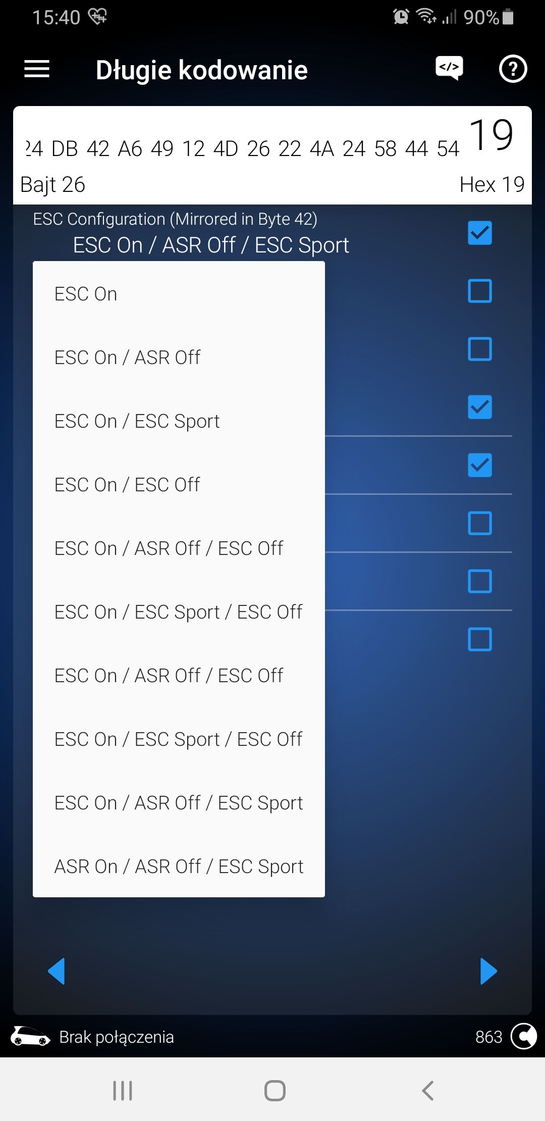

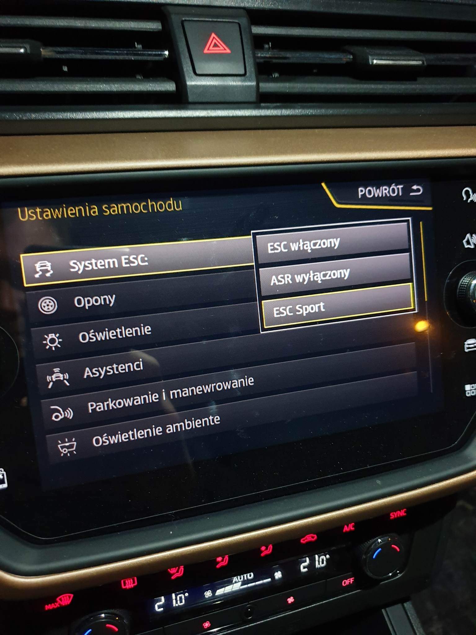

Coding of various ESC settings (MQB A0)
(to be changed in the infotainment system - photo in the attachment)
03 ABS > Long Coding > Byte 26 (Bits 0-3) mirrored in Byte 42 (explanation below available options)
"x1" HEX value of Byte 26 where "x" are the remaining settings in Bits 4-7 < don't touch them - leave them as they are
x1 esc on > Bit 0 active Bit 1,2,3 inactive
x2 esc on/asr off > Bit 1 active Bit 0,2,3 inactive (default setting)
x3 esc on/esc sport > Bit 0 and 1 active Bit 2,3 inactive
x4 esc on/esc off
x5 esc on/asr off/esc off
x6 esc on/esc sports/esc off
x7 esc on/asr off/esc off
x8 esc on/esc sports/esc off
x9 esc on/asr off/esc sport
xA asr on/asr off/esc sport
Byte 26 has its mirror in Byte 42 - you have to change both at once and then save changes
mirror example:
Byte 26 00010001
Byte 42 10001000
if the number of the ABS pump coincides, you will find the described options in obd11 (I added a description of byte 26)
if you think it's worth it, you can add it to the general list of encodings obdeleven for ibiza/arona in resources ;)
Greetings

Thanks mate. What year car did you do this on? I tried accessing via VCDS with no luck, my local tuner tried accessing the module via OBD and said he doesn't know how to get in there at the moment. I have a 2022 Ibiza FR
Ibiza xcellence 2018
it's strange that you can't enter the 03 abs controller. I understand not being able to make changes but not being able to enter is weird
I'll try again tonight and screenshot what happens. I know the ECU bootloader is locked on this model, perhaps these modules are also encrypted?
So if you make the changes in OBD11 does it simply change the menu items in the infotainment?
Also do you know if there is an option in there to disable "straight line running"? I believe it was module 44. What about disabling XDS? (It causes my brakes to severely overheat on the track)
check in obd11 settings if you have automatic sfd unlock enabled. for coding open the front hood. xds encodes in 03 abs but in this case I don't know how
