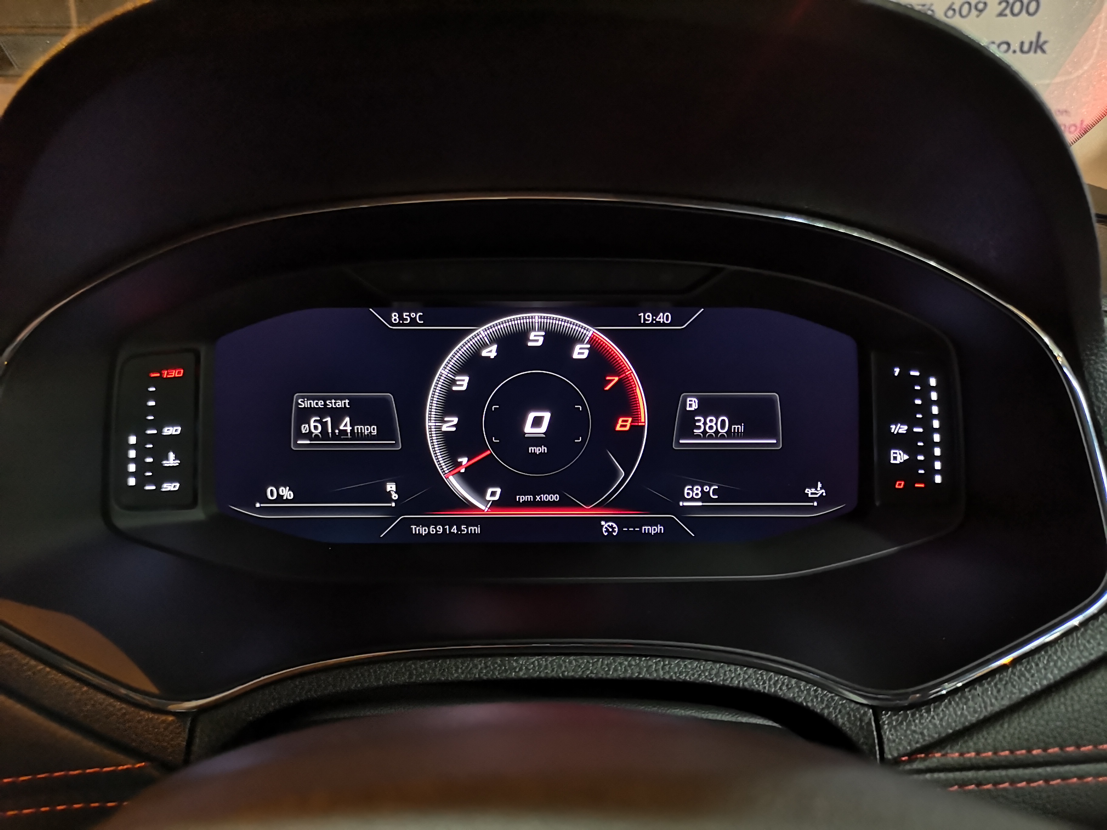

I can confirm the sport dials work in my 2019 Seat Ibiza FR Sport
