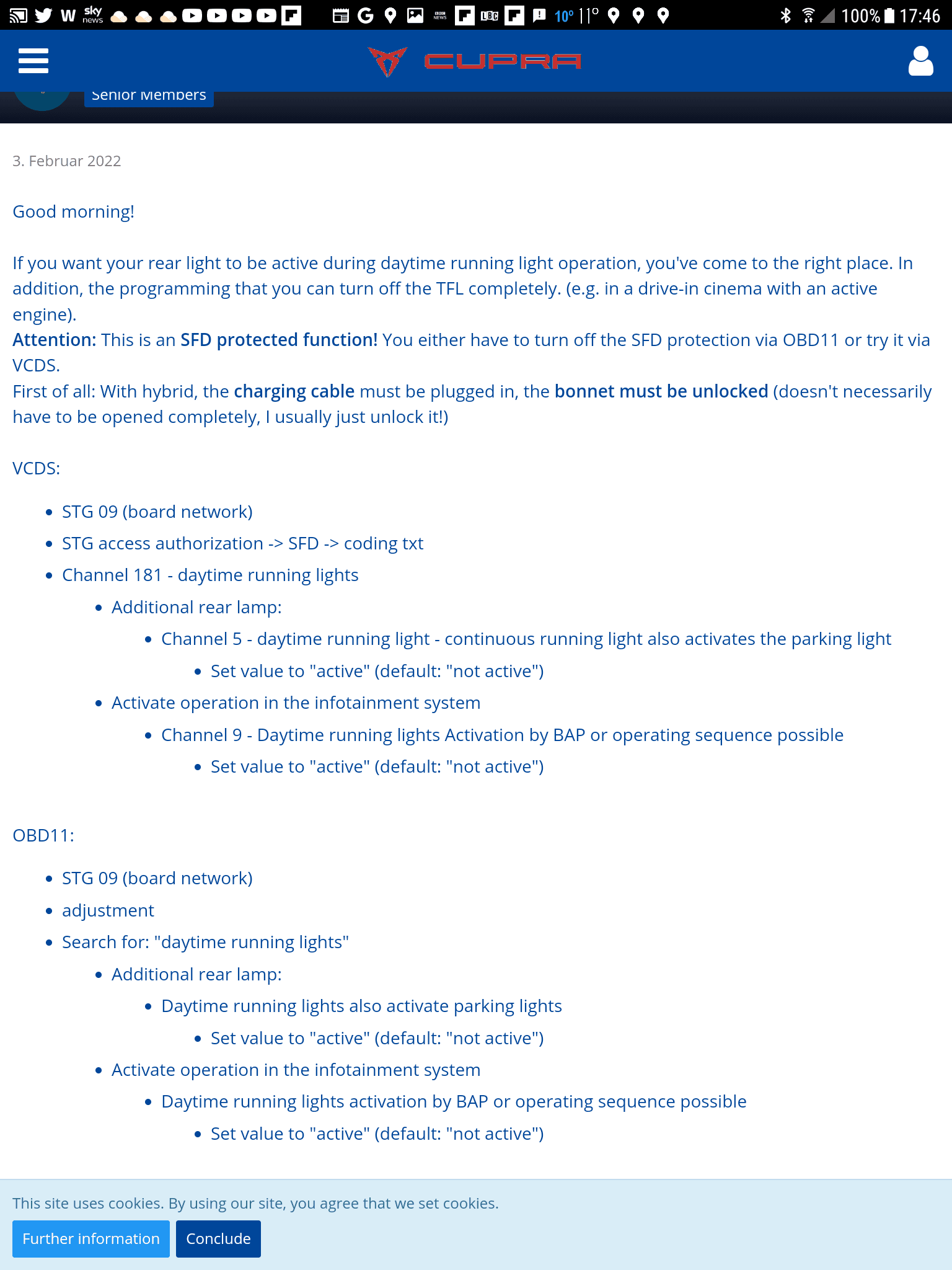

So the original coding that was used (and has been used for some time)
I used the long coding.
Central Electrics 09
Adaptation
Daytime Running Lights
Tagfahrlicht-Dauerfahtlicht aktiviert zusaetzlich standlicht
set to "active"
German Forum says
  • STG 09 (Bordnetz)
  • STG-Zugriffsberechtigung -> SFD -> Coding-Txt
  • Kanal 181 - Tagfahrlicht (Daytine Running Lights)
    • Hecklampe zusätzlich: - in other words Additional rear lamp which I can't see on my MQB Evo maps
      • Kanal 5 - Tagfahrlicht - Dauerfahrlicht aktiviert zusätzlich Standlicht
        • Wert auf "aktiv" setzen (Standard: "nicht aktiv")
  • AND THEN THE MENU ITEM.
    • Bedienung im Infotainment-System aktivieren
      • Kanal 9 - Tagfahrlicht Aktivierung durch BAP oder Bedienfolge möglich
Obviously they also talk about the menu item which we has been around since the MK3 as well but I am guessing this is on off feature.
The big difference is Hecklampe zusätzlich: (Additional rear lamp:) which is an understandable description but on my copy of the OBD11 MQBEvo platform I do not see that description and I also I checked my VCDS Extract and again it does not mention this value.
To be fair both of these are against a Golf / Leon not the Formentor.
So I do think its the same coding
