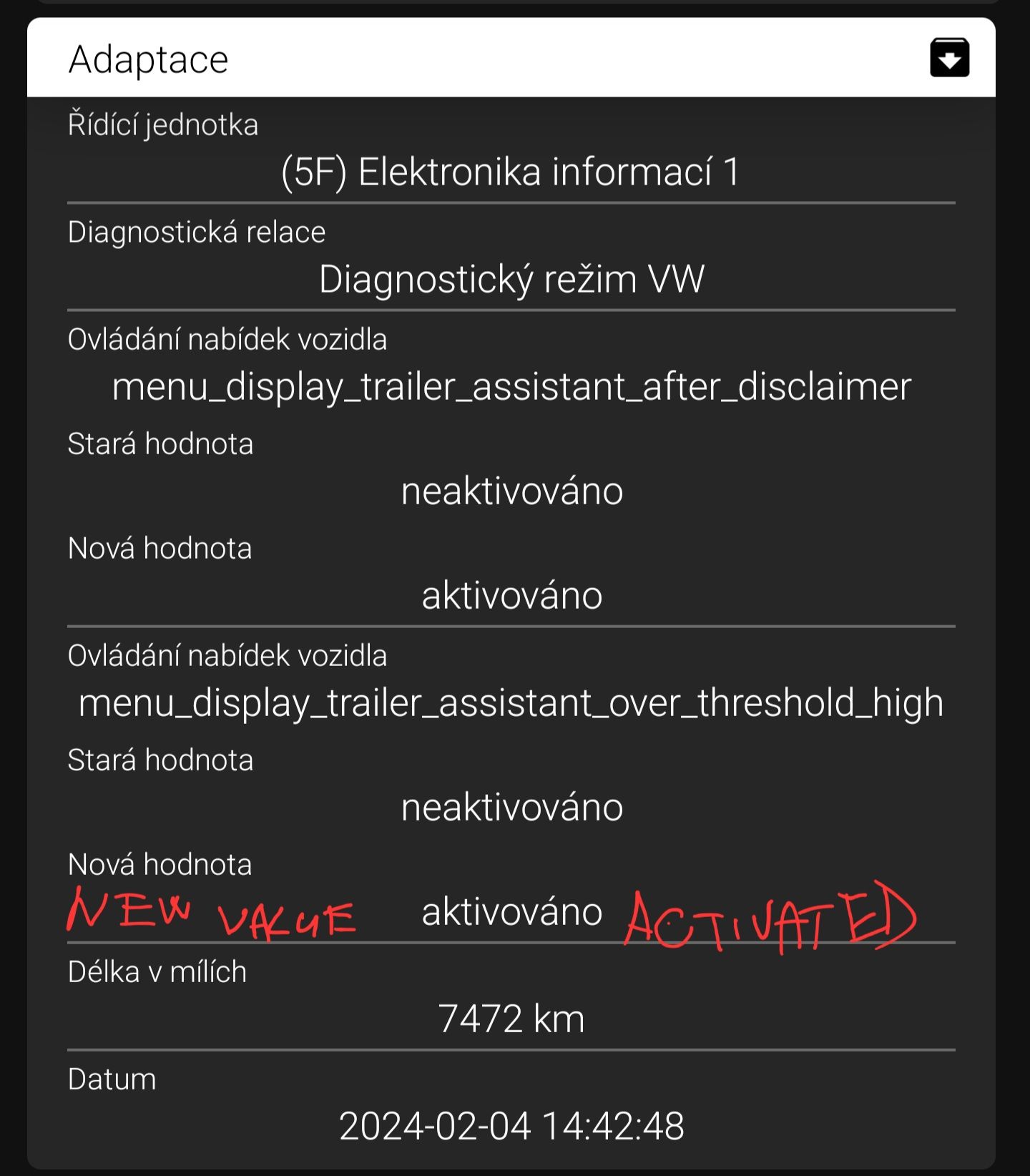

Security access. Re enter the 20103 and then search and this cleared the issue for me being unable to access control unit 13 so hopefully it works for you in 5F

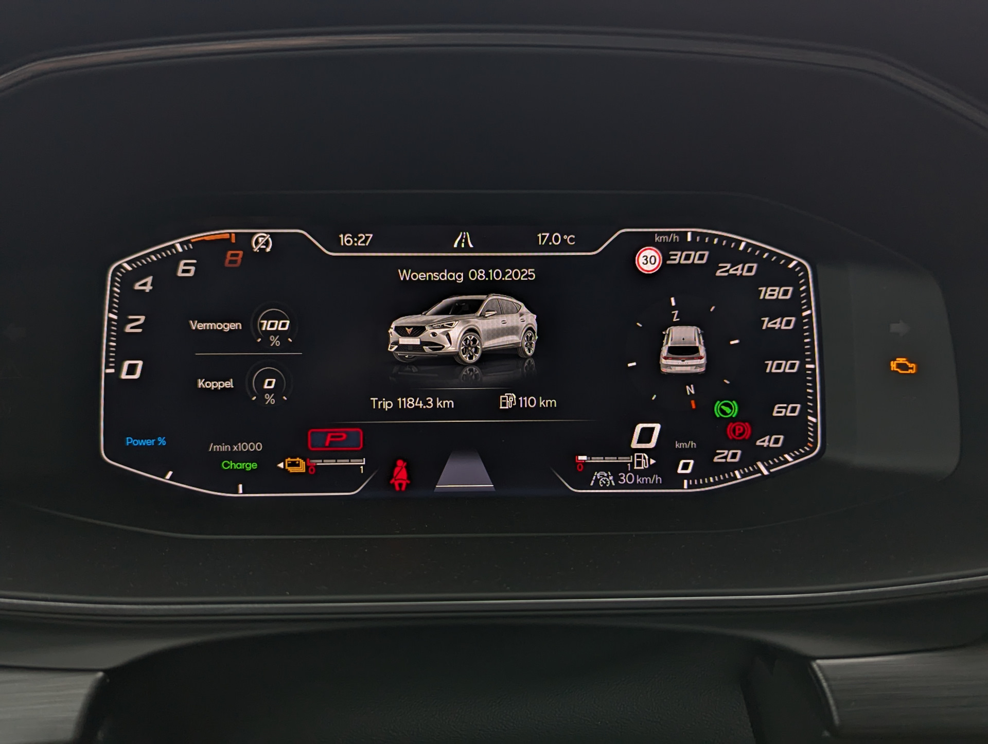

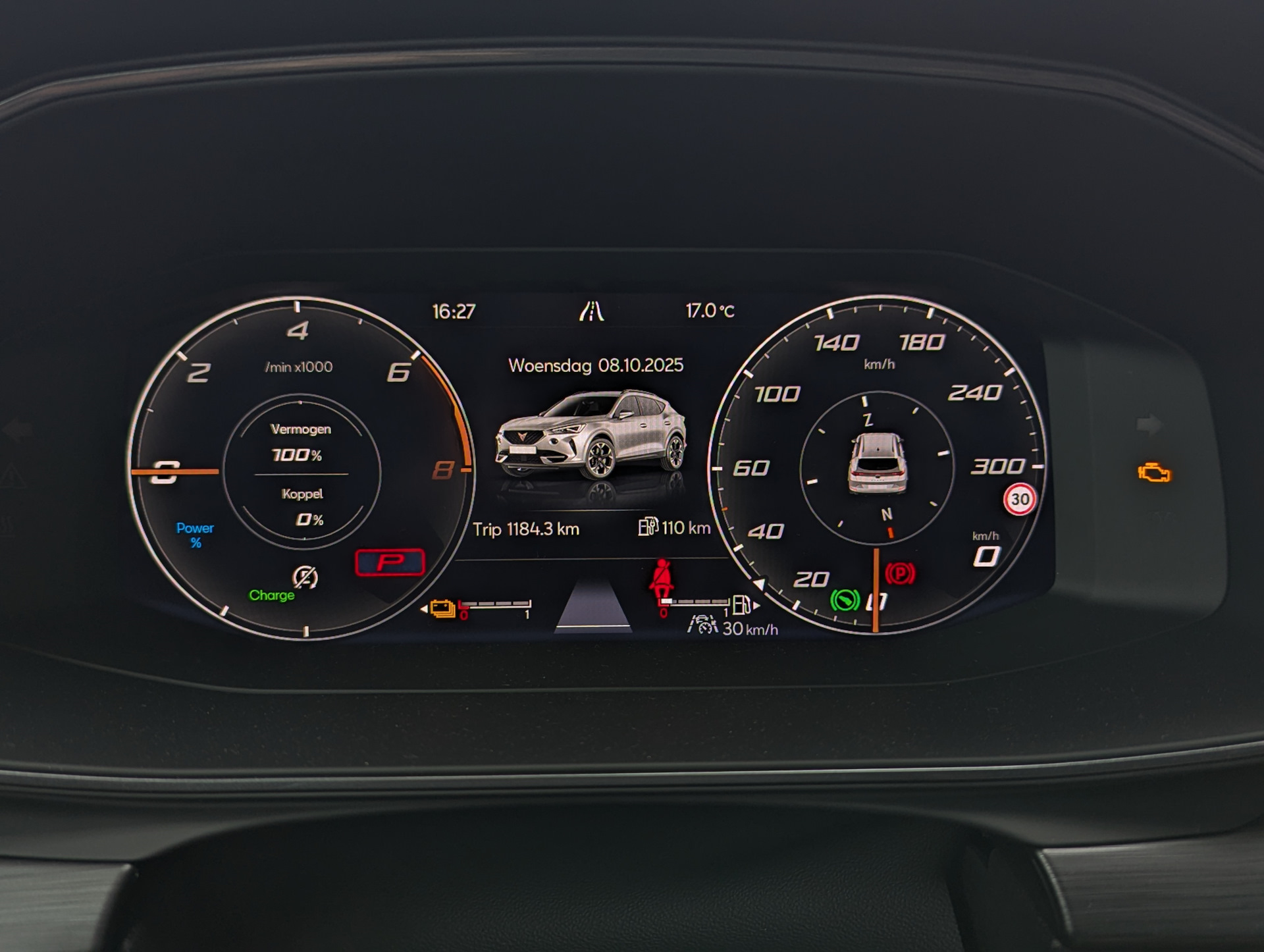

Module 17 — Adaptation:
Tachometer end value
Version
0 0 to 260
1 Doesn't seem to work, breaks some of the tachometers
2 0 to 240
3 0 to 300
All other values don't do anything.

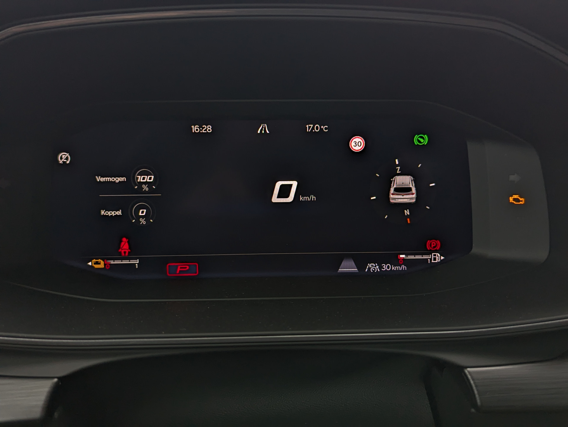

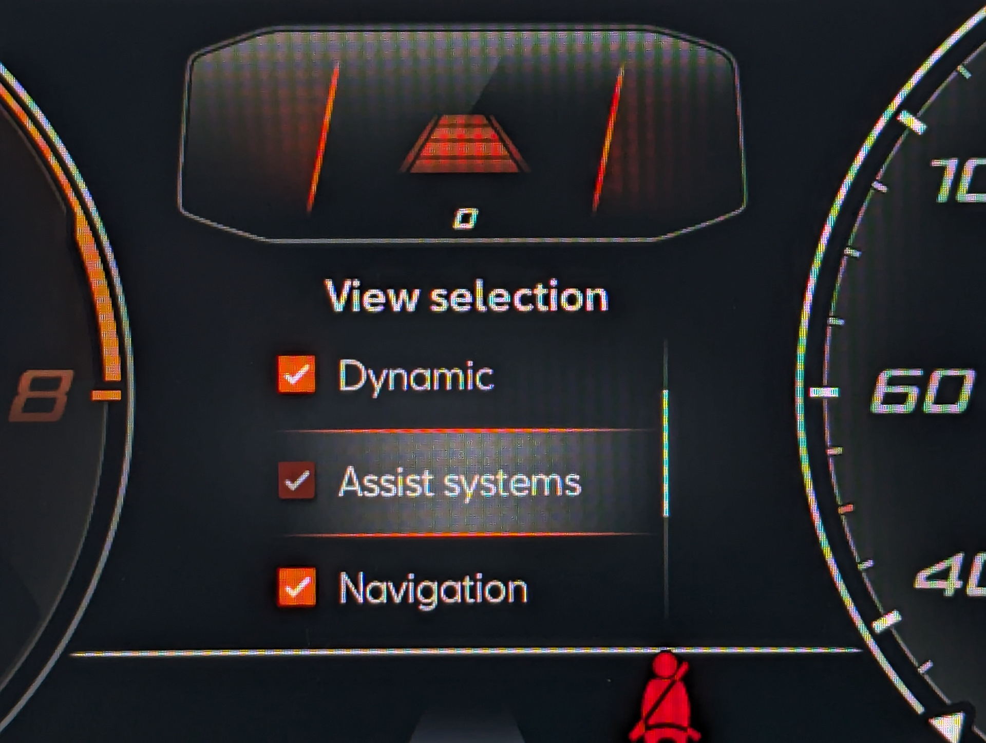

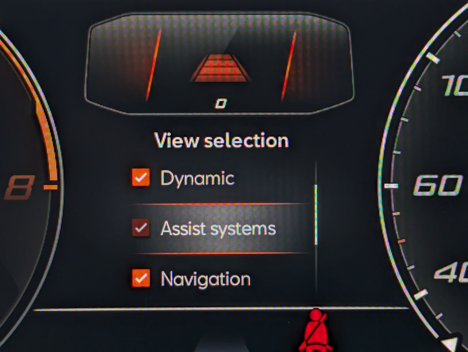

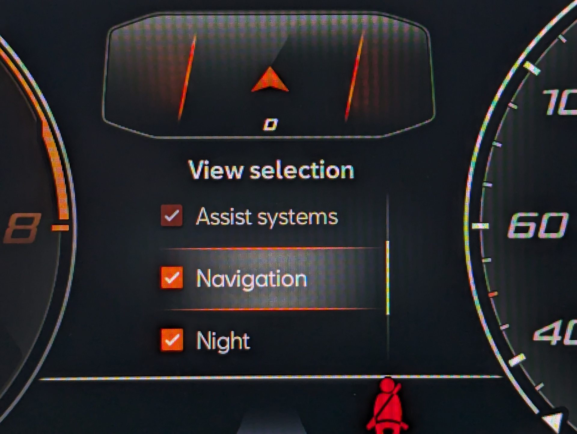

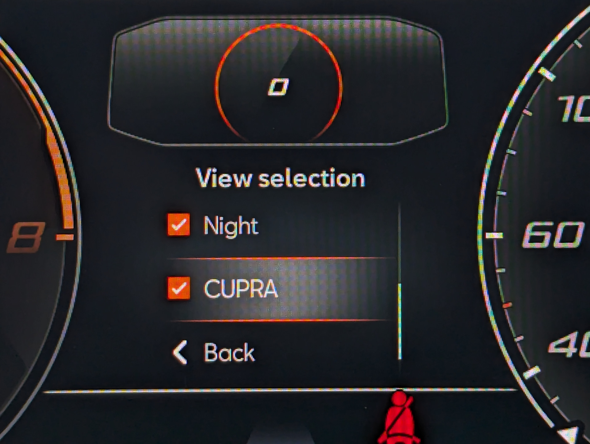

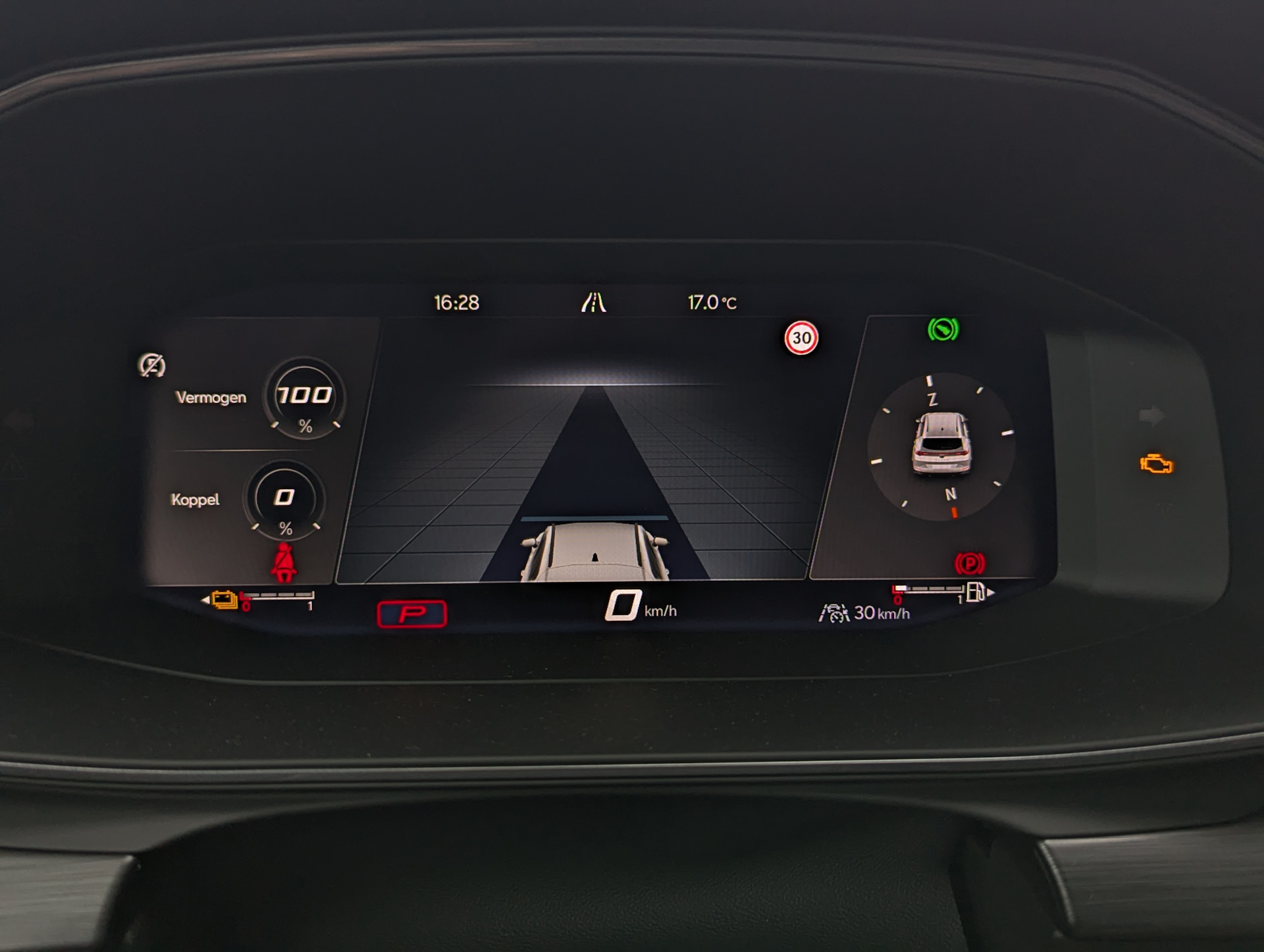

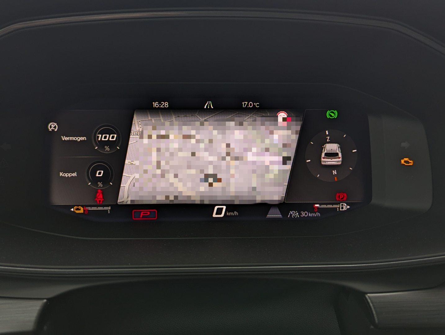

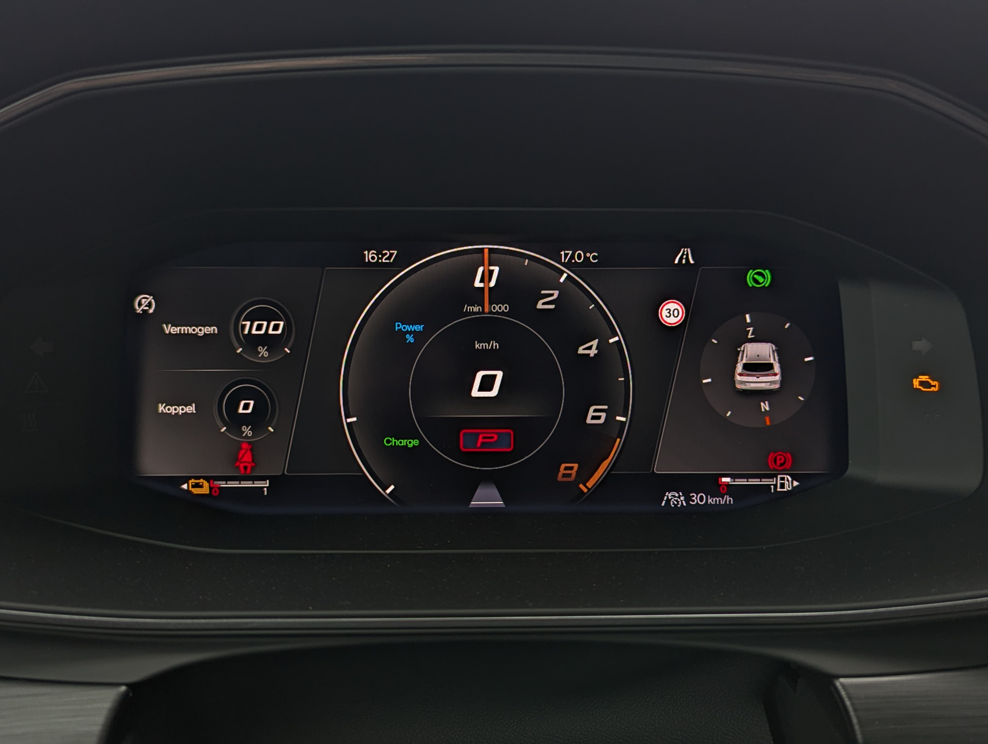

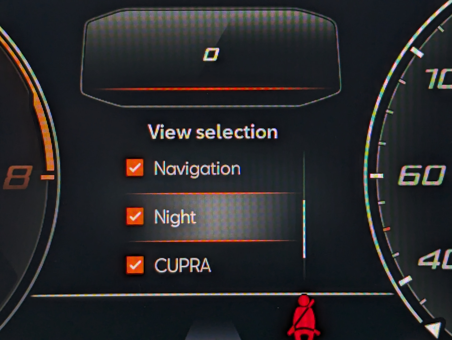

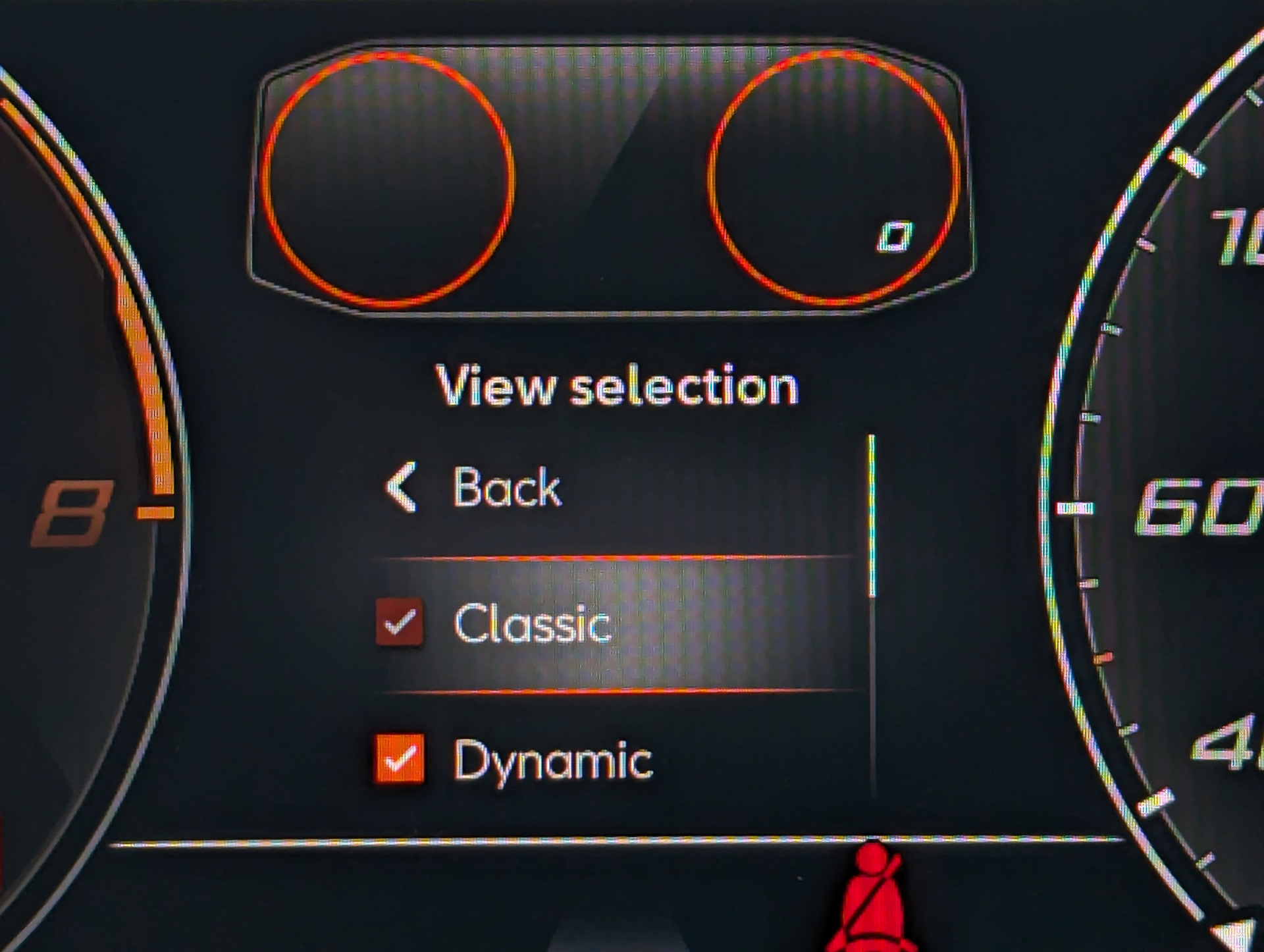

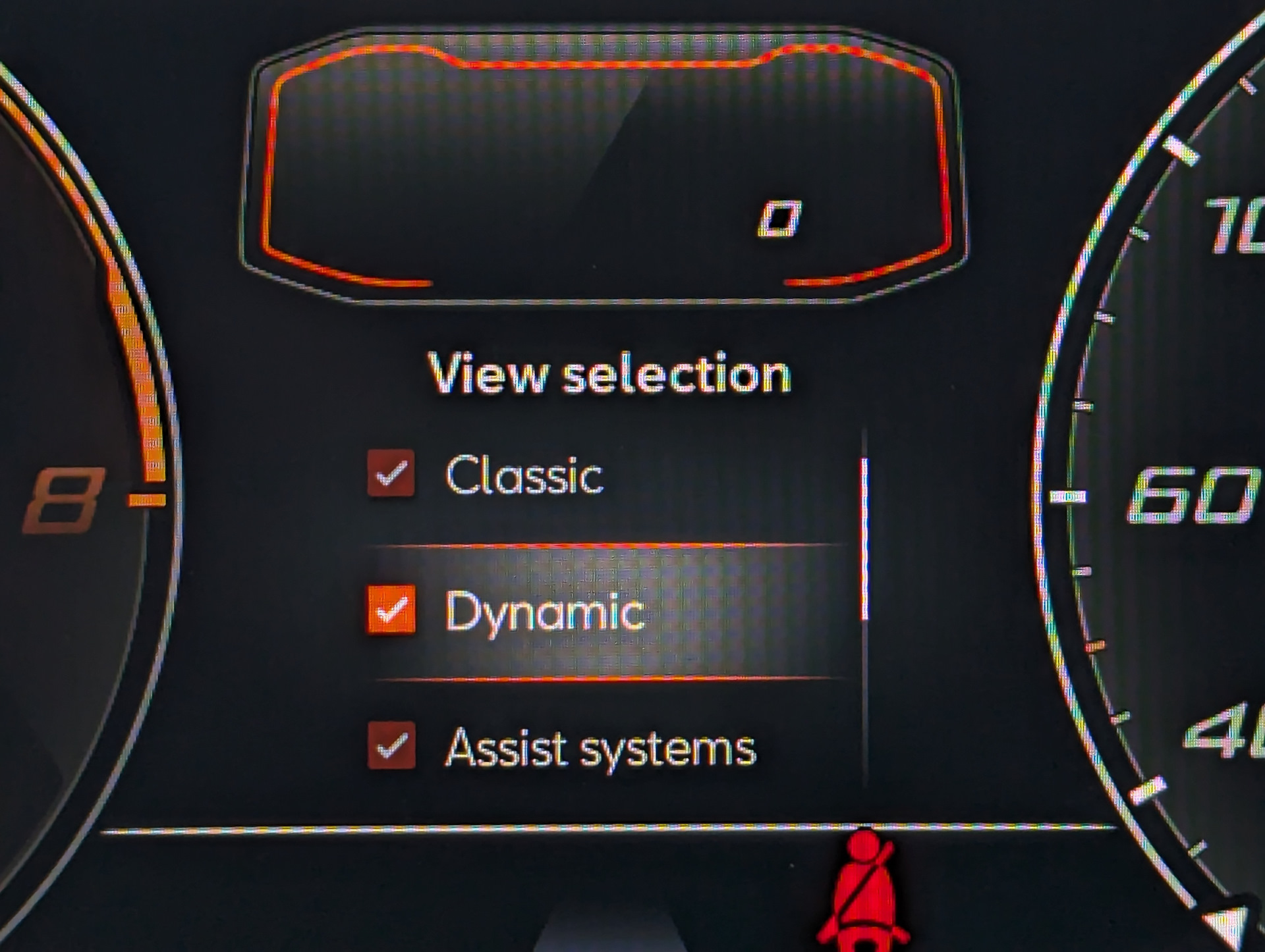

Module 17 Adaptation
View activation
View
1 Classic
Classic View selection — Cupra Formentor VZClassic view — Cupra Formentor VZ
2 Dynamic
Dynamic view selection — Cupra Formentor VZDynamic view — Cupra Formentor VZ
3 Navigation
Navigation view selection — Cupra Formentor VZNavigation view — Cupra Formentor VZ
4 Driver Assist
Driver assistance view selection — Cupra Formentor VZDriver assistance view — Cupra Formentor VZ
5 Night
Night view selection — Cupra Formentor VZNight view — Cupra Formentor VZ
6 None
7 None (on Golf it's the GTE view)
8 Cupra
Cupra view selection — Cupra Formentor VZCupra view — Cupra Formentor VZ
9 None (on Golf it's the R view)
10 None (on Golf it's the Offroad view)
Module 17 — Coding:
Vehicle variant
Derivative
1 Seat Leon MK4
2 Seat Leon MK4 ST
3 Seat Ibiza
4 Cupra Leon MK4
5 Cupra Formentor
6 Cupra Leon Mk4 ST
7 Cupra Formentor (with higher redline display. Thx Matteo for the feedback)

Can you tell what these modifications actally do? Formentor should have all these views by default...
View activation
View activation
They are not enabled by default on all Formentors. Mine didn't have Night and Assist Systems.
The images speak for themselves, I guess. They are just different layouts.
