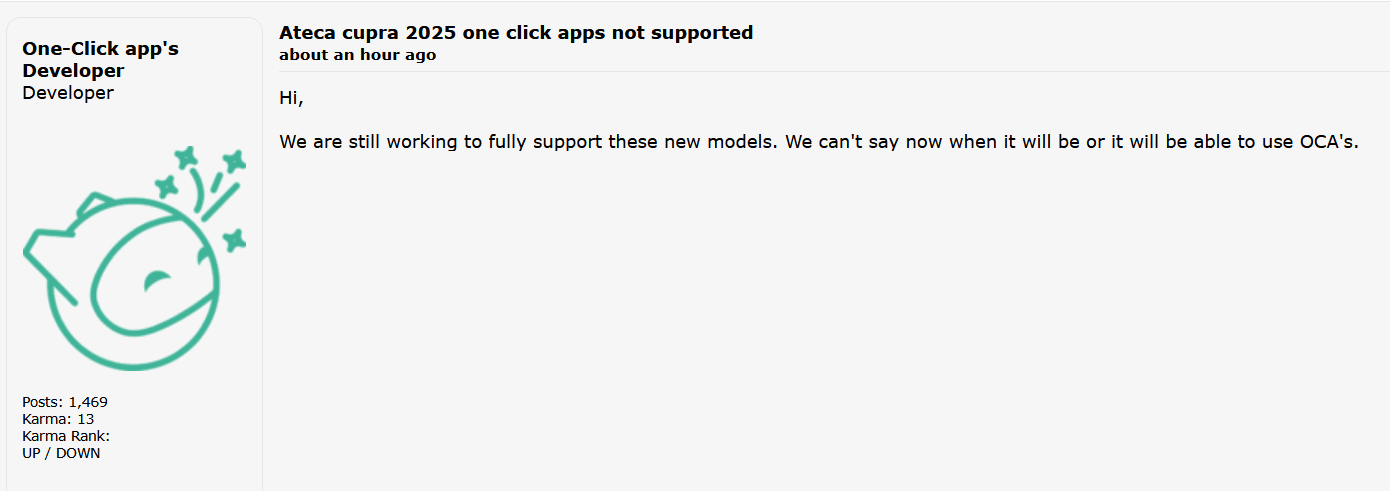

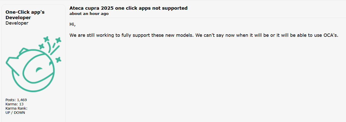

I would stress I am an OBD11 Fan and I hope they (I suspect its VAG rather than OBD11) get it fixed but saw this today.
The latter I guess are what the crowd sourcing disciples are seeing. The guys that write apps by paying extra to do that, that may not get properly tested on the specific car and lead to problems... are locked out of development at the minute. That's my reading of that. Well any sensible person should code it rather one click. So they have been parked until SFD2 is sorted on Obdeleven. Obviously business as usual on all models till 2024 with SFD2 on it.
I agree you should do your research and code manually but what supprised me this morning was this on the OBD Site
