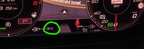

Hello,
I own a Formentor VZ 245 E-Hybrid, new to this forum , i am familiar with VCDS as i work always with VAG Cars , i have read all 26 pages here in forum , thanks to all members for the infos .
I have alreay enable :
1) Easy entry (drivers seat go back when you want to enter the car or when you want to leave the car etc)
2) Fuel tank liters
3)Soundaktor at lower level
But i can't found anywhere some of the below
1)when you unlock if the seat is at different memory position to go back to the key-matched position
2)i have seen at a lot of hybrid owners that at the battery status bar they have enable the % how can i activate this?

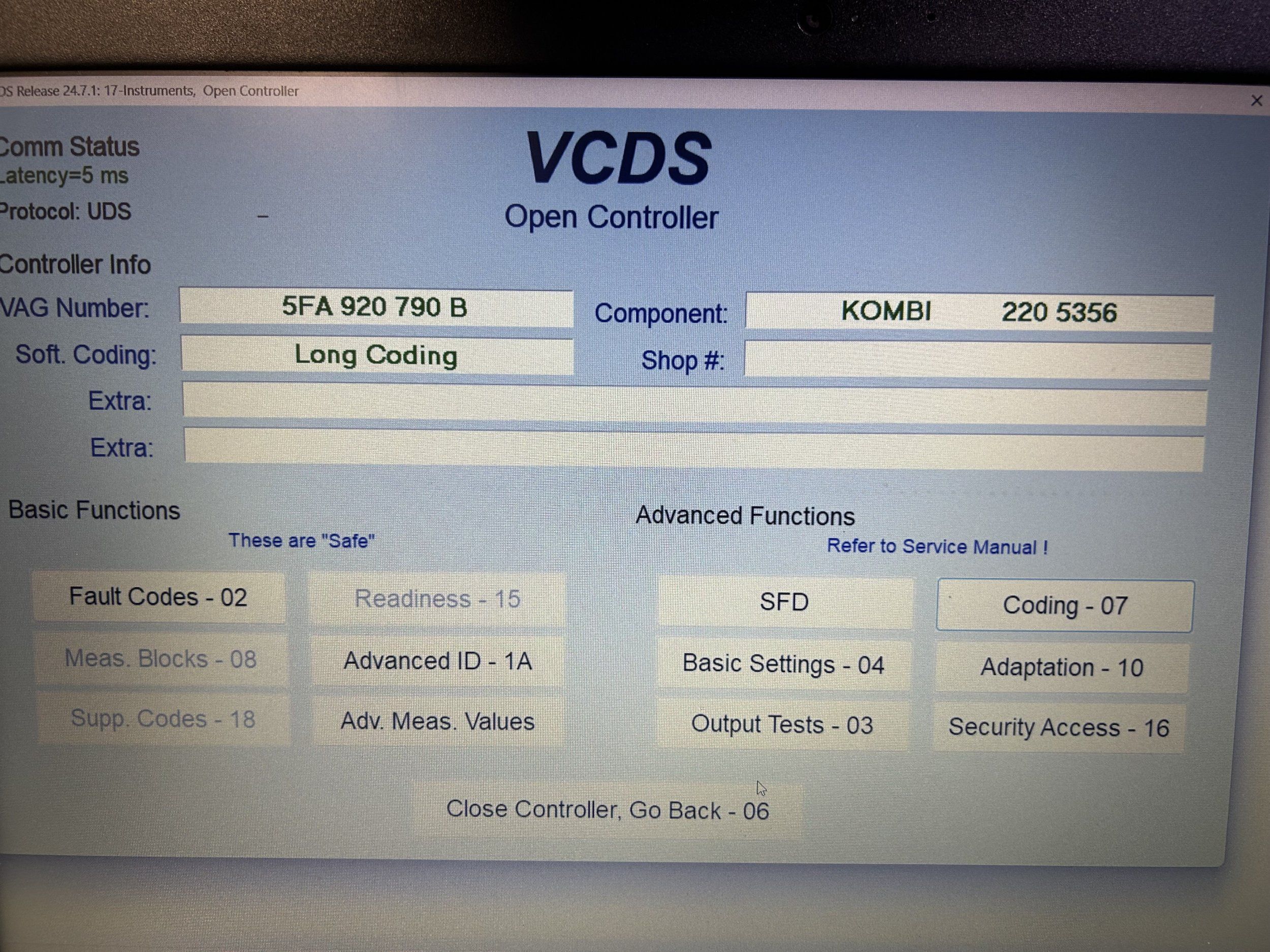

Need help with OBD11 PRO long coding, I am trying some modifications according list of German author, but can not understand what to do when it says byte 3 -> activate byte 6 (for easy entry). I can not see anything relating to this undr STG36?
This also refers to other modifications, when it says byte X -> byte Y...what does it mean?

That refers to long coding
In the Pro you got the 0-1 slider that takes you into the string editor if that helps. You move across etc. One has text on it the other is the editor. I have taken in the past VCDS stuff and converted it into Obdeleven... hex stuff. That was on the Ateca Cupra thread on why the mib2 standard on Ateca Cupras didn't have the Cupra image on them. I then made my Standard Ateca into a Cupra with the Cupra splash screen... on my high unit. Seem to recall I used hex tables if someone gives you VCDS stuff it's possible to do the conversion. Bottom line on the mib2 standard was it didn't have the Ateca Cupra car images in it, the high did... in case you hit this on a Google.
Haven't got the Formentor but pass on the rest. On sound I guess you got a menu to setting to turn auto volume off. That compensates for road noise. Audiophile thing to do in anycase. Then you probably got a other menu setting also to do what you want.
The 0-1 slider
And taking VCDS output into the long string Obdeleven input
That's an example of taking one and using it in the other.
