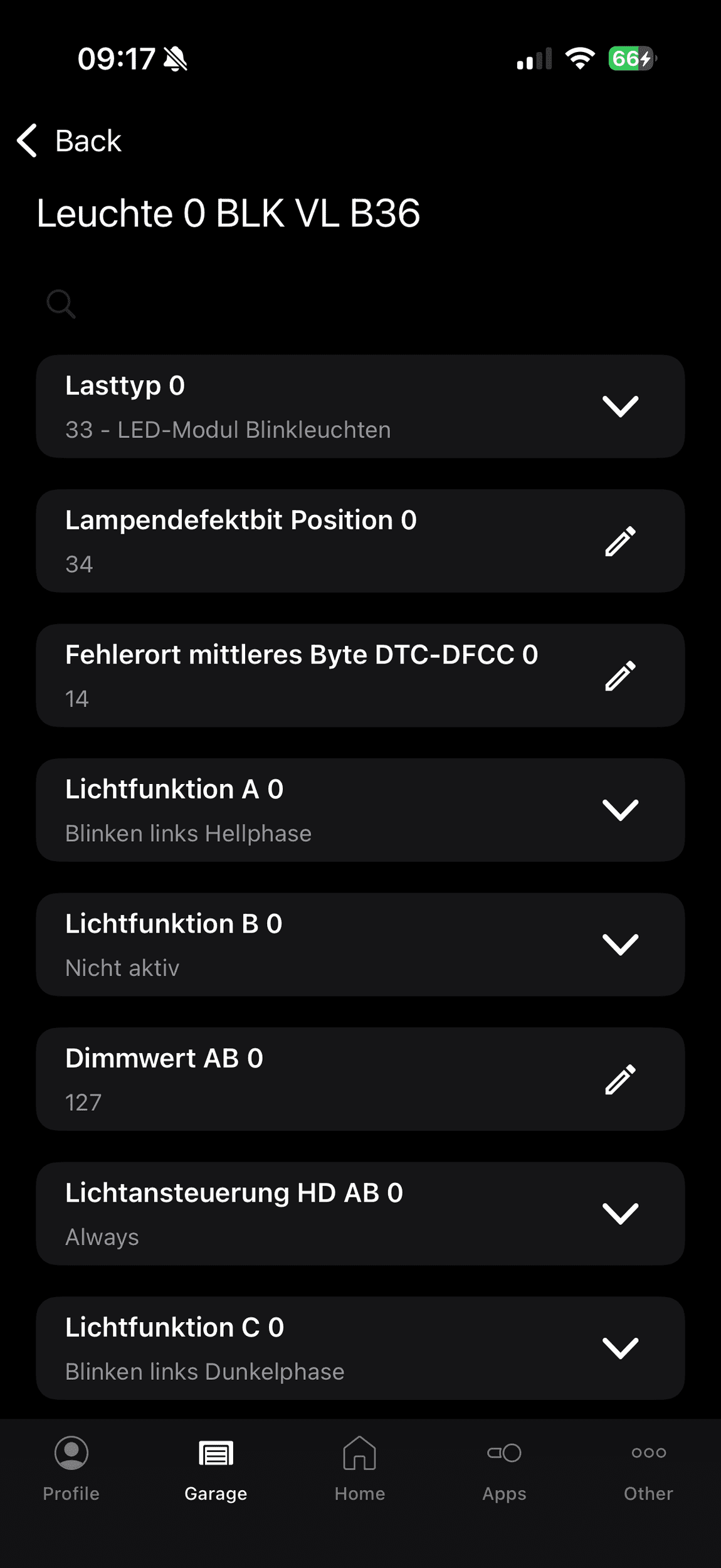

So I’ve been messing with an OBDEleven and stupidly just realised when I indicate left now, both FRONT indicators flash. I have no idea how I’ve done this and I’ve even tried to look through leuchte0 but still no luck. Any help would be greatly appreciated

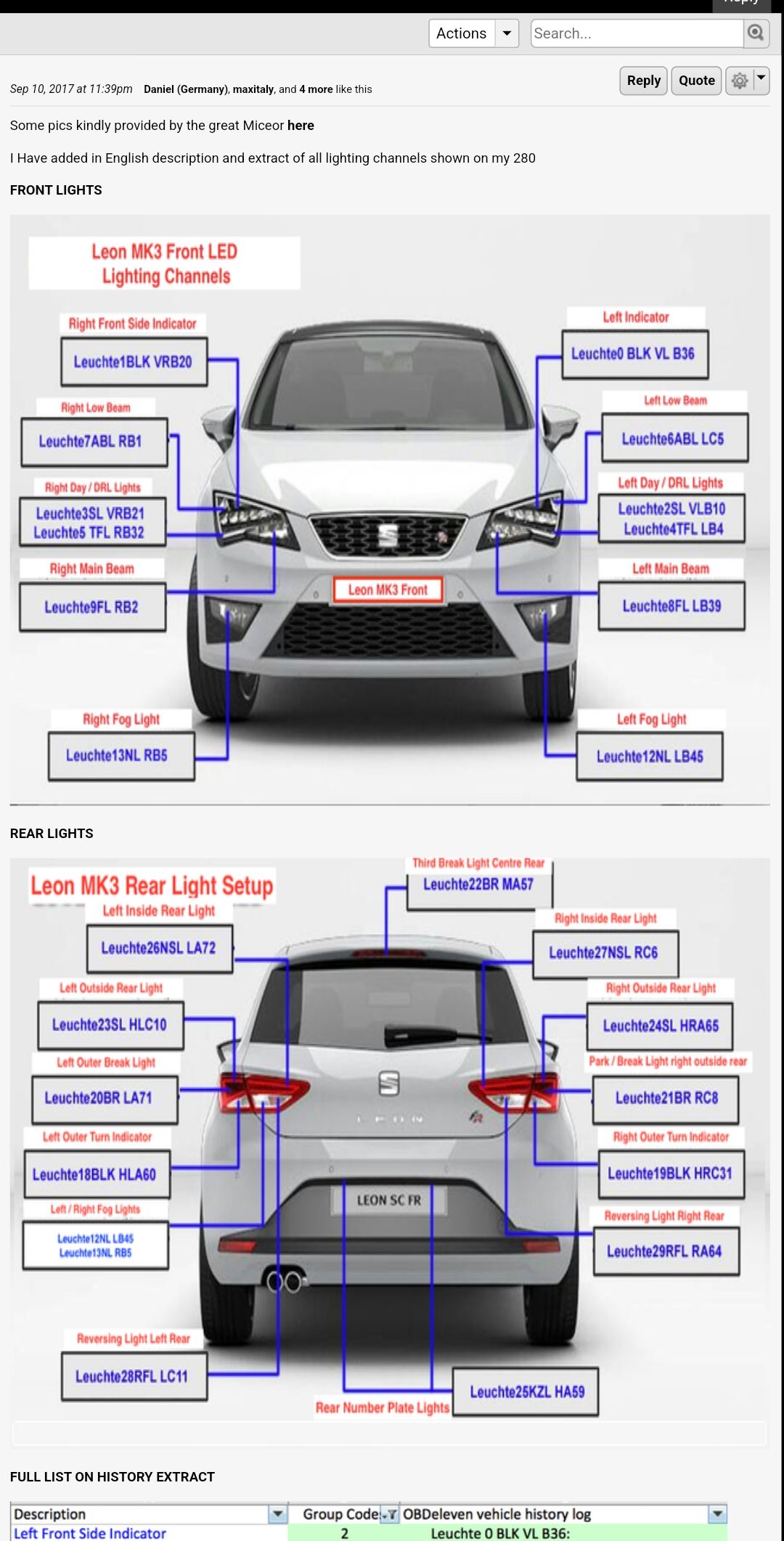

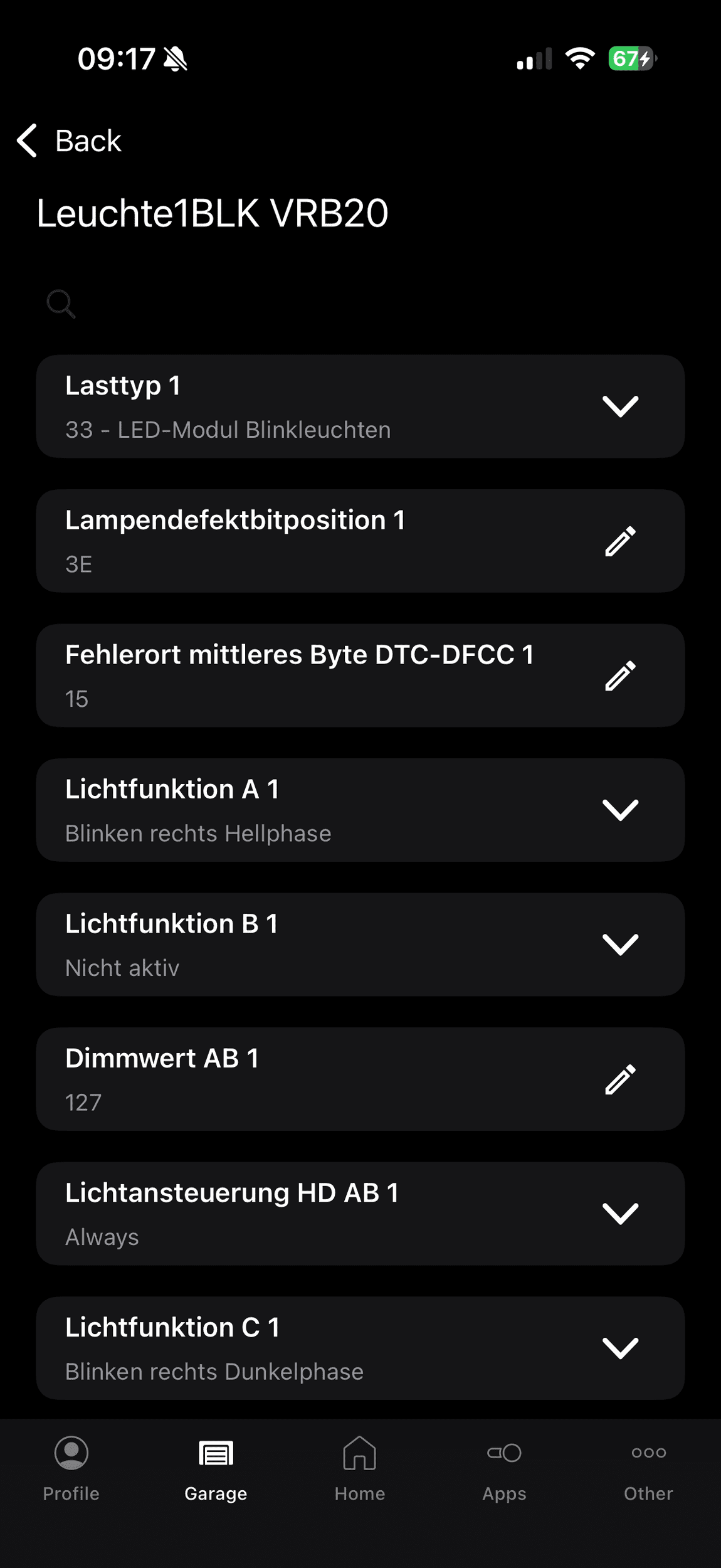

Leuchte 1 is your right indicator and Leuchte 0 is your left. "links" in german is left and "rechts" is right in german. So i would check Leuchte 1 your right indicator to see if you have one of the settings with "links", then just set it to "rechts"
Hi, thanks for the helpful response! I did check these to be fair but no they are respectively correct. I checked just and I don’t think when I signal right that my front right bulb even flashes, it’s only when I indicate left that both front bulbs appear. So that’s an issue
So check Leuchte 0, light_function_a_0 should be blinkenlinksaktiv. Leuchte1BLK should have light_function_a_1 blinkenrechtaktiv.
If those are right, I have no clue whats wrong, you could make a back up file of central electrics and post it and maybe some can go threw it. If not im afraid you will have to check the history.
When I messed with Leuchte to get hellphase on my ibiza, I noticed that changes to the rear turn signal had some weird effect to the front. I have no clue why, but I had to change the rear to hellphase for the front to work.
I’m pretty sure this is default, is there anyway to recover an old backup? I’ve even tried my original long code but issue still about so it’s defo an adaptation

Firstly follow @Jokke suggestion but for you info if you have done a backup (you instigate this its not automatic) then yes its in your history file.
Just set the filter to Backup (there are two, one for a specific control unit and the other for all control units), you can then email it to yourself and read the settings as they were before you made changes
Also if your tried to enable hellphase blinking (indicator blinking and drl off) , I belive you would have to change the tagfahtlichtmodulsignal in Leuchte 2 and Leuchte 3. Check those as well.
