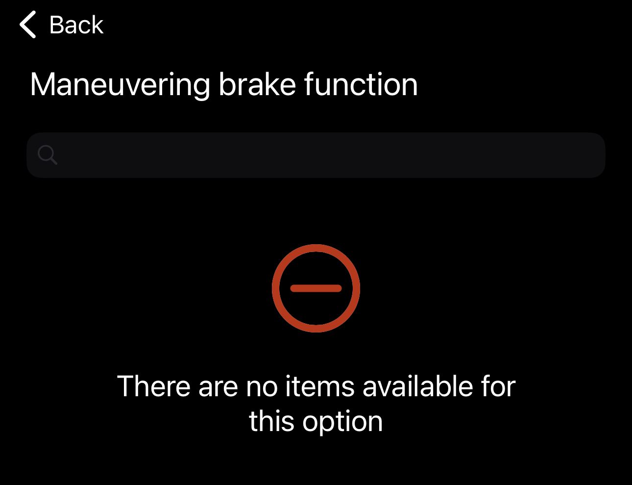

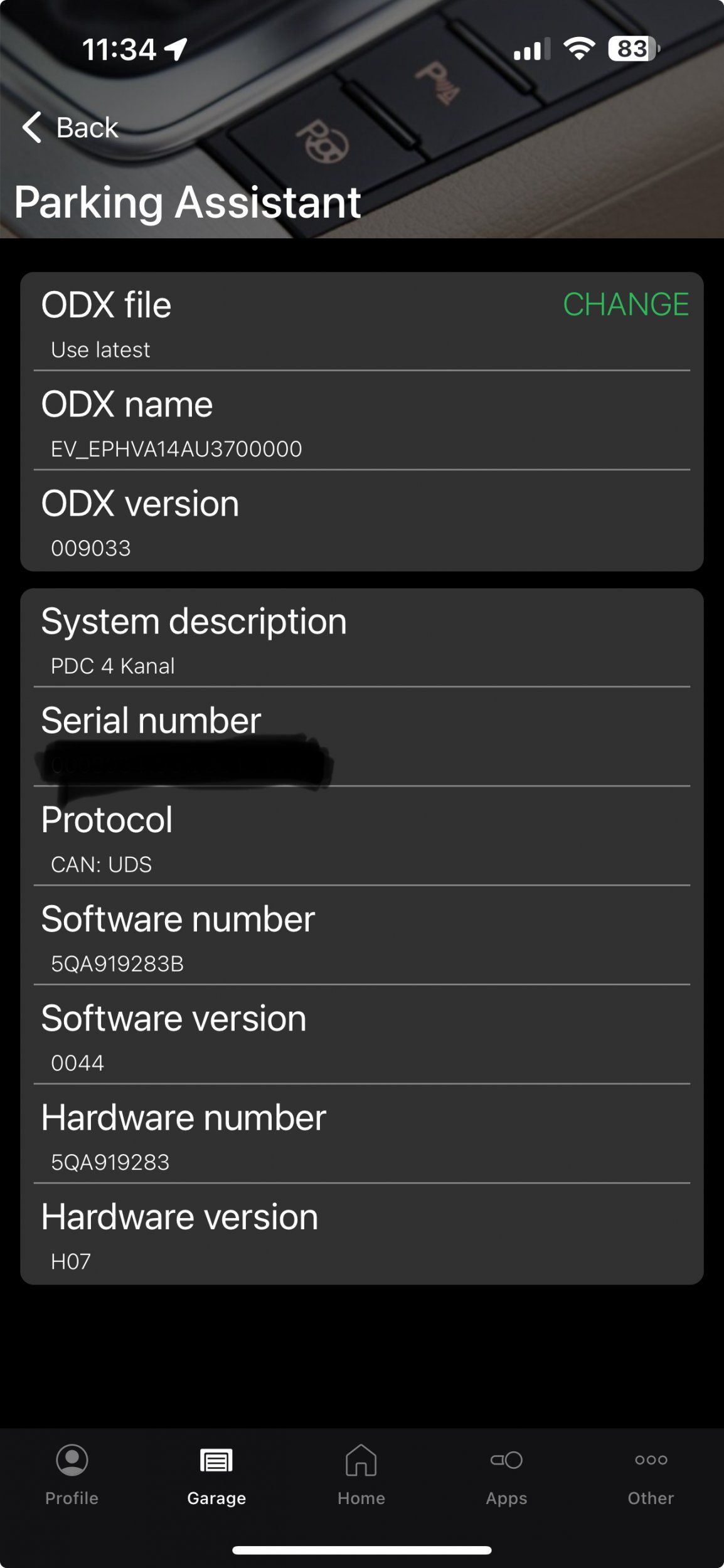

Hoping someone can help - I’m trying to activate “Activate braking in maneuver”, which according to all the guides says;
* Applicable from MY17 * 5QA control units onwards.
1 - Module 03 - Brake electronics - Code (40168/20103)
2 - Long Coding(Byte mode)
3 - Byte 24 - (Activate bit 5)
1 - Module 17 - Instrument panel - Code (25327)
2 - Extended encoding (Byte mode)
3 - Byte 13 - (Activate bit 0)
1 - Module 76
2 - Adaptation
3 - Braking function during manoeuvre - (Change value to Activated)
I’ve made the changes in Module 3 and 17, but when I go to module 76 I see the option for braking function during manoeuvre, but OBDeleven just says no items available?
My car is a 2018 facelift, and according to OBDeleven has a 5QA control unit?
Have I missed a setting somewhere? Or do I somehow not have the required hardware? I’ve OPC enabled, full rear parking sensors and the right hardware version (5QA)?
Have you tried doing it with an Android Phone as I have seen these sorts of issues with iOS Before.
There are two different 5QA hardware versions with two revisions for each, so 4 variants total. Not sure all 5QA units are capable of this feature. Even if they are, this may be something to do with speed sensors. I remember that I read somewhere that the speed sensors should be the ones that support this feature.
As far as I know, this only works with the 8-channel PDC control unit (5QA919294 and PLA. Units)and at least SW version 0044. The corresponding data set is of course also available on the control unit. Coding would only be necessary in control unit 03&17
I also retrofitted it myself. Flashed the control unit to index B, flashed the data set, encoded control unit 03&17 and then the entry came in the 5F
