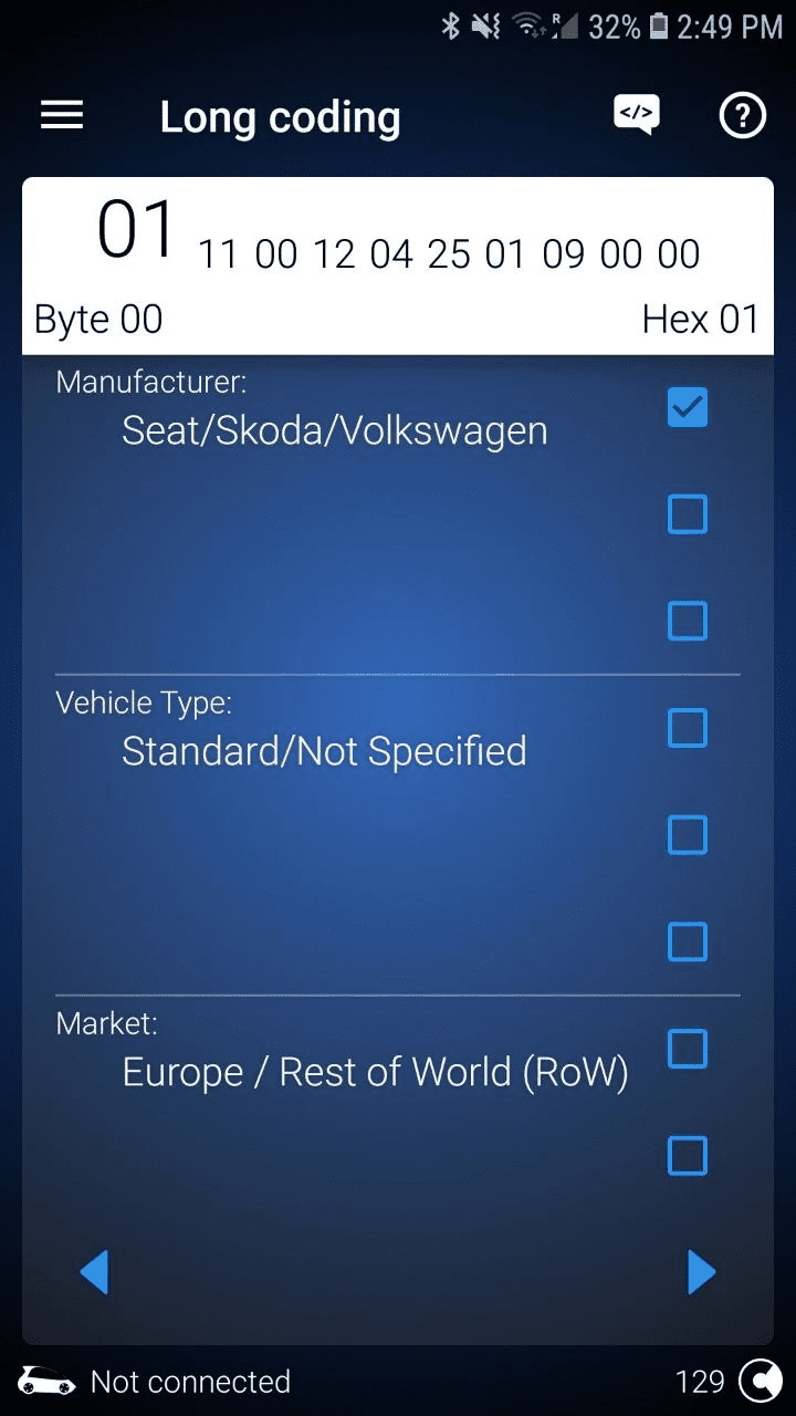

I need some guidance: yesterday, among other things, I coded an Audi throttle mod via OBD11. You know, engine, long coding, change one of the first bits from 01 I think to Audi. It seemed to work, got better throttle response but my cruise control stopped working (yellow warning light in it's place).
Now from what I read on this and other forums, cruise control problems with this mod were present only in facelifted Leons or those with adaptive cruise control. My Leon is MY 2016 and has classic cruise control only, did I do something wrong? Do I need to code something additional after enabling Audi mod?
For now I reverted back to what was before and cruise control is working but I lost the throttle response obviously.

Which byte and bits did you change, what were their previous values and the new values you entered?
I could choose between some number, like 01/011, Seat/Skoda/VW and Audi. By default I had the number, I changed to Audi and then back to the default number.
Photo from the internet but it looked the same, I changed only manufacturer:
A friend of mine did this exact change on his '14 VW Golf and he lost cruise control too. (Classic CC, not Adaptive). He eventually had to change that back because he was actively using CC.

Yea I did this one also, I've read mixed opinions on if it changes anything, I don't feel much but guess it won't hurt to have this on.
With Audi mod the effect was really noticeable, but well I also use cruise control a lot so had to revert back.
