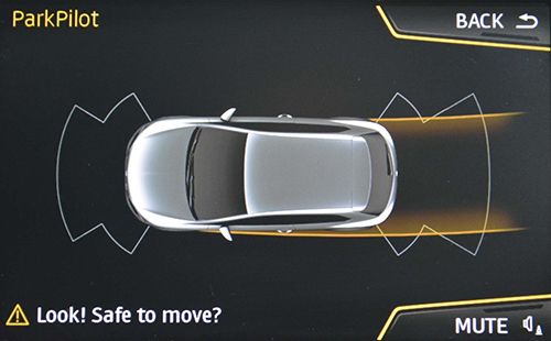

I have enabled optical parking assistant on my facelift FR which only has rear parking sensors and now have the graphical display on the screen to show how close to an object and was wondering is there a way to also enable the yellow left/right lines showing when the wheels are turning?

What I meant was on the prefacelift FR or maybe the facelift ones as well, there is two yellow lines showing where the back direction is pointing

Hi my lad has just purchased a 2018 Seat Leon FR with rear parking sensors but no on screen display. After a quick look on here it looks like i can program the rear parking sensors to appear on the screen in the car.
In simple terms can any help with what I need to purchase , its looks like I will need a OBD eleven scan tool there are 3 different versions listed on Amazon starting at £49.99 can any advise what 1 I require.
Also do I need to purchase anything else at all ?
